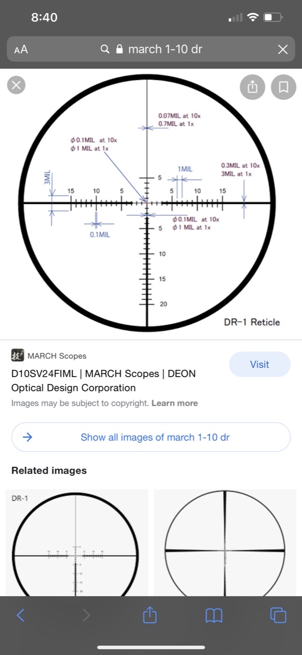

The March 1-10 dr reticle is what I always wanted in an lpvo. 1-10 with an exposed elevation turret and capped windage. Marchs reticle in concept is excellent, just needs to be more refined and one with wind dots offered for the guys that like that kind of thing.
Horizontal and vertical crosshairs needs to be thin like the top half of the vertical and the subtensions also need to be thiner and shorter. Max 5-8 mils for wind and 10 mils for elevation. Other than that it’s perfect.

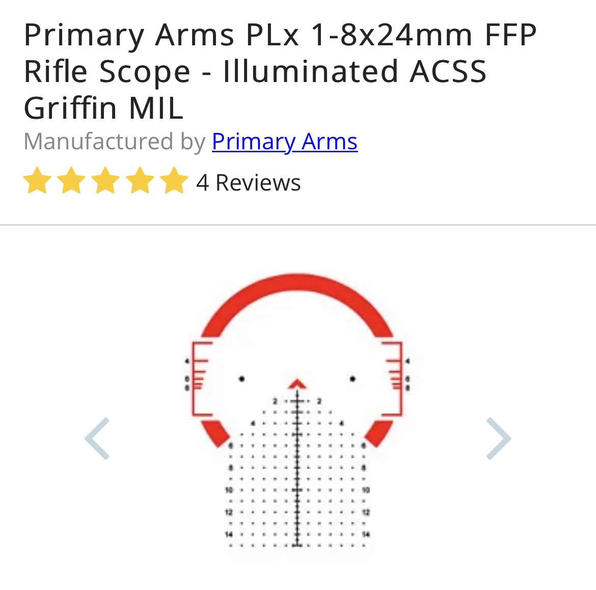

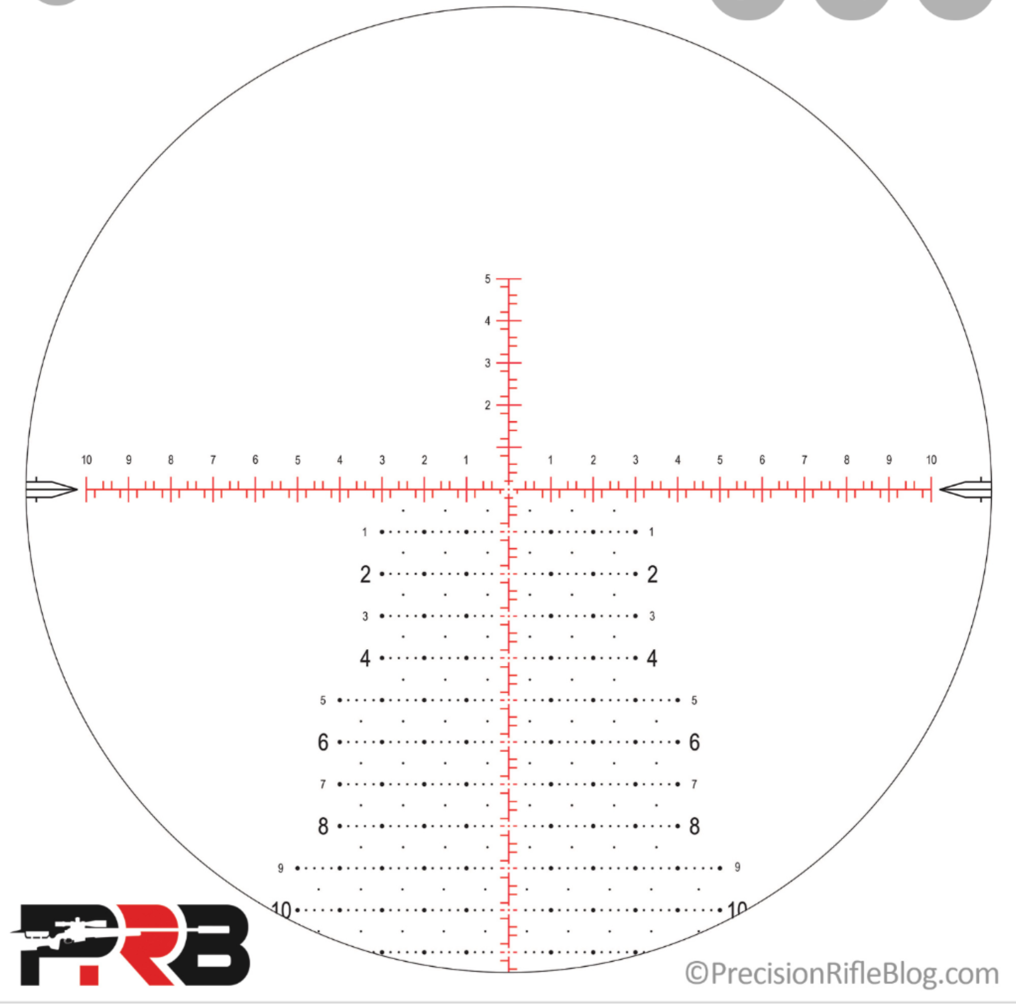

I would want FFP, with eotech's 65 moa disappearing ring overlaid onto a thinner atacr-ish reticle, but with a multi-caliber acog-esque 0-600m BDC (but still with clear whole/half mil subtensions) and tremor style small small wind dots, lined up at the BDC's subtensions every 100m
Also would want bigger objective (I'd be happy with 32 through 44mm), adjustable parallax, and zerohold or schmidt style locking turret. I'd pay like 5k for this list of features in a 1-10x.

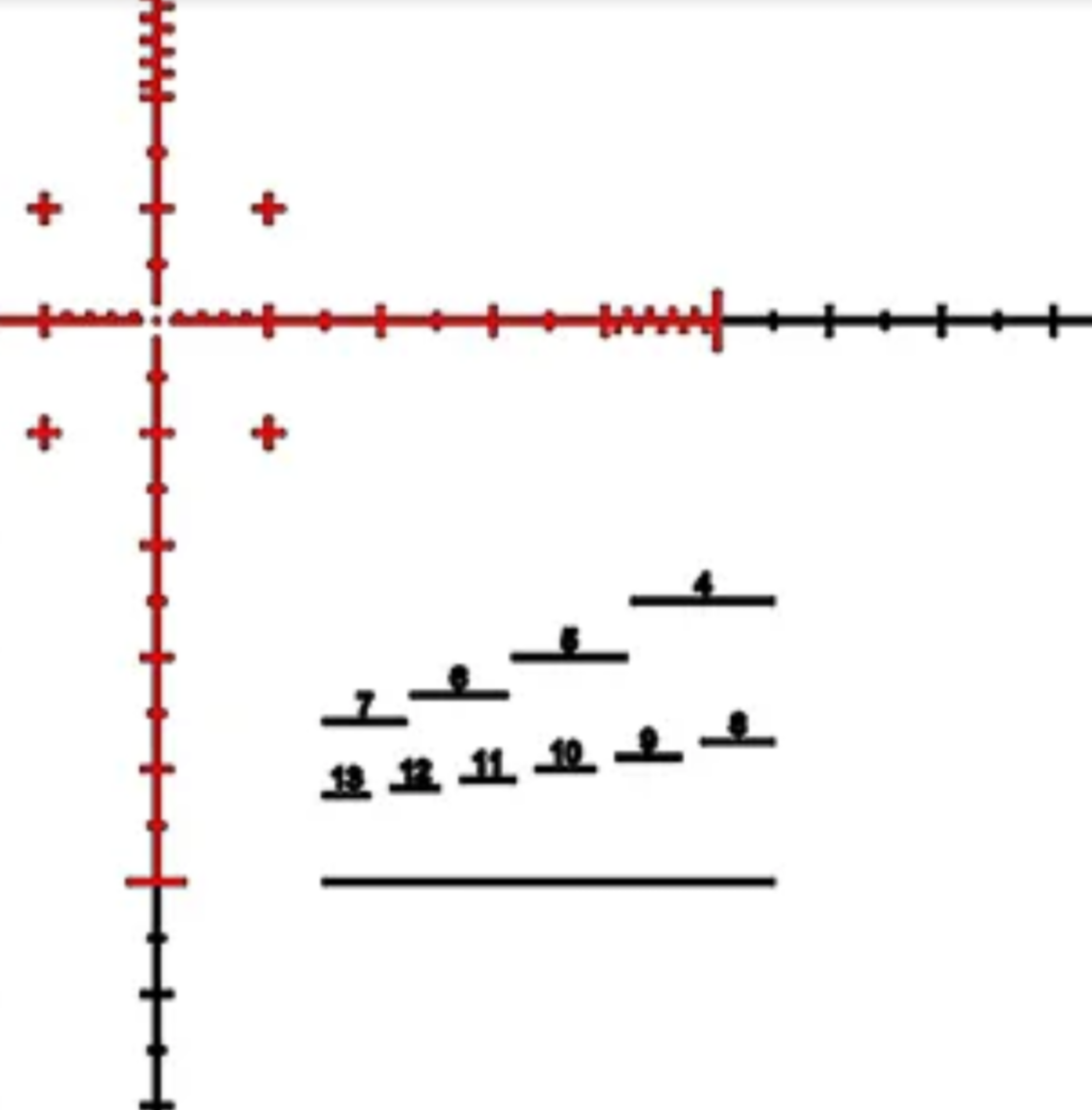

A combination of these features :
- NF Mil-XT (calibrated for the 1-10x- slightly thicker for speed)
- MSR2 Quick Ranging feature (up high at the 12 o'clock - just don't block upper FOV)
- Daylight bright center dot (floating dot)
- Dual Focal plane.
* A non sensitive parallax control.
- 32 to 40mm objective (allows for an ARD)
Reactions: charnicus
