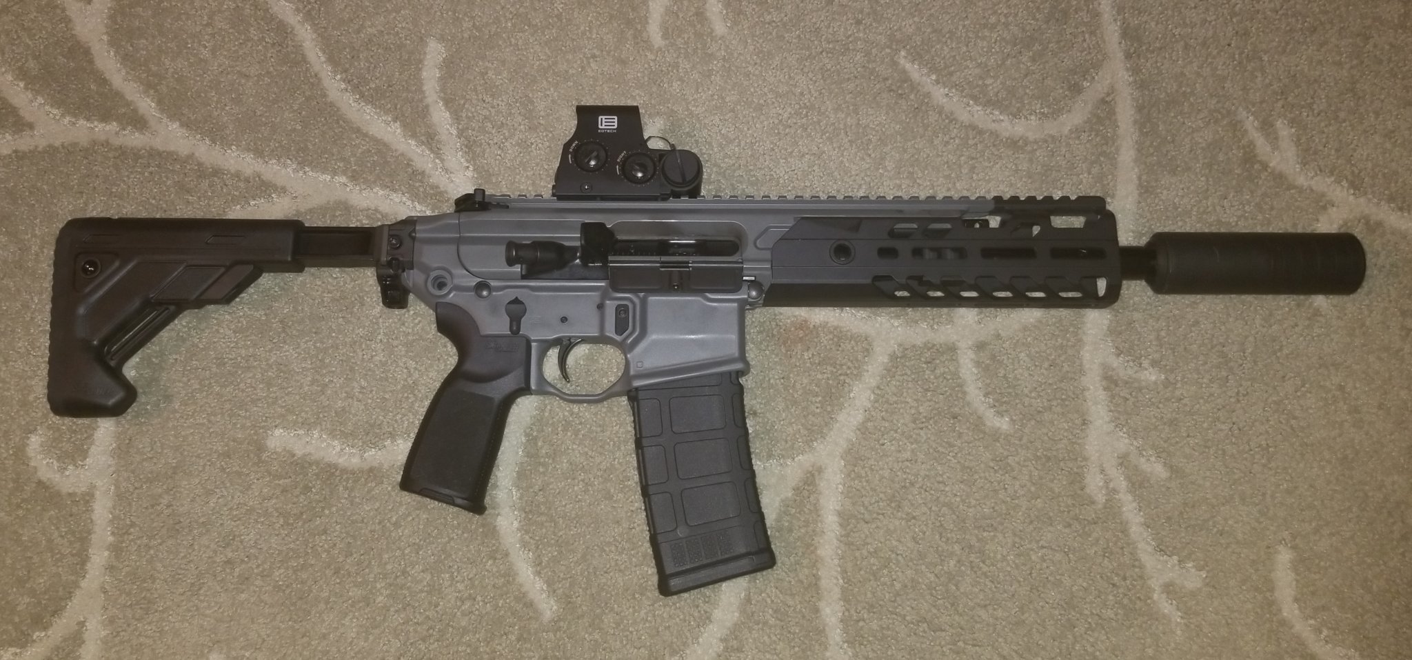

Sig Virtus piston in 300BLK. I only run it suppressed and I never clean it. Folds up nice and small. QD 3-lug can mount.

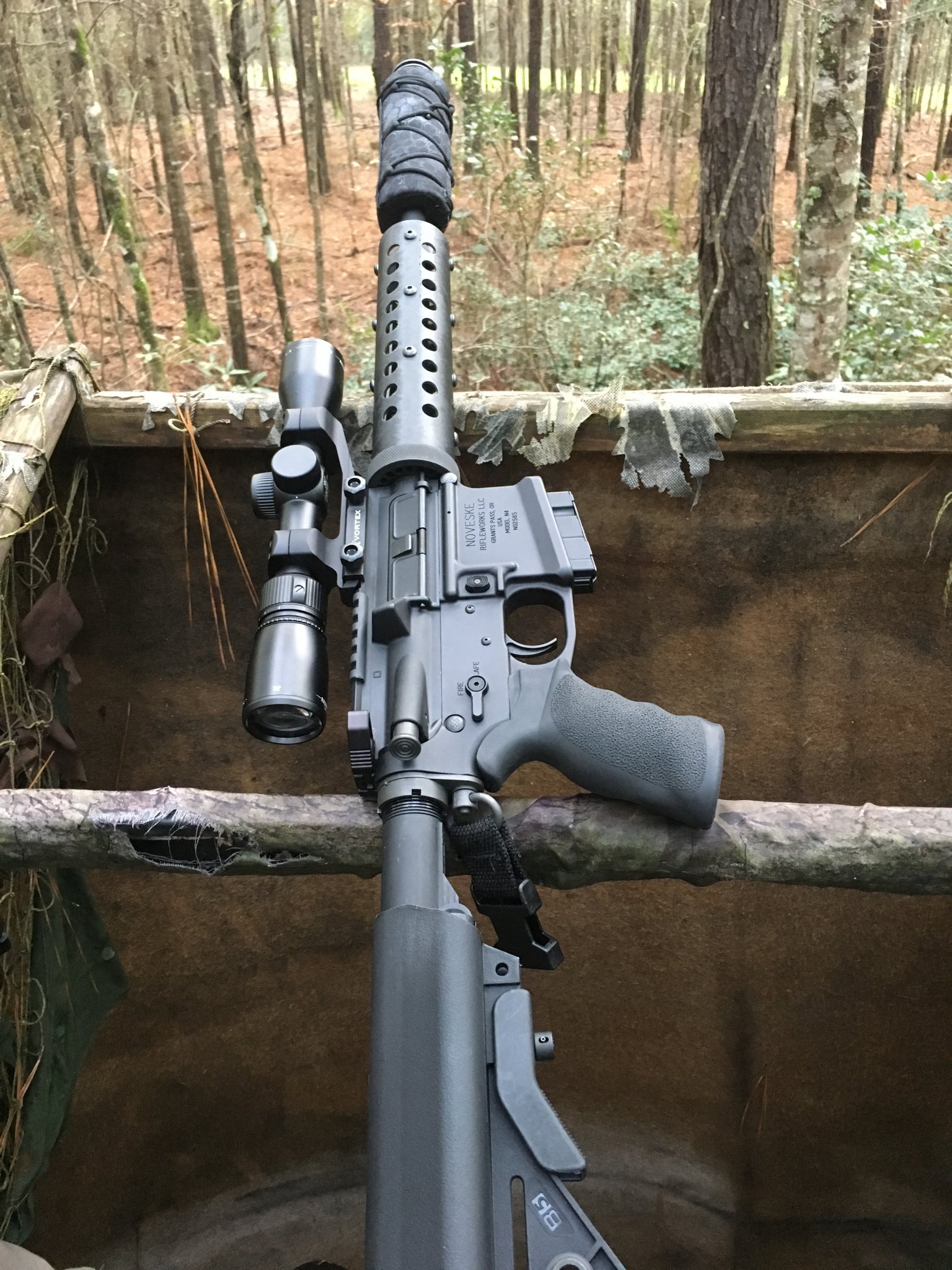

I use an 11.5” 5.56 and it’s suppressed full time. I haven’t cleaned it to date. Probably between 5-7k rounds through it. I haven’t kept track at all. Still hits behind the T2’s dot and groups well for a chrome lined SBR. I just add lube when it gets a little sluggish.
Look up Pat Rogers’ Filthy 14, if the bolt slows down just add lube.
I know I just gave someone a heart attack, but that’s what I use and it’s whacked its share of critters and the only malfunctions I experience with it are when I’m using old, beat to hell USGI mags that I know don’t feed 100% to begin with, ie training mags. With Lancers it hasn’t skipped a beat.
