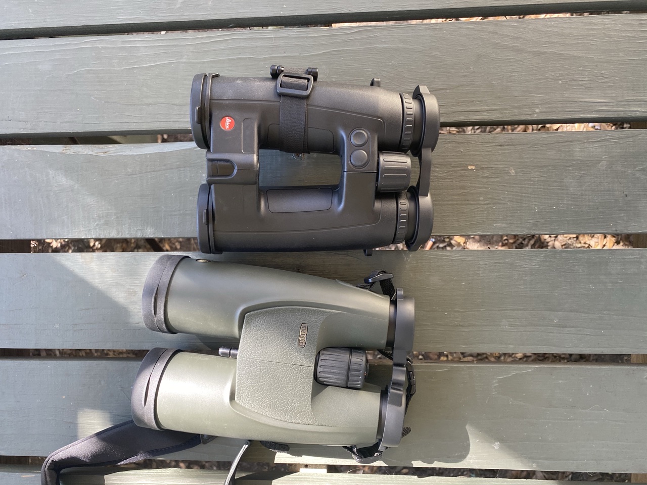

Binos. 10x - 12x is perfect for spotting and watching trace, finding targets, or even glassing a hill side. Swaros would be my first option, however if you want a budget pair that are 95% as good, the Meoptas are top notch.
You can’t go wrong with good glass. I think it boils down to personal preference as far as which route to go though.
For me, when I’m just practicing at the range, i use my Sig Kilo 2000 for rangefinding, and a Zeiss Victory Diascope FL 65mm with a 30x WA eyepiece for spotting shots on steel out to 1000+ yds.
When I’m hunting, I use a 10x42 Leica HD-R LRF bino, and I also bring the same Zeiss spotting scope for glassing (amazing glass in that Zeiss!👌) Now, I just ordered some 15x56 Athlon Cronus UHD binos to try out. Depending on how they perform, I may not need to bring my spotting scope. Anyways, try using as many different set ups as you can to figure out what you prefer the most. Good luck!
Reactions: NorthWesterner

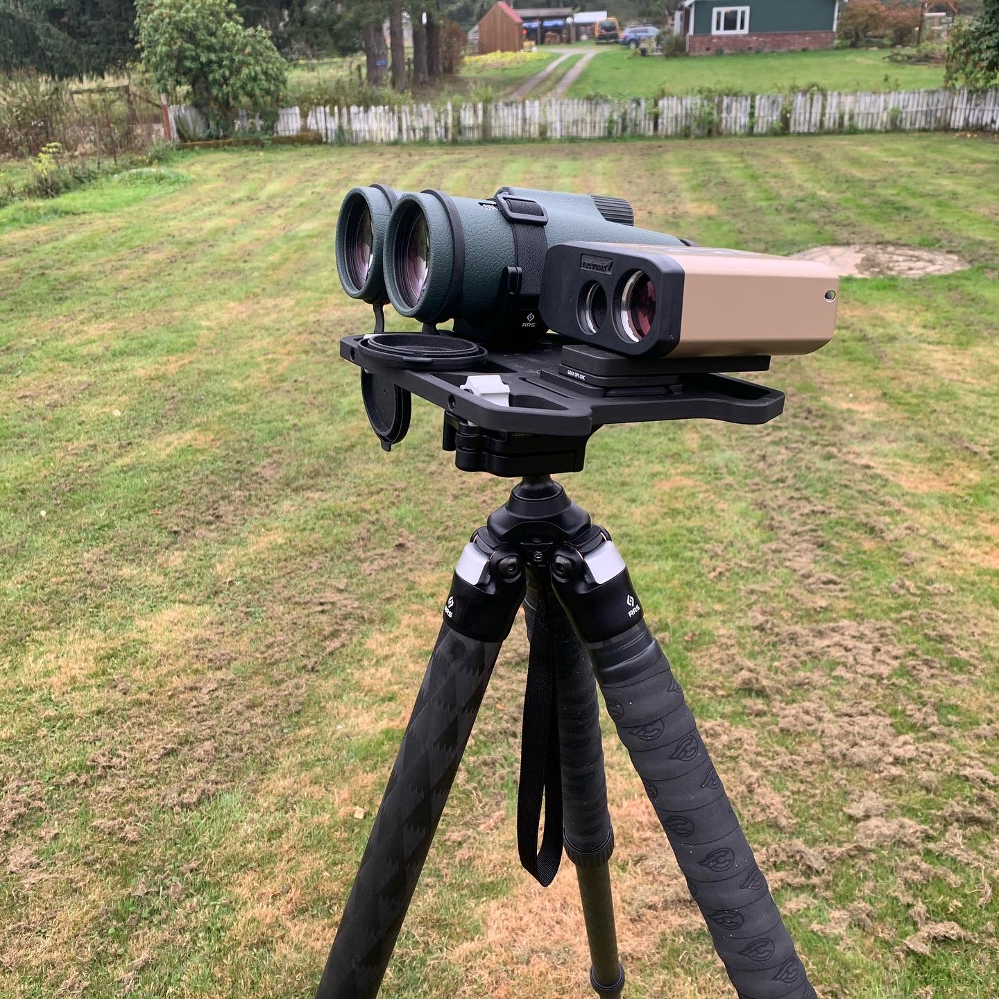

I went from a swaro 20-60x65 spotter to someSLC binos. I much prefer the binos for shooting.
Thanks for the advice so far. Seems binos are the heavy favorite. Any opinions about RF binos? Or am I better off keeping separate units? I assume glass quality suffers with rf.
I went from a swaro 20-60x65 spotter to someSLC binos. I much prefer the binos for shooting. View attachment 7441924
I want that plate and I'm sure I've seen it somewhere.
I'm assuming those are 15x slcs which I'm sure are so much easier for that distance that doesn't require spotter.
How hard is it to align? Thinking out loud you probably just need to be close. Get the rand then use Binos for spotting. How is the anvil to use? Nice setup brother. I've been thinking about the 15x to be a quick spotting scope option then if needed bust out spotter and or tripod especially in hunting scenario

I personally went with a LRF/binocular combo in the Leica 3200 Geovid. The glass on this is very comparable to the Swarovskis and I've used them side by side in a variety of conditions. The LRF on it is also outstanding - shot 1000+ yard targets recently in pouring rain and the Leica was giving good ranges all day when most of the handheld LRFs failed to range. Several shooters came over to ask us to range targets for them.
The plate is a grey ops Elite plate. It works very well and the two optics align well enough for spotting with binos and target being in fov in the range finder with no issue. The anvil is awesome, came from a rrs leveling base and I prefer the anvil much more. I’m glad I went with binos over the spotter.
