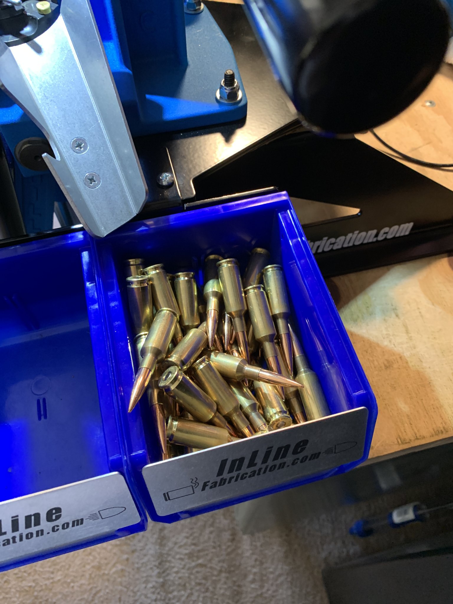

and FYI...i let my rifle rounds drop down the chute into the bin off my 550.
Godless heathen!
Each round is lovingly and gently removed from the last station by gloved hands before being securely placed into the kaizen foam inside of a pelican case for safe transport. Can't have anything affecting my perfect runout...

After seeing the RL550 bin full of fresh cartridges, I developed envy. Loading a few hundred rounds of Valkyrie or 300 Win Mag on the Co-Ax is SLOW. After having the Hornady drop a load, then confirmation of that load by the old RCBS scale, and finding out that in fact, the red machine makes one cartridge .1 grain off about every 40 rounds, I think that I will try my new Lee Collet die in my RL550, and make Mo Ammo, Mo Faster🤪
