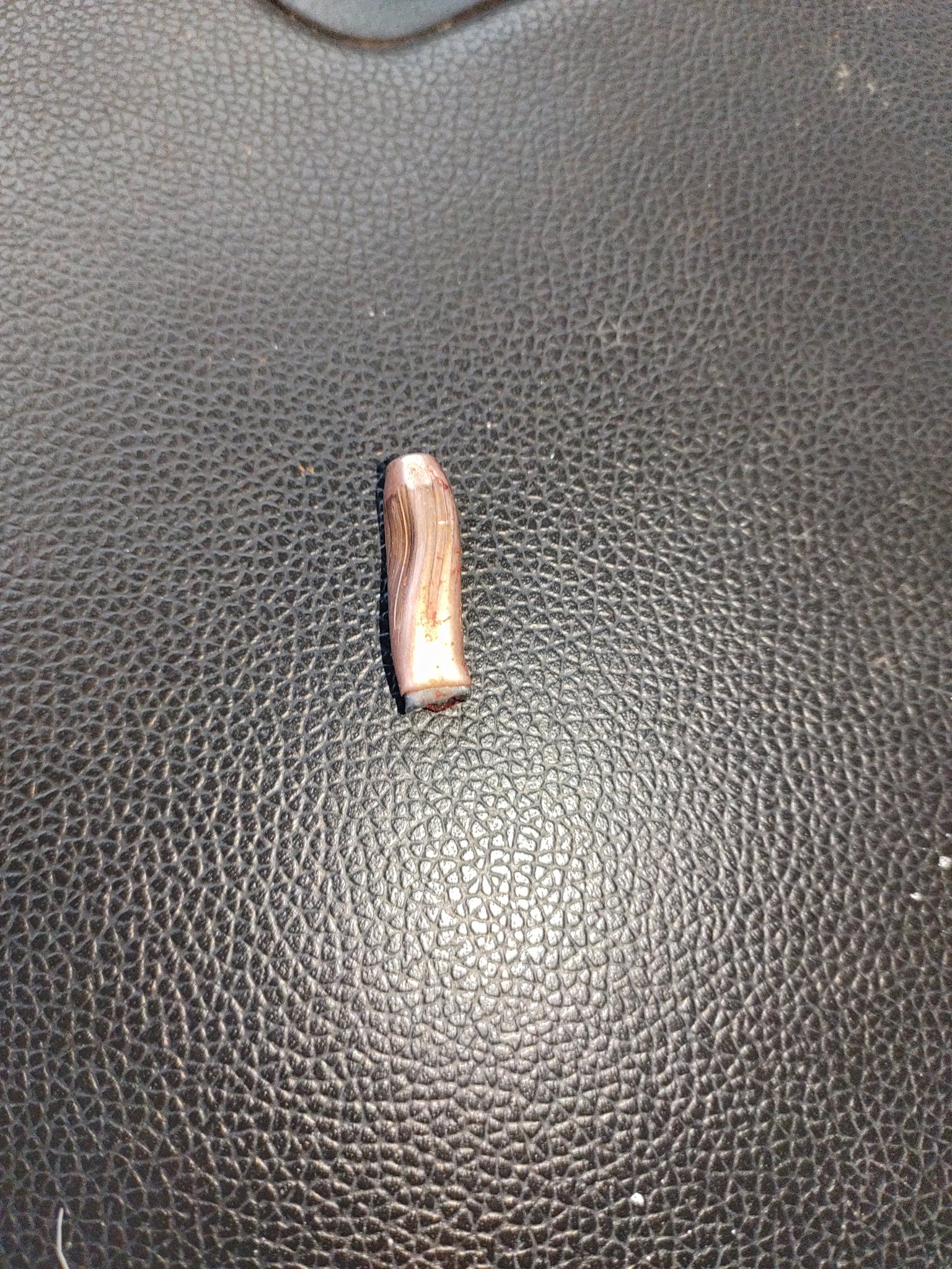

What happened? 6.5 grendel vs deer.

    So this picture is kinda graphic. I was going to post in the semi auto forum, but I figured you fellas lurking here might have a better idea of what happened. Shot this whitetail buck about 70 yards away with a 6.5 grendel, using Hornady American Gunner 123gr BTHP. Straight on shot to the chest. The entrance is larger than a soft ball. when I was processing it, the bullet was right under the skin in its hind end. There is literally no expansion. The bullet is just missing the tip and it's kinda flattened. What happened?

    Last year I was using OTM ammo and it mushroomed and had great expansion on 3 deer. Probably luck. I know that OTM or the American Gunner is not the best hunting round, I just wasent expecting to see that I guess. Makes sense though. Thanks man!

    I've shot quite a few bucks with target bullets out of my 260, but never a straight on through the chest shot.. I haven't lost one yet,, knock on wood.. Problem is you didn't get in perfect alignment with the chest and asshole to get an entry and an exit, those weak ass Grendels need a little help getting all the way through.. Lol :ROFLMAO:
    I bet there's been more than a few hunting bullets that have failed like that....although not sure id call it a fail since you got the meat. Id like to know what the velocity was.
    Me too. Its a criterion 22" Hbar. Charts are saying between 2500 and 2400 FPS at that yardage, but I believe that's out of a 24" barrel.
    Lol, I was trying so hard to get my .308 up and running, but didn't have the funds. Next year...maybe.

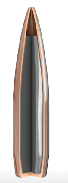

    Why were you expecting it to expand? Was the bullet designed to expand? And is the bullet marketed towards hunting with "expansion" in its description? Seriously though, if you're going to hunt with match bullets, who cares if they expand or not? Put it in the right place, the vitals, and watch them die.
    Now on another note, I use the 140 BTHP and it works wonders for me on deer. I've had them expand decently.
    The entrance hole larger than a softball is the elephant in the room.
    Was this deer wearing some type of explosive device? Possibly a terrorist deer? Just spitballing...
    That was the main question I was hoping to have answered. I'm not surprised the bullet didn't expand, even though every other one I have shot has, I'm just curious what happened to this things chest. I feel like for a 6.5 Grendel even an exit wound that large is pretty crazy
    I may have missed it but what was your distance? I've killed a few deer in Kansas with grendel. Never had massive exits or entrances. 300 yards is about the max I've Shot on our land ( easy shots but we have hills and trees that make longer shots near impossible)
    I'd say he was about 70 or 80 yards away.i shot one last year as well have had an exit would the size of about a tennis ball
    I'd say he was about 70 or 80 yards away.i shot one last year as well have had an exit would the size of about a size of a tennis ball
    Mine have been slightly smaller than a tennis ball but typically that's the general size of an exit. Never seen anything bigger personally. Only thing I could think of if the round hit a bone or large meaty mass that blew outwards causing a larger hole.
