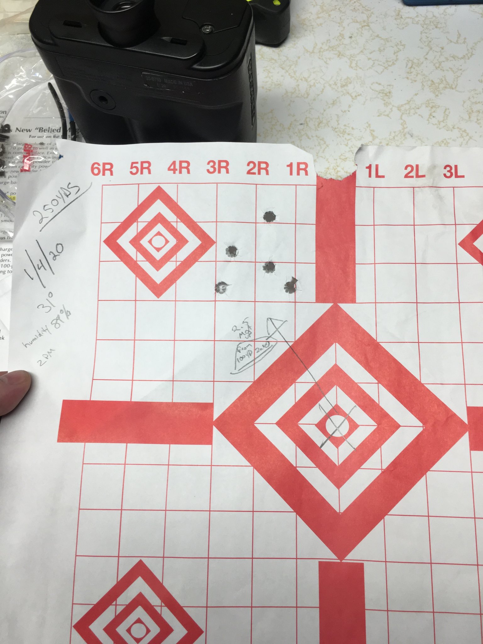

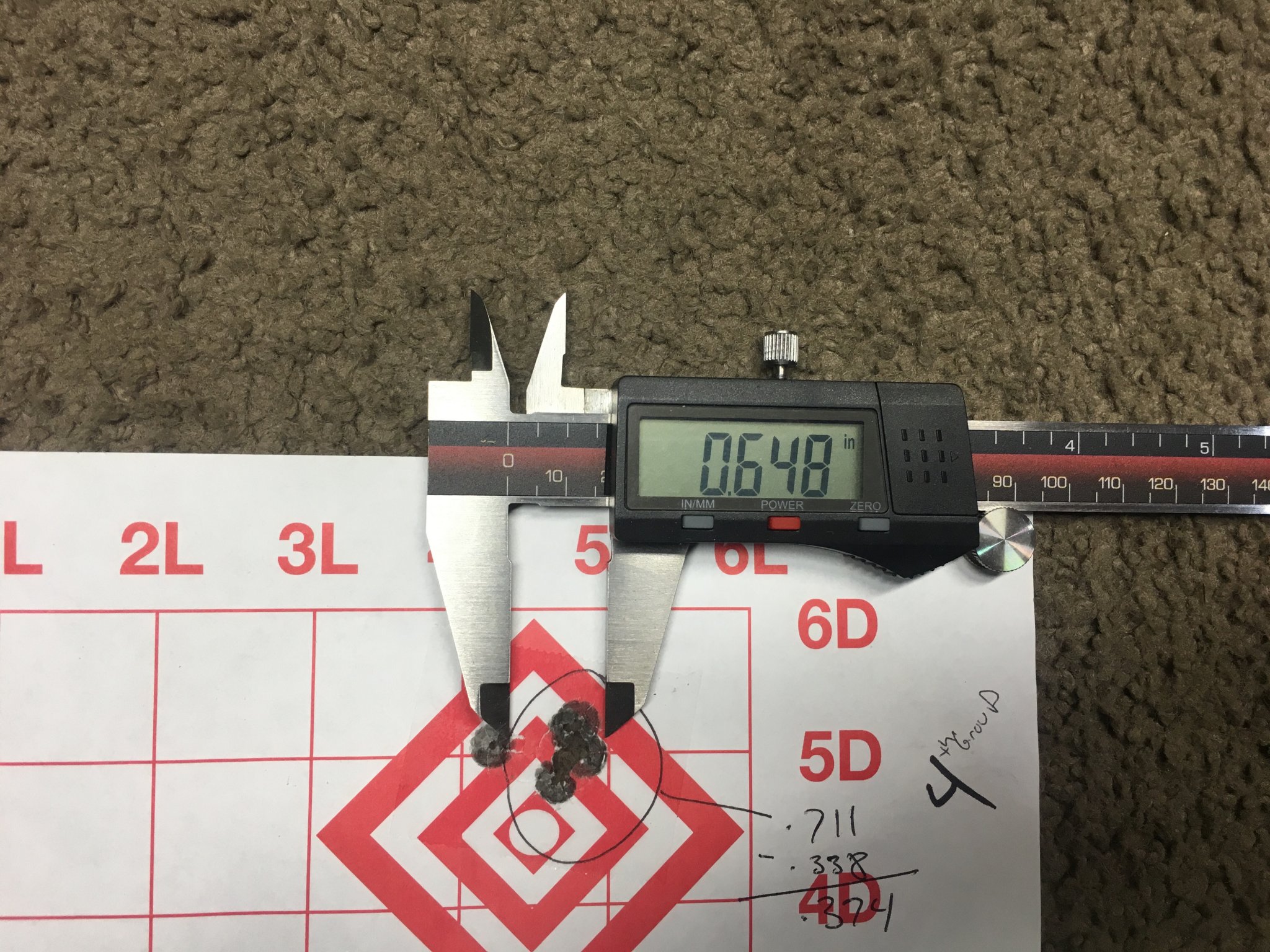

I shot my RPR .338 for the 1st time last summer. After quit a bit of fiddling with the scope and figuring out a lot of stupid small things for my own, I managed to get this grouping. This is at 100 yards. ( picture attached)
Fast forward to last January, I shot at 250 yards. I dialed my scope up to what I thought was correct ( scope was zero at 100yds) and I was shooting about 2" high.... now this is my dumb question- Is it possible that the extra 150 yrds did not require any adjustment or holdover? is the bullet still going flat enough that a 100 yrd zero will still hold at 250? ...And before you ask, no i didnt think to hit my zero stop and try at the time because i just assumed I was doing something wrong and didnt think about it.
Well first off, No. You should have had drop, off the top of my head I'd guess in the vicinity 2 MOA or .6 mil (give or take).
Whenever stuff like that happens, it's best to bring things back to 100yd and verify your zero. Unless your scope is drastically higher over your barrel than most setups you shouldn't have the same zero at 100 and 250.
Reactions: juice900
lets say I confirmed my 100 yd zero is still on, then i dialed up 2-2.5 moa and was still shooting about 2-2.5 in" high at 250 yds- does my 30 moa scope rail come into effect somehow at that distance? Im wondering if i had a 200 yrd zero and shot at 350 yds if i would get the same result...
Confirm something please.
The way I read your post was that your 100 yard zero is actually 2 inches high on purpose.
That would be old school hunting rifle stuff for using a capped scope.
It has a place, precision long distance is not it.
no, my 100 yrd zero is dead on....at 100 yds. i later shot at 250 yards,.....so after reading these replies I think I know what I did. I dialed up 2.5 moa on my elevation... not sure why I had it in my head at the time that thats what i needed to do. I think I now kinda understand my mistake but im still a bit confused lol. Im pretty new at this.

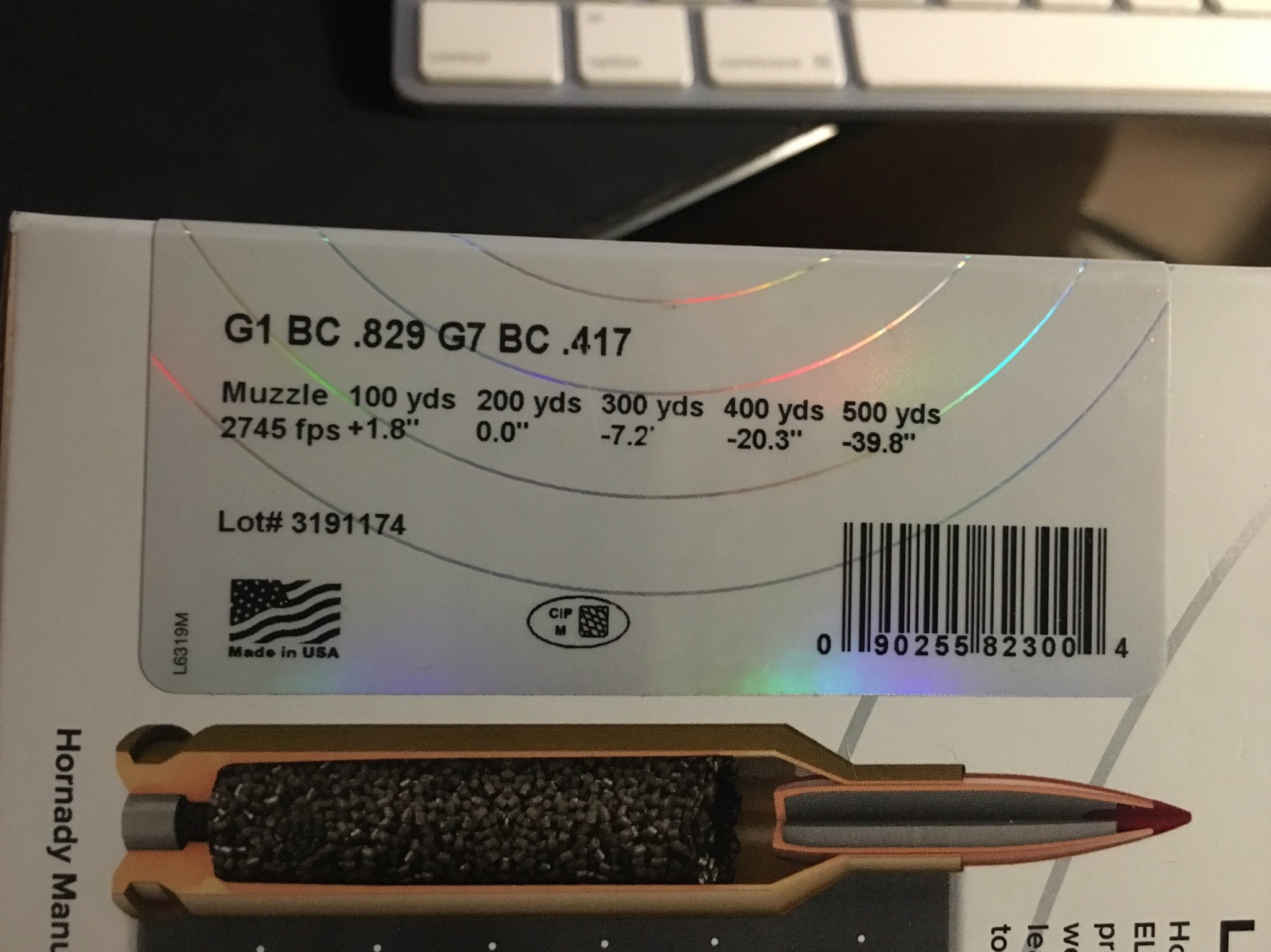

so if im reading my ammo box correctly, doesnt this mean if Im zeroed at 200 yards my bullet will drop 7.2" at 300 yds?
Reactions: Dthomas3523
You are correct according to the box a 200 yard zero will drop 7.2 inches at 300 yards, only you are zeroed at 100 yards. You need to learn how to use a ballistic calculator, that will give you a reasonable prediction of where your impacts will be.

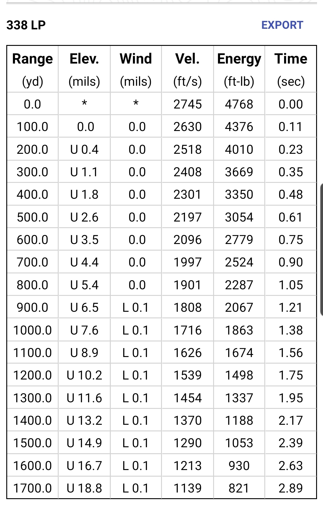

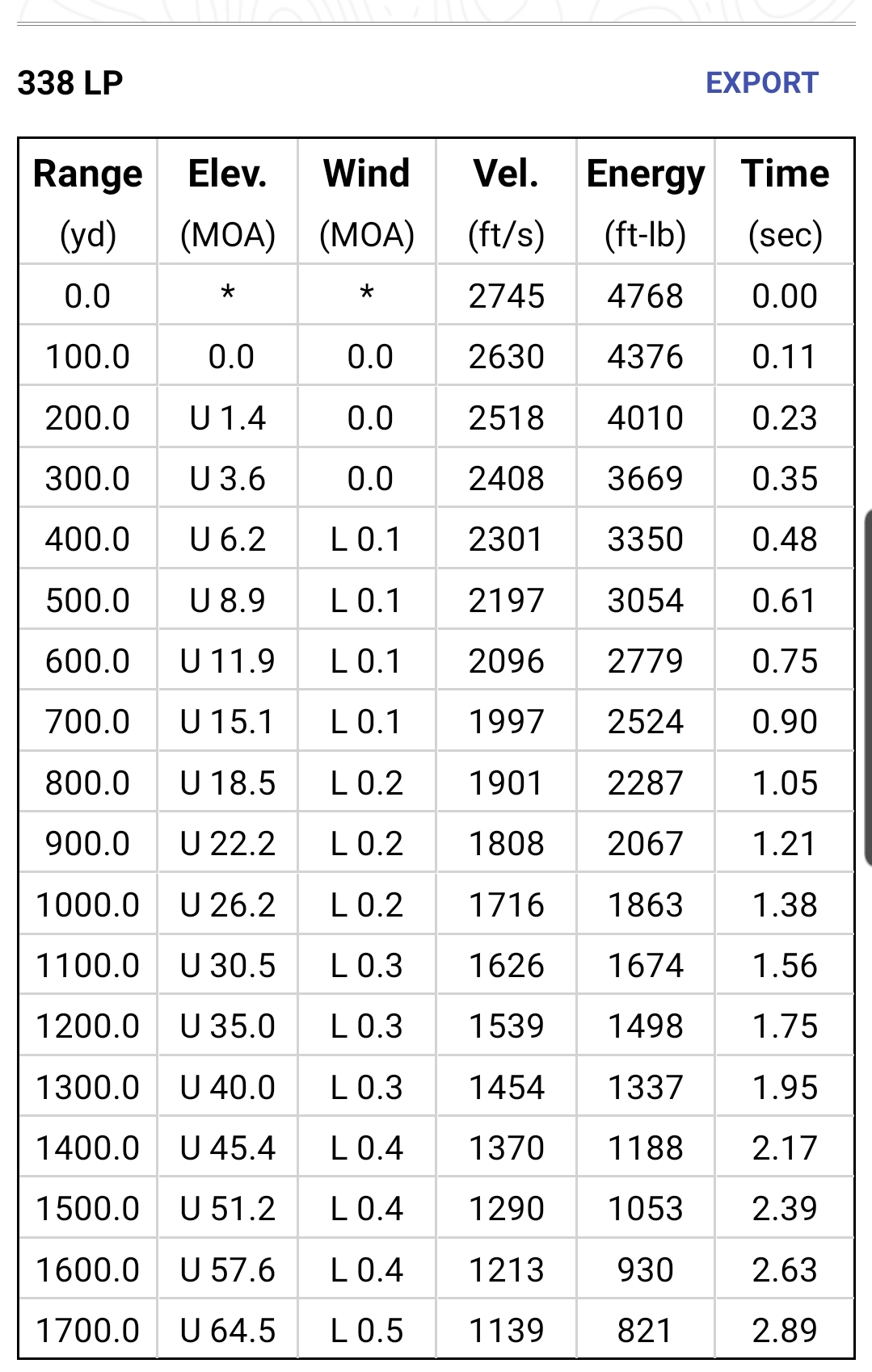

Also, here is a baseline:
Reactions: juice900
Ok......
While your interpretation of the trajectory on the box is correct, I want you to listen REAL GOOD: NEVER. I repeat NEVER ever again use inches/centimeter/any linear measurement to describe bullet drop or trajectory in any way.
