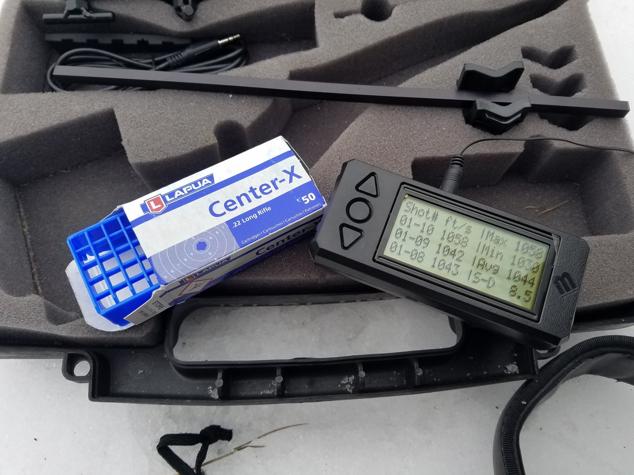

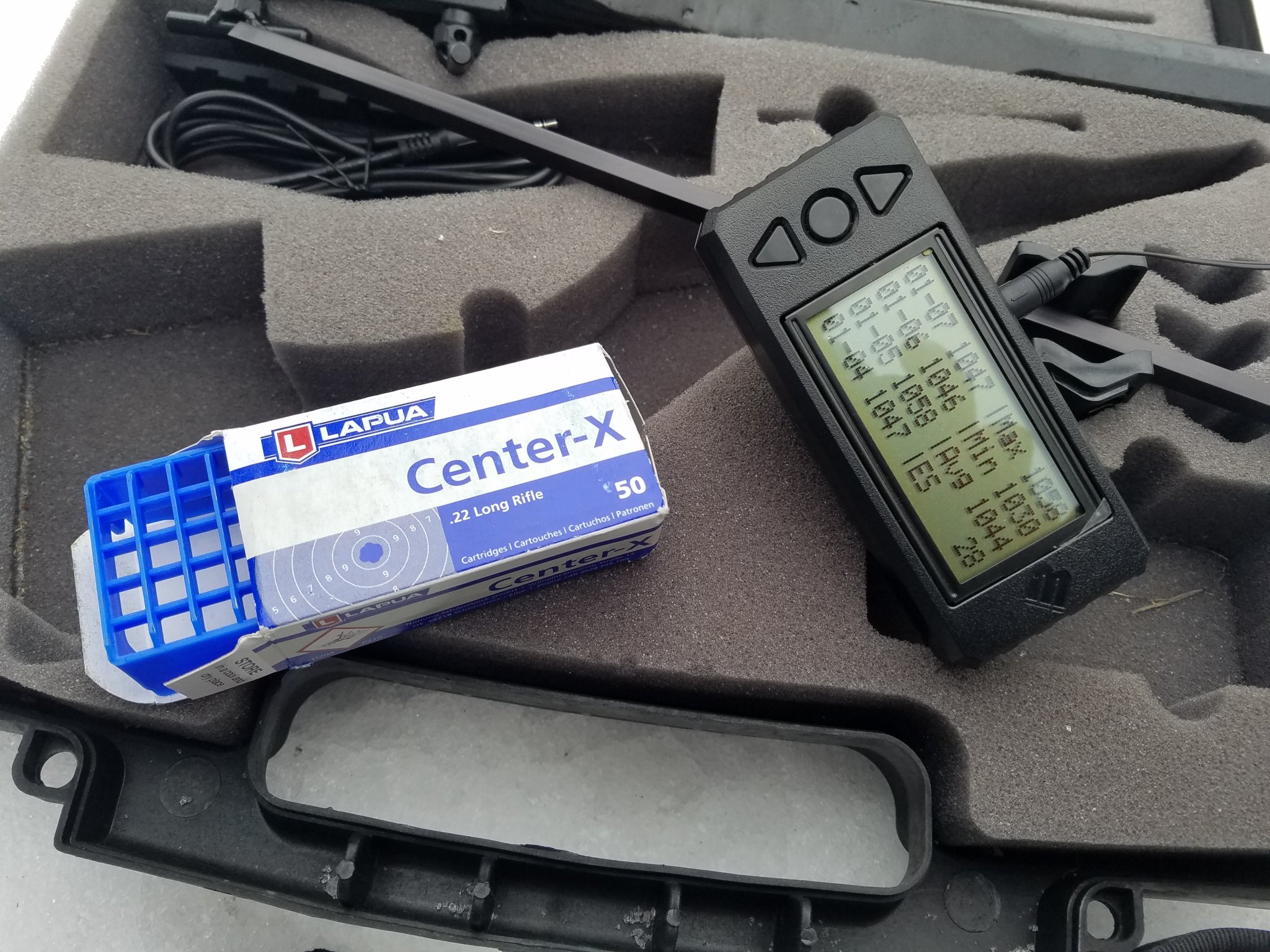

I'd say you'd should take a close look at Lapua's and RWS's high end products.
With the batch of Center-X I have, it often is less than 20 and sometimes Federal's Ultra Match does that for me too.

I've tested just about every brand of rimfire available.
Not 5 shots, not 10 shots, a minimum of 50, preferably 100 shots.
17 hmr, 17 wsm, 22 wmr, 22lr at 50, 100 and 200 yards.
I have no life and am easily entertained.
Hp1yF2fDMpjz1jh3Rud4yshOe9DyA4_tDYC1D4eVKHbpt-xbsJTTo6PJ77Ifij4LPfMl97gOCmJA9PNjtw=s15
There is no "find the brand y'er rifle likes".
It's an internet fallacy. I think it's a sales gimmick promulgated by retailers.
They want you to spend y'er money on their products.
If they can get you to believe the lie, you'll increase their profit margin.
The quality of the ammunition is not a constant, it changes hour by hour as it's manufactured.
The rated muzzle velocity on the box is an estimation.
If the word "Match" is on the label, it ain't.
tR-f71u04ULNS3j0VCUaNlmUy5Bd7vxpw01bs6u4IAklQ1CyS3l5NgOP1LQ_0Xs5KodJZimSfzw68kb9Zg=w31-h20
The truth is: Find the "batch" y'er rifle likes.
It'll be the ammunition that was manufactured with the least amount of defects,
most consistent primer/power amounts, similar bullet weights that produces the most consistent trajectories.
You'll note I didn't say brand. I've had cheap bulk ammo that produced amazing results
and high end supposed "match" ammo that was only useful for the kids to plug soda cans with.
It's not the brand that's critical...it's the quality of the ammunition that will determine if it was worth the money.
PDZNNAGYye5dIbW7cyX4UW4ghc8fRc70ldemfoaabO2mZ7EOJ8hvv2QLuN3NCVMjRqXi_yM-iYjpYWhc2Q=w400-h440
Mouthy old coot, ain't I?
4gU3JP7G8gj5-7npNtVsQHRbvRY5EByfVcyHesnhufl8U0LGyEJMnzW8Q6HtC7BkG3sFb9dO4PhPhkRVBA=w32-h28
SD means nothing to me.
ES is all I care about.
Decent ammo will have an ES of less than 40 fps for 100 shots.
Practice ammo will show an ES less than 60 fps.
Plinking ammo will show an ES less than 80 fps,
and bulk ammo will have cartridges that might not even chamber
due to out of spec brass and tilted bullets.
The stuff with less than 20 fps ES for 100 shots?
That's what's called "magic"....rare and hard to obtain.

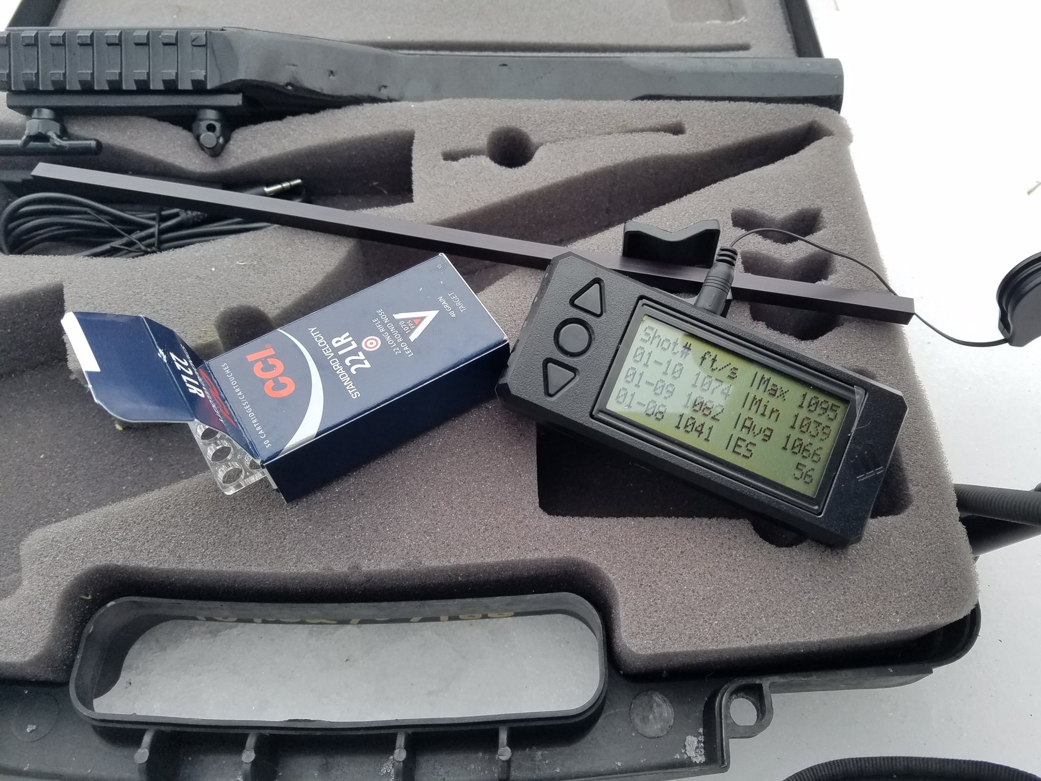

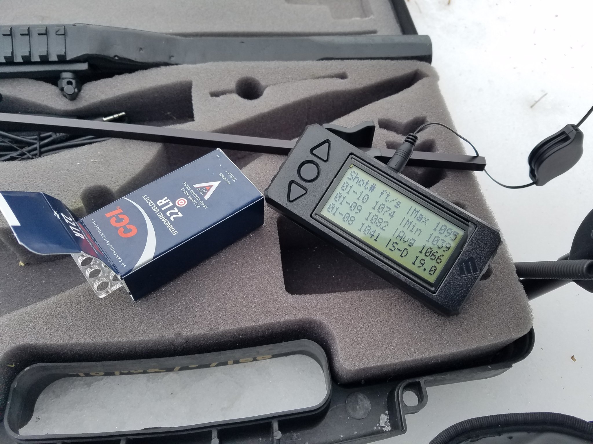

The cci sv does really well at 50 but falls apart at 100 for me, but I agree it’s hard to not keep buying it for less than half the price of the sk ammo
That is something I have seen also, but yet to definitively prove. I too use it (CCI SV) for practice and am using SK Standard + for match.

I tried the Green Tag and was unimpressed. The CCI Standard Velocity was slightly more accurate than the Green Tag. But at a nickel (or less) a round, the CCI SV is good value. At shorter ranges (up to 50 yards), the CCI Quiet beat the CCI SV.

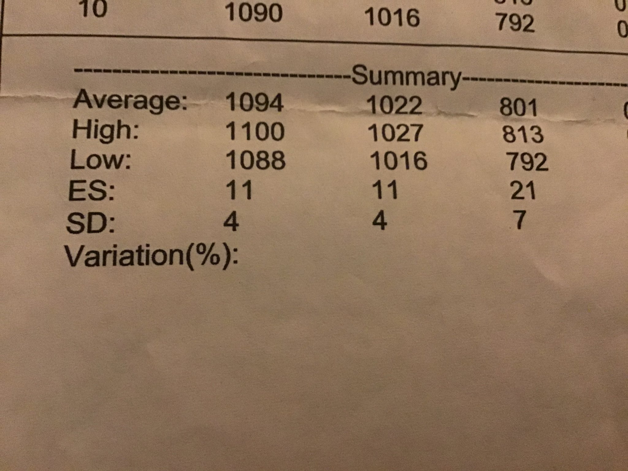

Only ten rounds
Es at muzzle and 50yards 11
at 250 yards 21
SK Long range match out of a Vudoo
This lot shoots very well ! Did have a lot that had muzzle velocity of 1130 and that was Awesome (less dialing/hold overs)
