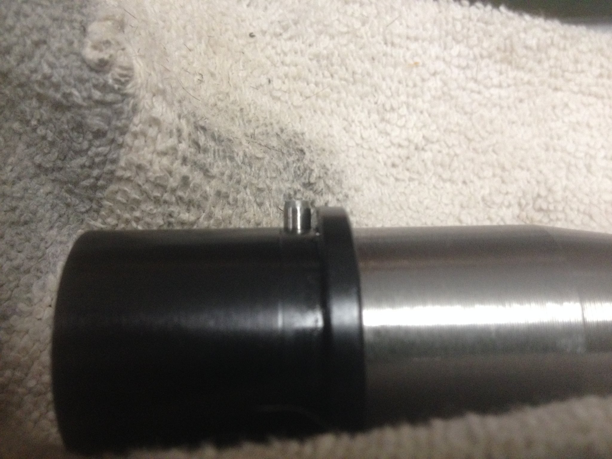

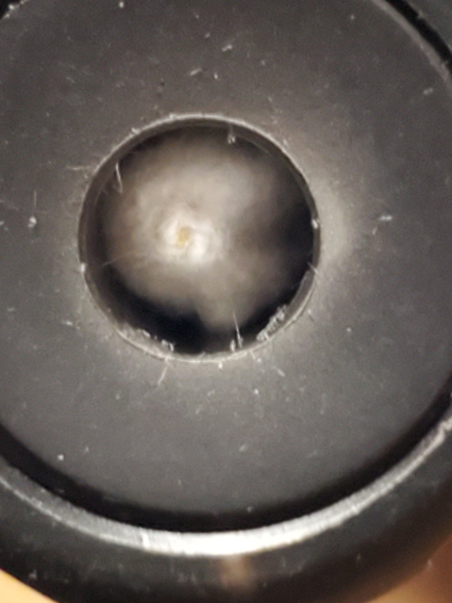

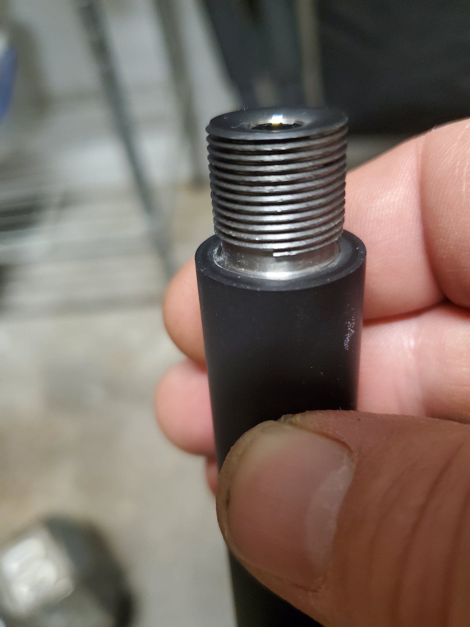

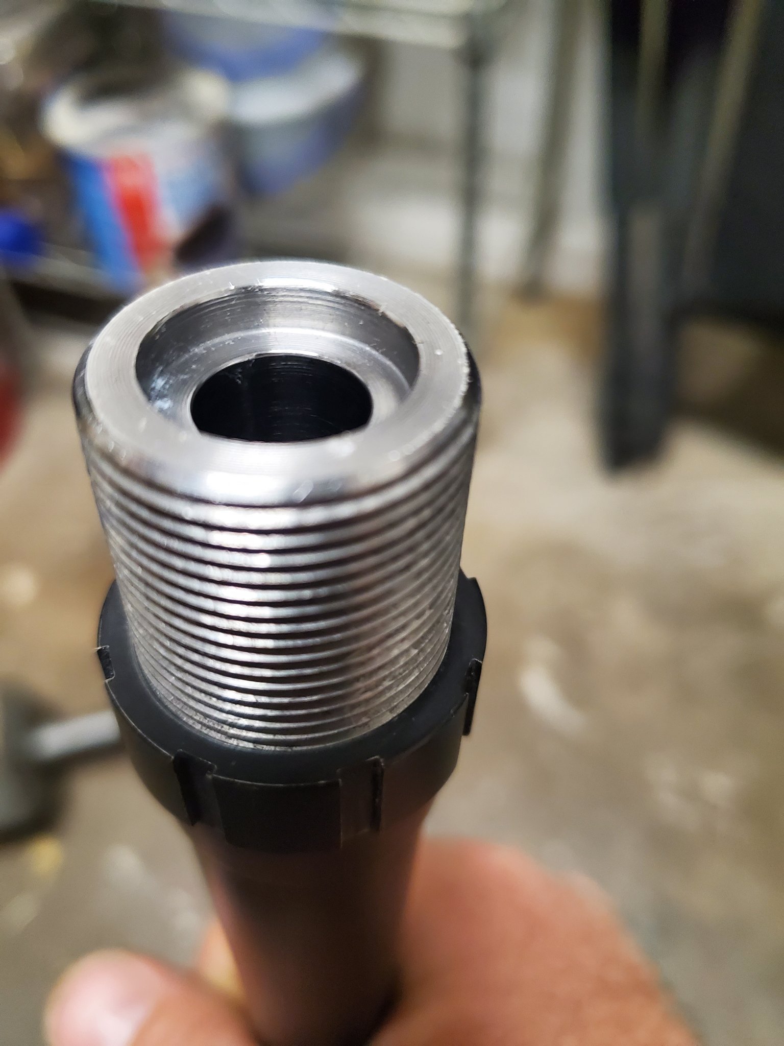

This barrel is a replacement for a replacement. The first one had drastically undersized muzzle threads. The second one had drastically undersized tennon threads. All showed this same rough threading. The first one had the same bad crown as this one. The second had no crown. I guess when you crown like this. Leave it alone. Lol.

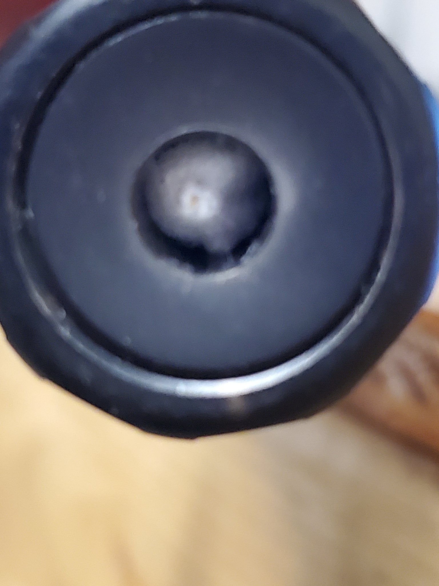

I tried to lap the tendon threads some to remove some of the roughness. Then I ran a patch down, and had to bump the cleaning rod with my palm to get the patch through the crown. The rough threads are crappy, the crown is worse, I wonder what the chamber job and rifling job on the blank looks like for that matter.
I notice no one else sends me barrels with threads that look like this. It's only my assumption that there is a reason.

I was going to send it off and have the muzzle re-threaded and crowned, but I keep telling myself. You really want another 75-100 in this thing. I would have thought they would have thought that by now too, and sourced a barrel from somewhere else to send me. :ROFLMAO::ROFLMAO::ROFLMAO:
I don't grow little baby tomato plants. 🤣 🤣 🤣
I took in the first one used, probably from someone who got tired of dealing with them also. They "never noticed the muzzle threads were small." And I mean my QD attachment could hulu hoop on them. I am not out the full price of a barrel, but have pretty much no chance of a refund.
I was considering cutting my losses on the last barrel, but un-benounced to me they were making me this one. Then I got this one, I was like the threads are rough. I can work with that. Then, dang, the muzzle threads are worse. I looked through the barrel from the chamber, and I could see the burs on the crown. 😳
I might be able to just get it recrowned I guess. Both threads seem useable.
I imagine they would replace it again. I thought they would make me send the other one in before they sent this replacement. I was not expecting it until i got a shipment notification from them. There CS has been fine. The product I keep getting is the problem. I might just order a crowning tool and try to crown it myself. I don't think I can make it worse. :oops::ROFLMAO::ROFLMAO: I was wondering if I could get a finishing reamer and clean up the chamber. i hate to buy anything for 243WIN though.
Watch me crown it and it be a freaking lazer beem. :ROFLMAO::ROFLMAO::ROFLMAO:
Ordered one barrel from them because they had it in stock never again the chamber was so rough I had them polish it but haven't messed with it since I got it back. They just seem not to care to much and I will never use them again.
Can I lap the burs out? Should i nock them down with a jewelers file then lap them? Do think I will have troubles with stuff coming loose on those threads?
I mean you can't make the barrel any worse than it already is, I'd make sure the threads are at least smooth and in-spec though before screwing it onto any action you care about to avoid damaging the action itself.

My only guess has to be all of their qualified people walked off the job for whatever reason or they're using all these shit barrels as a tax write-off due to financial woes. No decent machinist would allow that sort of work to pass inspection. No owner would want their staff to send this stuff OTD in this day and age of social media and internet forums with massive membership roles. You'd have to be as dumb as a 2x4 or have a desire to completely destroy your business. Yet here we are. Truly WTF. There must be something very, very wrong at McGowen post-blank manufacturing phase. Their blanks seem ok. It's what happens after that's truly incredulous.
I had a similar experience recently, damaged crown, weird chamber, sent my barrel back and am waiting on the replacement. In the meantime, my f*cked up original barrel is listed for sale under their in-stock section. There's a sucker born every minute.
I've literally lost all hope of getting a quality barrel and I'll likely end up wasting another six to eight weeks when I could have ordered a WOA and been perfectly happy (today) for a reasonable amount of money.
Stop taking orders and fix whatever needs to be fixed. At a certain point, there's no coming back from a damaged reputation.

All three of my Remage 243 barrels have had rough threads. I had to grind down the locating pin on the barrel extension of the AR-15 barrel they made for me. It shoots Ok. I guess I should pull the muzzle device and look at those threads again. I seem to remember being less than impressed wth them also. All of them had rough enough chambers, that I polished this one.
I am going to order a 45 degree crown lapping tool. And see if it will shoot. If the muzzle threads are concentric and it shoots maybe I use them, maybe i get it r-ethreaded and crowned.

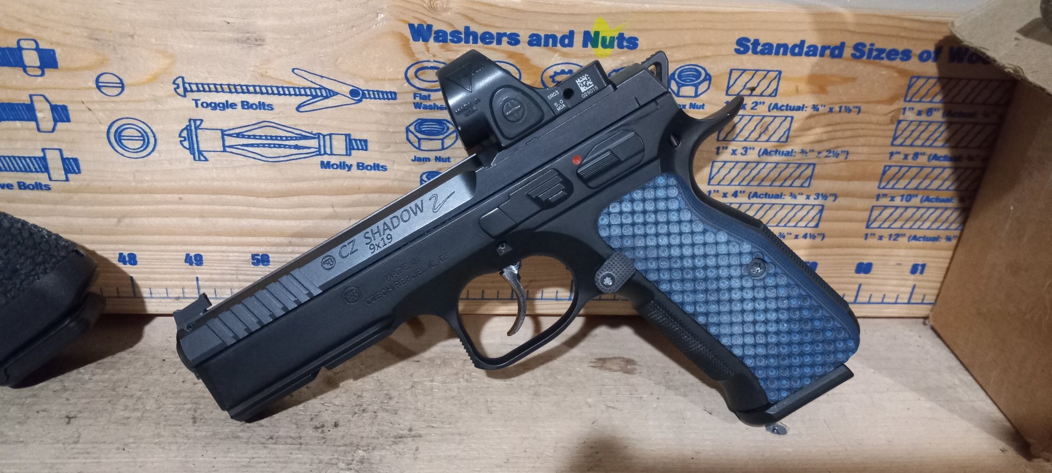

No likey SAO pistols. But USPSA might add Limited Optics if you're interested.
Got this one on Black Friday sale: $1237 delivered NIB
Nice score, but I got one of those. I shot my first pistola match a week ago. No alphabet classifications just an Outlaw steel thing. Had a blast. Got to shoot some good stuff after the match. The MPA is damn solid, atleast to a non pistol guy like museff.
There's a big difference in how accessible performance is when going from light (sub 35 oz) to heavy (40+ oz) pistols. But you need skills to access that difference.

Supercorn, that totally blows, especially that they've already had an opportunity to make it right and still screwed it up. Question for you, this was from McGowan and not from another smith who turned a McGowan blank correct? I was literally going to order a barrel from CarbonSix this week, but they use McGowan blanks and this has me a little hesitant. But if the issue is more with the smith service and not with the blank itself, that would put me a little more at ease... maybe, but if that's the kind of QC McGowan has, then maybe I pass...
Yes, these barrels were made by McGowan. I have always heard good things about their blanks. Of course we all know some unlapped savage train track looking barrels can shoot. I can say it felt smooth running patches through it. Although it feels to me like it might have opened up at the muzzle threads. @killswitchengage offered to thread and crown it for me. I was planning to lap the crown, shoot it a little, and check some brass before I decide what to do with it. If it won't shoot or the brass has lots of run out i will probably cry to McGowan again.

My last barrel was the same story and it will be my last of thiers , they are rude on the phone as well and suggested perhaps my action had oversized threads. I laughed at the guy , thought it was a joke. It wasn't.

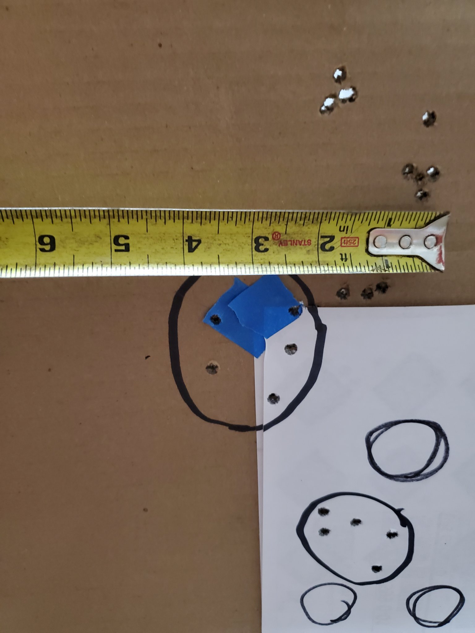

Well, I mounted up the barrel. The tenon threads are not as loose as the last one, but not as tight as my Crown Ridge or Criterion barrels. I bet If I had wires they would be still be under. It also shoots like dog shit so far, 2-3 MOA one might touch 4MOA. I loaded a different bullet, pretty sure its not going to matter. The Nosler CC blem 105s I was shooting shot bug holes in my 243 AI. But i loaded some Hornady 105 match over H4350 to try next chance i get. I could see some pretty good copper streaks on the rifling at the muzzle end after 20 rounds.
  • Sad
Reactions: MarinePMI
Yep no love with a different bullet and powder. The two cir led are from this barrel. The others are from a 224 Valk AR.
If you look at the POA, the circle below and right. If you over lay this as a 10 round group it would be 3.5 to 4 MOA.
