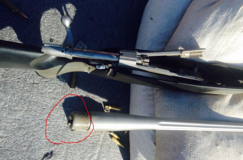

So shooting a new rifle and I am noticing pressure signs early I think.
I shot roughly my 100th to 145th rounds (45 rounds total) yesterday and grabbed some data. Basically these are conservative loads yet I am seeing slight ejector swipes.
Virgin Peterson, base to shoulder is stretching .013 to .014 once fired.
300Norma Mag, H1000, SMK230gr, CCI250
82.2gr of H1000 and is averaging about 2880fps, which is not fast. Some of these had a slightly heavier bolt lift. This was a seating depth test but that had little impact on velocities.
This was OCW with Berger 230 hybrids. 81.0-82.2gr of H1000 and still you can see slight ejector marks. Virgin Peterson. Average about 2890fps. The 82.2 had slightly heavier bolt lift. Lightest load left to heaviest load far right.
For comparison, I shot 10 rounds of virgin Lapua that day too. Virgin to fired on the Lapua has .005-.006 stretch from base to shoulder
N565, 77.0 and 78.0gr (very conservative), FGMM primers, SMK230. average 2720ish feet per second. These did not have a heavy bolt lift at all but still faint swipes.
Well we all like pics right?
Is this just the nature of a magnum? Never owned one. Am I doing something wrong?

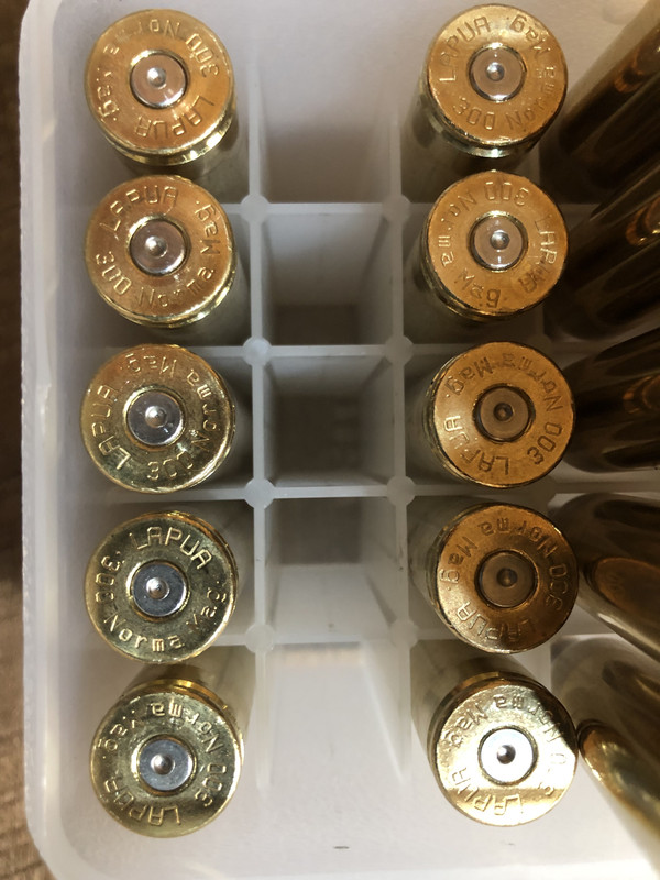

Wasn't very clear in the OP. I had already done some OCW before all this with SMK 230 (all with same seating depth) but without labradar. Also had some success during that first round of OCW so the Peterson SMK batch was to test seating depth because I liked my charge although it's low compared to most. Also noticed the pressure signs so I was a little confused.
So decided to chrono this round of SMK seating depth testing (since I should have the first time but didn't have the time). Well I had time to make some more rounds so i decided to make the Bergers for an OCW in the same Peterson brass (all had same seating depth). Had a rough idea of seating depth due to the good results from the original smk ocw.
Then I just so happen to get my new shipment of fgmm primers, N565 and lapua brass sooo I wanted to try those out too. So among all these different components, I am at different testing stages in development. Basically I agree and am testing incrementally, one change at a time.
Common thing I found in all this was pressure signs across the board. The N565 was at V V recommended starting weight of 77.0gr and I saw the faintest ejector swipe but bolt did not feel heavy. Just seems like I am getting pressure signs on this rifle when I shouldn't be.
In the midst of all this I took note of my brass stretch but IDK what it means.
My questions:
What could cause early pressure signs?
Whats a normal amount of brass stretch?

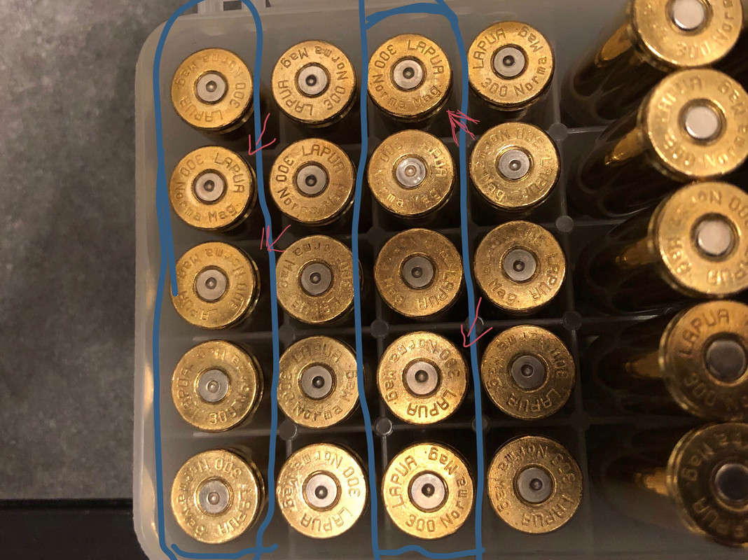

I enlarged your pic, I do not a see swipe. But a swipe on the outer edge of case head is different than an ejector mark. The marks on the outside of caseheads comes from the extractor, or a dirty bolt face, clean the bolt face. Like I said earlier, I bet most of your issues disappear on once fired brass.
If you look close on your Peterson brass, the swipe as you call is from rotation, or failure to rotate on extraction.
Thought can could increase chamber pressure slightly due to gases not being able to escape as fast as they could if the can was not there.
I have seen that in a dasher sized case, so I cannot say you are wrong. But it is your brass dimensions here for the majority of it. Hey either FF your Peterson brass with a jam, or move forward with Lapua like you want to.
Ya know what, I did clean my bolt and yes it was a lil dirty. Yes I see the extractor and ejector marks on the Peterson Cases. I have another pic of the Lapua but there is the faintest of faint "ejector" marks on some of the Lapua:(Their both more pronounced on the Peterson.
Thanks for the info on rotation. Didn't know that. All said I'm getting a feeling of a combo of a few things. Virgin brass, Peterson being a lil out of spec, dirty bolt and I might just have a slow barrel. I relooked at all of everyone elses data and I'm not that far off from them. Might just have to accept that this just be a slow rifle because I am a safe/conservative loader.
5 on left are 77gr. 5 on the right are 78gr. Max weight per manufacturer is 78.9gr FWIW

I took a even closer look at your brass and noticed, that there are some alarming signs on the Peterson sample, besides the ejectormarks.
The extractor may have had an VERY good grip in the groove and i think you should consider the use of safety glasses, very carefully, if you keep using that load.
The pressure has been so high, that the brass has started floating and the next step could be a case rupture, which in a Magnum will be catastropic.
A guy, known to me, had a Sako 75 in 7mm RM and looked like this, after a case rupture.

Hmm interesting. The brass I have is some of their first lots made. I got on this 300NM train early but am just now really diving into this caliber.
To possibly further this theory, my Peterson had .013-.014 stretch and the Lapua had less than half that at .005-.006. The Lapua did not have heavy bolt lift but had a very very conservative load which was manufacturers starting load of 77gr. It was also 200+ fps slower than H1000.
MY BIG MYSTERY IS, then why did the Lapua still show faint ejector swipes at starting load with a slow fps. Maybe 30thou off lands is still too close? Maybe it has something to do with the can? Have not tried shooting without a can. Well I have but it was a while back. Basically I got this rifle, did very light break in loads (78gr of H1000) to break it in and went into OCW testing. Well I shelfed this whole rifle for over a year and am just now getting back into this rifle. That's why I cant remember what all fully transpired on my first round of OCW.
Also I love your stuff. Have 2 of your bags and used it to shoot these in the pics!
I’ve put faint ejector marks on Lapua 308 brass with starting loads. 185 Juggs with Varget too close to the lands.
Just cause it’s Lapua doesn’t mean it’s bomb proof.
Flat primers, meh. Some primers cratered and some not, look the fuck out.
Your brass is telling you , you are making way too much pressure. At the range it was telling you, stop fucking shooting me and figure out why I am way over pressure. This is a 101 problem. You don't need help from a forum, you need to go back to the basics and start learning the very first things about reloading. I don't care what velocities others make and how much powder they use. Reloading is an individual process for each gun.
I am glad you didn't have a catastrophic failure, and that you came here to get scolded before you did. For future reference, when you see ejector swipes, extractor marks, and cratered primers it is past time to stop shooting that ammo.
I bet most of that brass will no longer hold a primer.

Think it’s all figured out now. So combo of brass being too short, dirty bolt and distance to lands and I’m hoping in that order.
Shot some Lapua again today after cleaning the chamber and bolt, also sat bullet from .029 off to .033 off lands (because had luck at .033 off too) and no ejector holograms or extractor marks. No heavy bolt at all.
Circled groups are from before. Pointed out a few of the holograms that are hard to see. Shot the 10 non circled rounds today and no marks at all.
I have H1000 loads ready for the lapua brass but was too windy today to shoot them. That’ll happen Thursday
