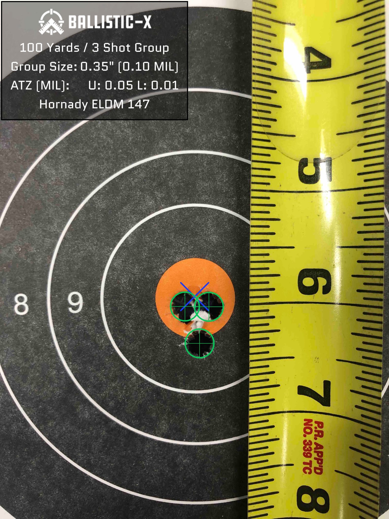

Hornady 147 eldm
when i was shooting the factory berger stuff (140g hybrids). i was getting consistent 1/4-1/3" groups.
SDs were in the low teens.
i have a photo of a .15" 3 shot group. but it's only 3 shots - so i won't share it :)

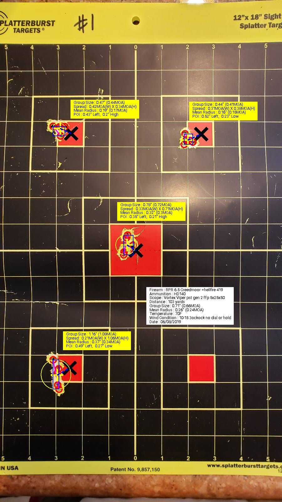

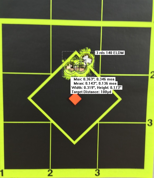

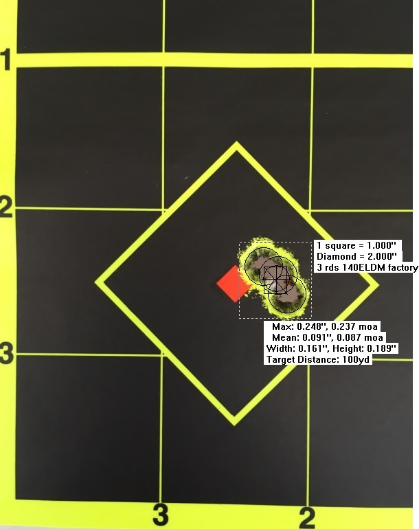

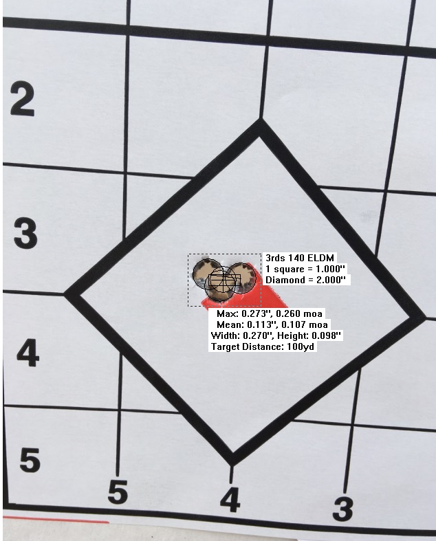

These are from January. All off the shelf 140 eldm.
Bartlein 24" 1:8.5, chambered by MHSA.
It seems to love being run very hot. I don't "do cool downs" unless it instantly burns my hand. That kind of hot.
Have a few others from last week, just didnt bother to upload in the TargetPCS. Can on request. Theyre not as tight, but still <0.5, 5rd groups. I don't shoot a whole lot, so far its only been 4 times this year. its always <0.5 if i do my part, and usually <0.3 if i really do my part. AgaIn, it likes to be run hot - funny enogh i was rapid firing last week and the groups got tighter on 3/5 mag changes lol. It's great.
Reactions: seansmd

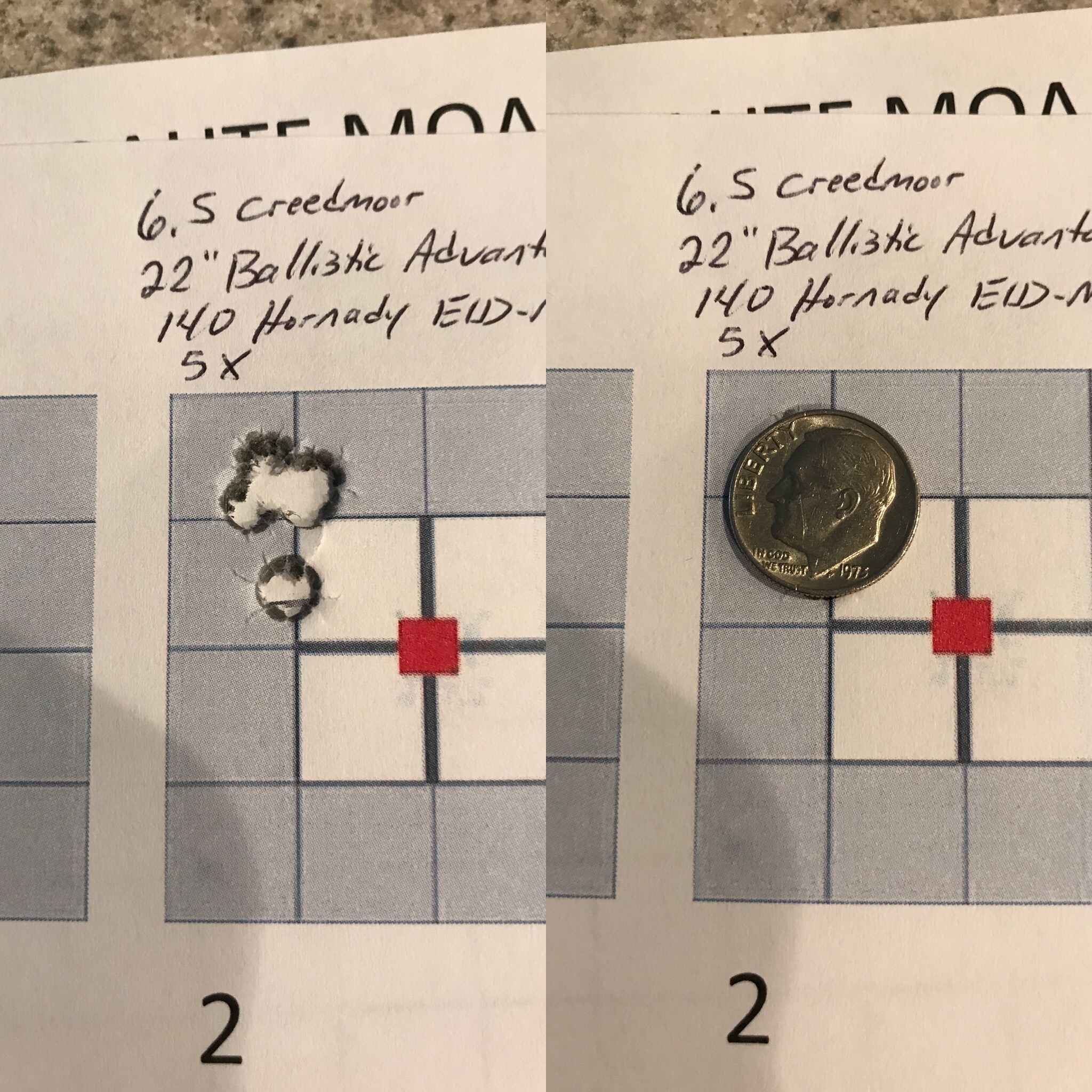

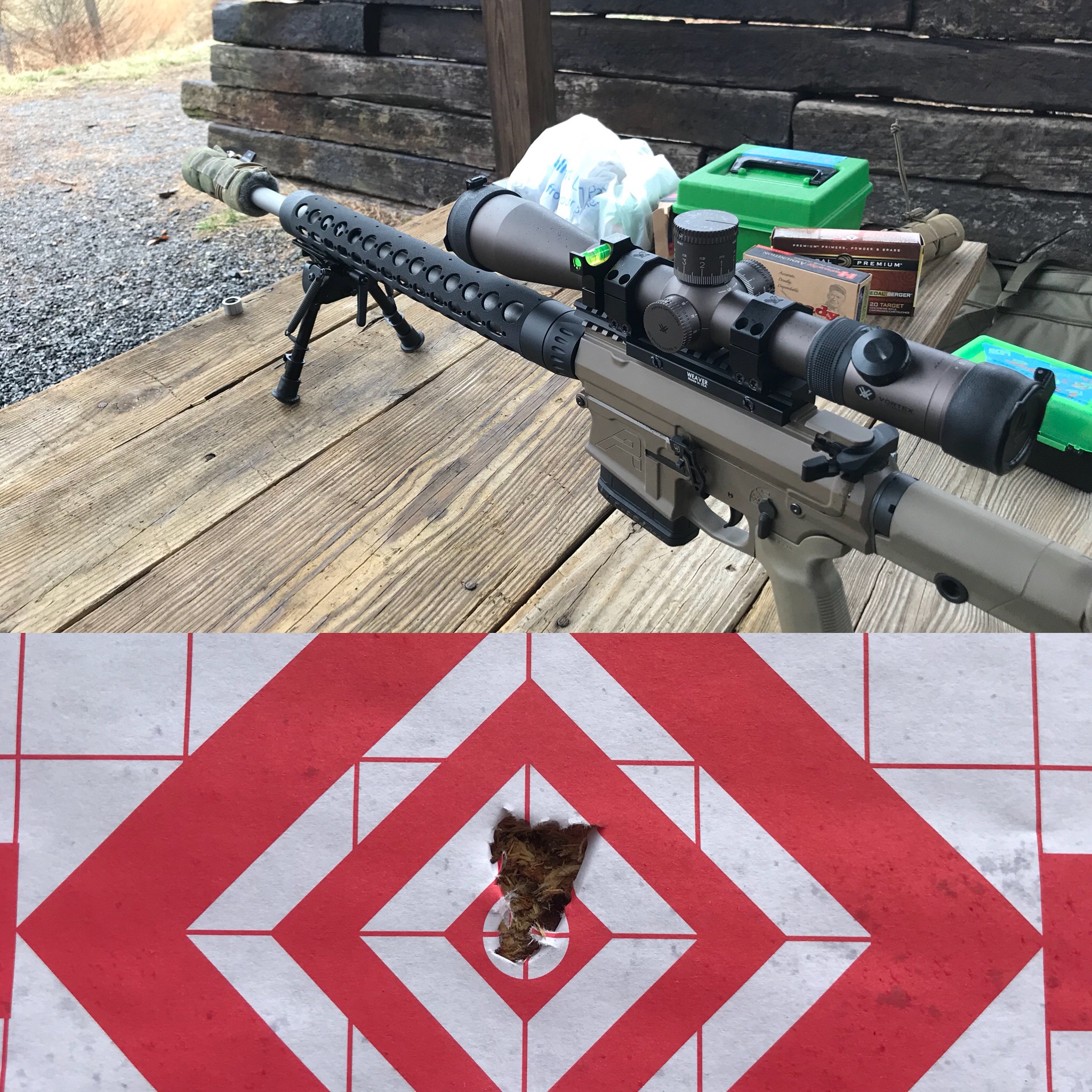

I mostly run handloads, but my LR-308 in 6.5creedmoor likes the Hornady 140 and 147 eld-m offerings. It does equally as well with the FGMM 130’s, but those run on the hot side for a gas gun. I’d expect sub 3/4moa from the match offerings, with sub .5moa being achievable with something a rifle really liked at 100yds. ES/SD will have an impact as distance increases.
7D07B80A-787A-475B-BC17-79B57BB42143.jpeg31E48C1A-A68B-40B3-A842-6931648BFB3D.jpegEAF8F87E-FD18-4F13-B69D-362E4239AC30.jpeg

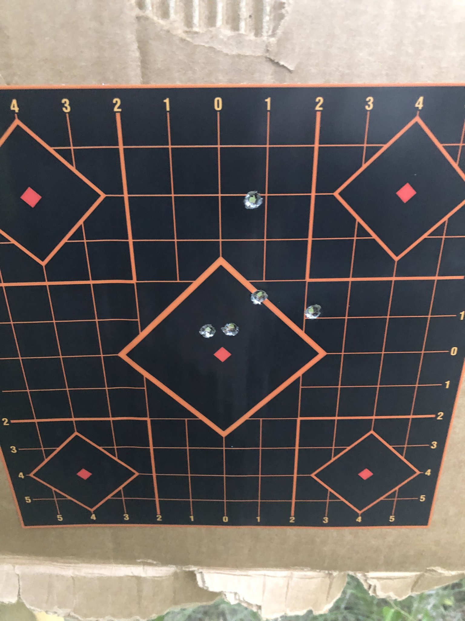

Really some solid advice from everyone that posted. I appreciate the advice. This is 140s Hornandy Black BTHP coming out of a Remington 700. I couldn’t tel where I was hitting at first reason why first shot is high my dope chart wasn’t right. Once I got my adjustment right I was back on target. (bTW 400 yards)
Ok, 5 shot groups, center was cold gun, cold shooter, then to top left, then top right all using my game changer as the rear bag. Bottom left was using my dedicated rear bag, saw more movement in the crosshair and the vertical string. I'm sending this rear bag back to get some more fill once I get a chance to try it with my new build.
I am becoming convinced I
can use the game changer as the one bag in multiple orientations based on height needed.
