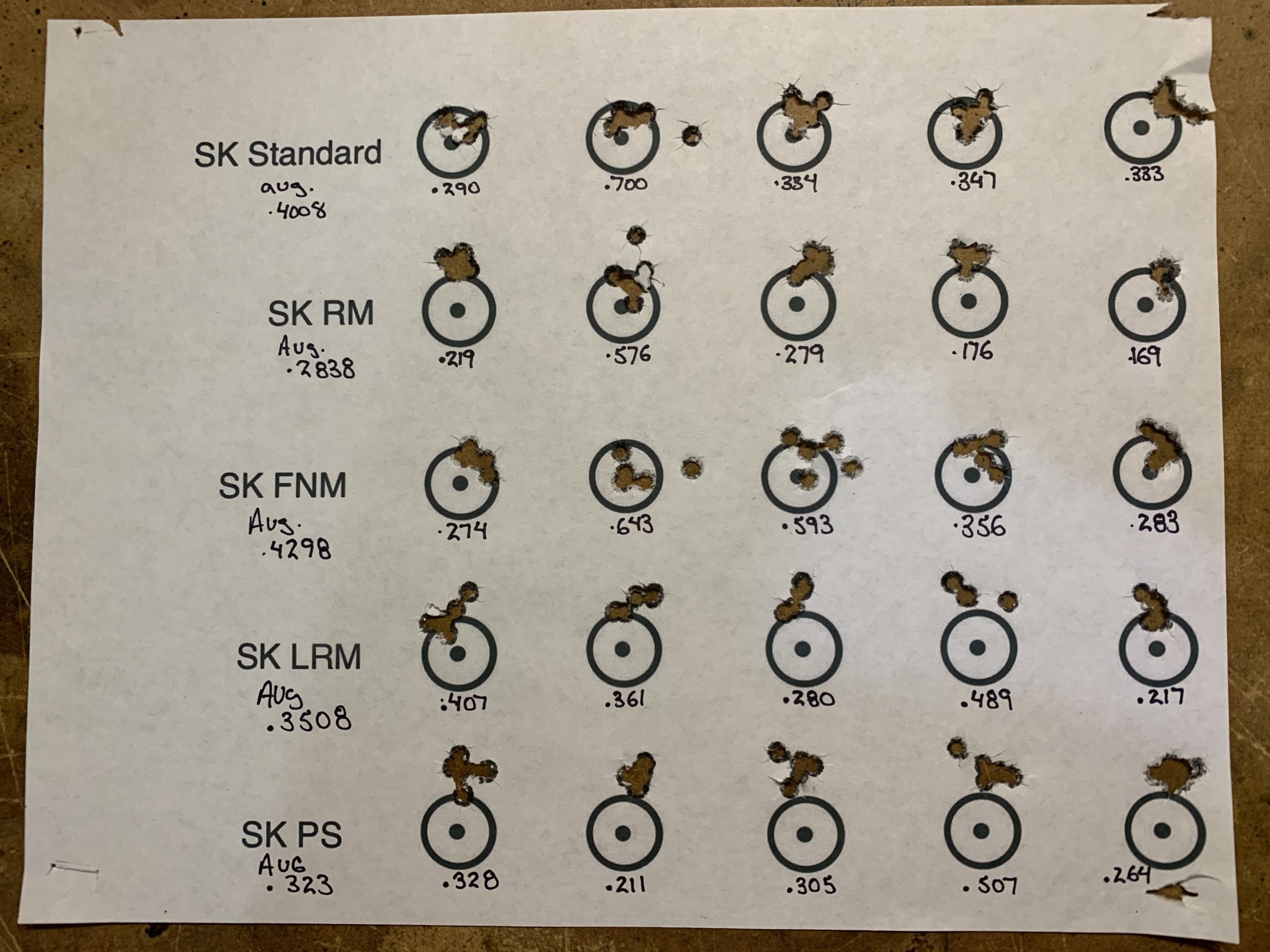

I have been doing it the same, most likely wrong, for a while now. I start with five shot groups to weed out the bad ones, then 10 shot groups, usually 2 to get the winner. If the barrel has been cleaned, the I run a few fowlers. If the testing gets into a hundred or so rounds I will run a dry bore snake, a couple of fowlers then start again. BTW I clean my barrel as often as I clean my suppressor, every 400 to 500 rounds.
Might not be the best way but I start with a clean barrel then shoot 20 Foulers. Then take my time and shoot five 5 shot groups. I run a bore snake through the barrel several times between the different brands and repeat with the foulers and the groups .

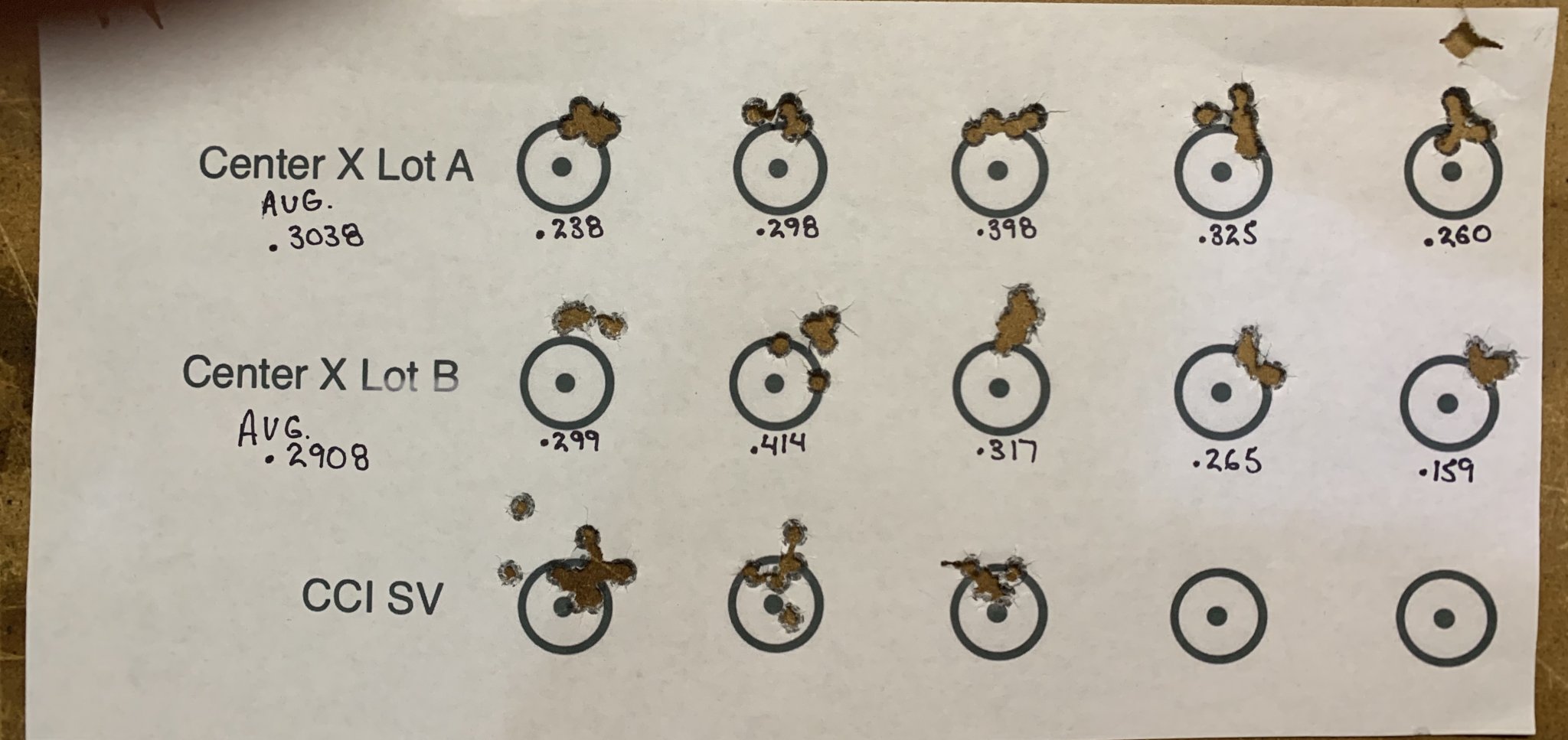

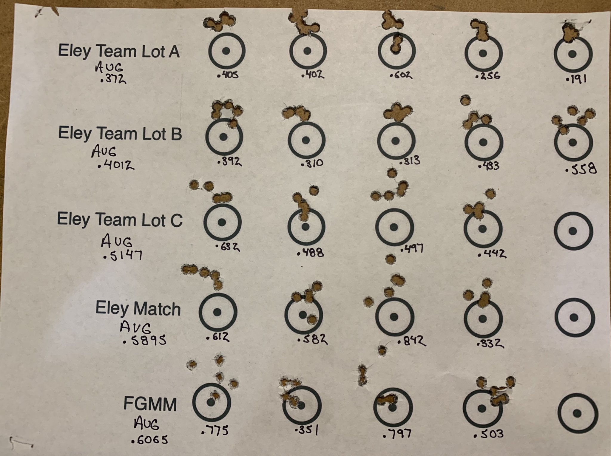

A good approach, I think. I shoot a similar screening process, using 3 reps x 3 shots each to screen the good from the not so good. I calc the individual and overall average for the ammo lot/brand. Then, for the lot/brands that shot the smallest group sizes in the 3x3, do more testing with 5 shot groups to confirm the size I can expect at 50 yards. Of there are multiple lot/brands that pass through the 3x3, then the 5-shot groups will determine which I will purchase to shoot in the rifle.
Good luck. Ammo testing is interesting and frustrating at the same time. Sometimes, the "best" ammo shoots the worst. Be sure to test on a calm wind day to reduce the variability that brings with it.

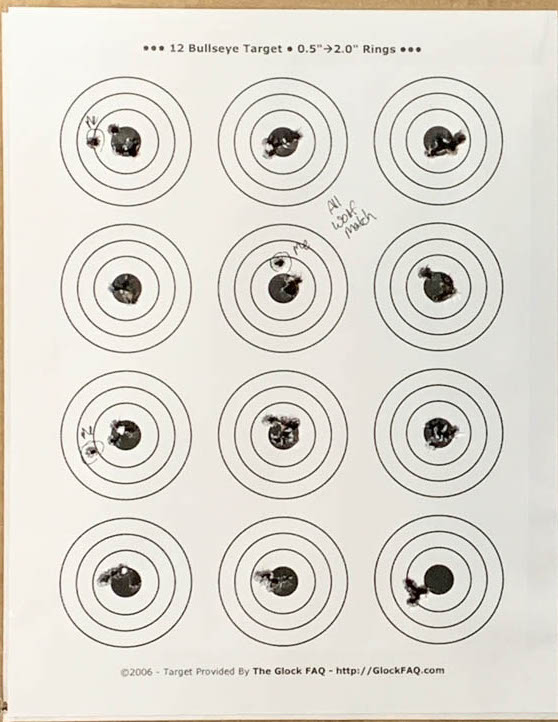

I know depending on the ammo my volquartsen can take anywhere from 5-50 rounds to settle down when switching ammo, and I boresnake a few times when switching ammo then shoot 5 shot groups at 50 yards, after 10 rounds the difference isn't huge but it's noticeable, after 50 the groups seems to settle in for a few hundred rounds. The more "greasy" lube the ammo has the longer it seems to take to settle down, drier feeling bullets tend to take less to settle into max accuracy. I've read the same repeatedly over the years on rimfire central, and we used to see it pretty commonly when I was shooting a lot of competitive 4 position smallbore. I can also say that I've noticed if I don't clean the bore between ammo types, it can take even longer to settle down.
It's pretty annoying to have to dump a $15 box of ammo but I still shoot them for groups just the first target, the second target will be the one I take seriously. I used to dump the first hand loaded round in the dirt since 10/22's are notorious for sending first round flyers but I've gotten lazy in my old age and want to get two 5 groups out of a mag to I stopped doing it. This target was shot at 50 yds, in a fairly L-R breezy day, I wasn't trying too hard to time the wind, and all the flyers are me being sloppy. I was actually just shooting a "proof" target to show a manufacturer that the 1.5" groups I was getting with their product was not the shooter :)
