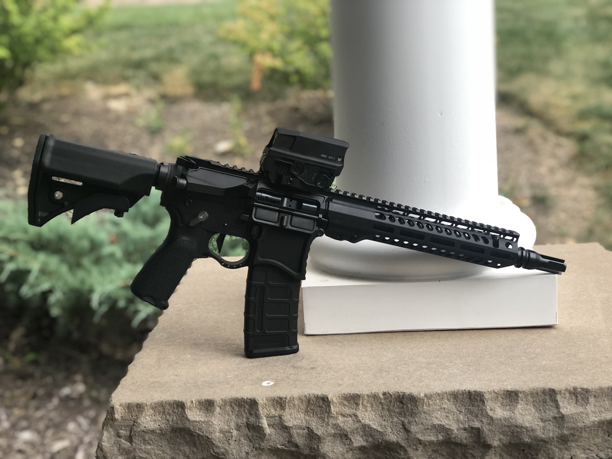

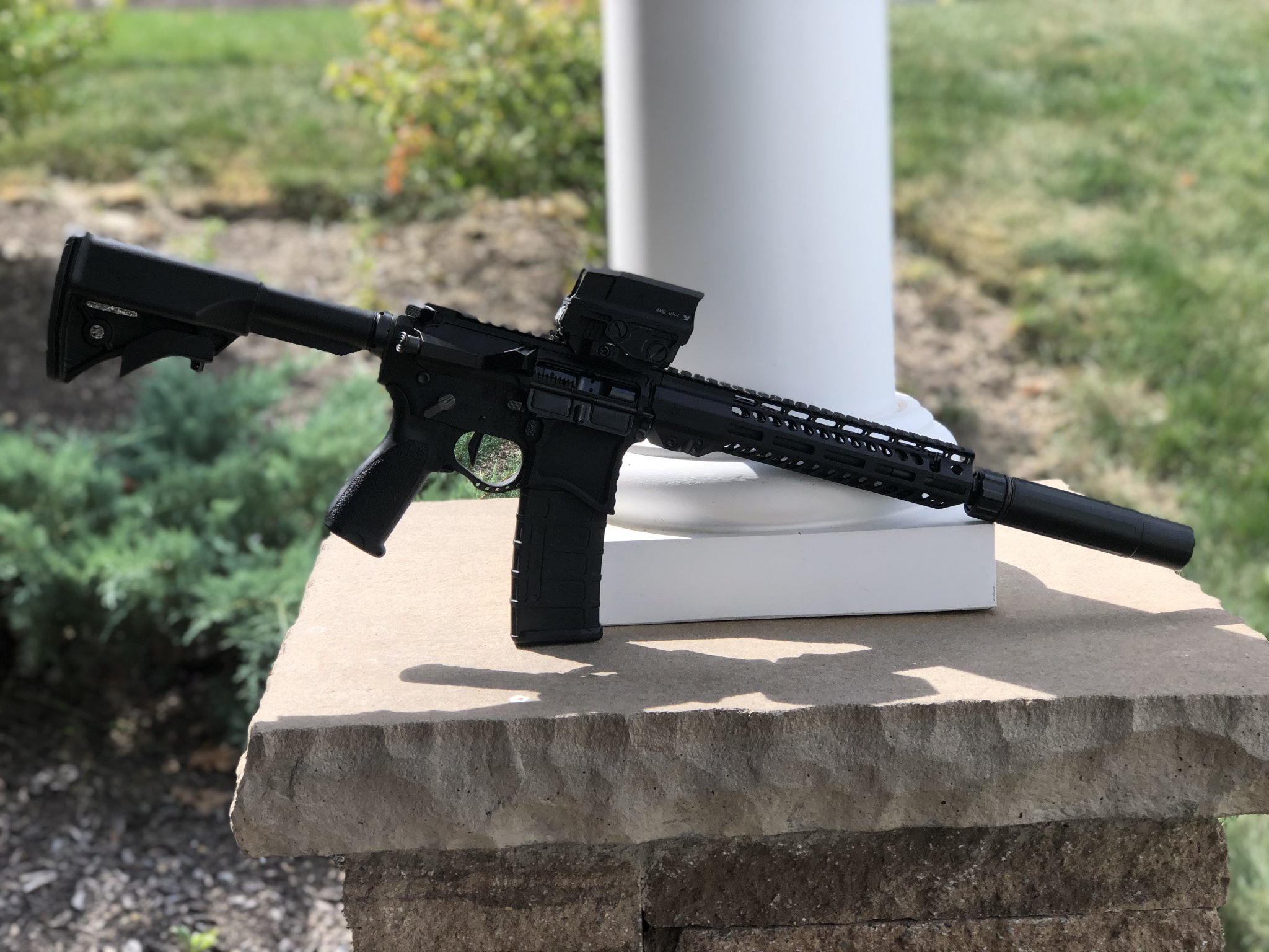

I run a 10.5” 556 on an SBR which started as a pistol. Tuned to run suppressed 100%. However never had an issue Unsuppressed at 10.5 with carbine gas system and standard buffer/springs etc

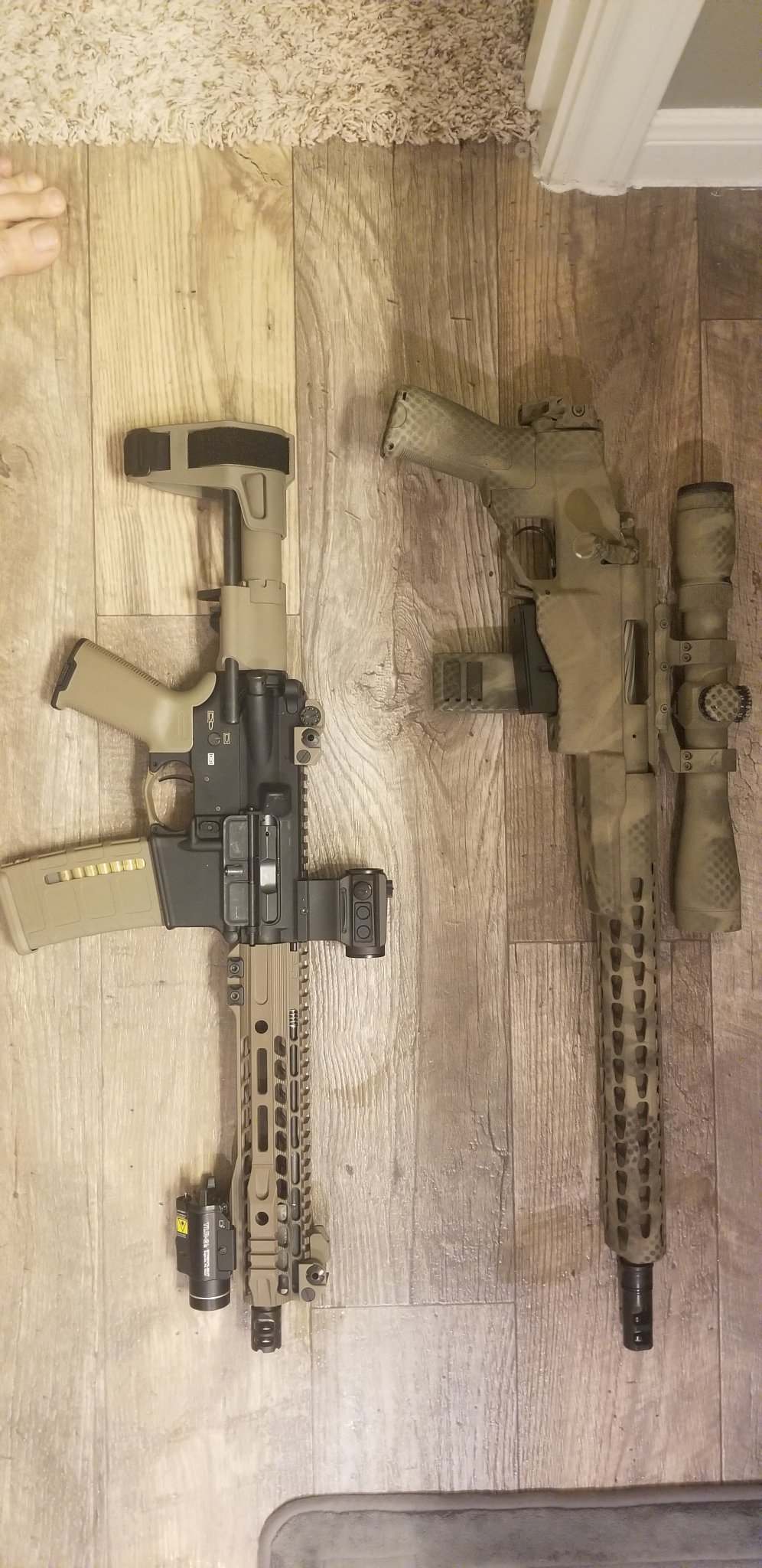

Right, lots of stuff come into play. I’m a fan of 11.5-12.5”. That being said my favorite to shoot is still my standard 16”.
side by side my 11.5” is much more “civilized” than my bu

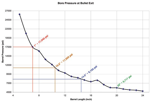

Differences between barrels
10.5" total propellant burnt 62gr SS109/M855 H335/wc844 powder 92.7%, total bullet time in barrel .000625 seconds
11.5" --------------------------------------------------------------------------93.9%-------------------------------------.000657 seconds a difference in dwell time of .000032 seconds.
12.5" barrel -----------------------------------------------------------------94.9%
16" barrel--------------------------------------------------------------------97.1%
20" barrel-------------------------------------------------------------------98.5%
Since both the 10.5 and 11.5 " barrels use a carbine length gas system and the port is in the same location both have the exact same port pressure, the only difference is .000032 seconds of dwell time. That is 3 /100000 of a second.
