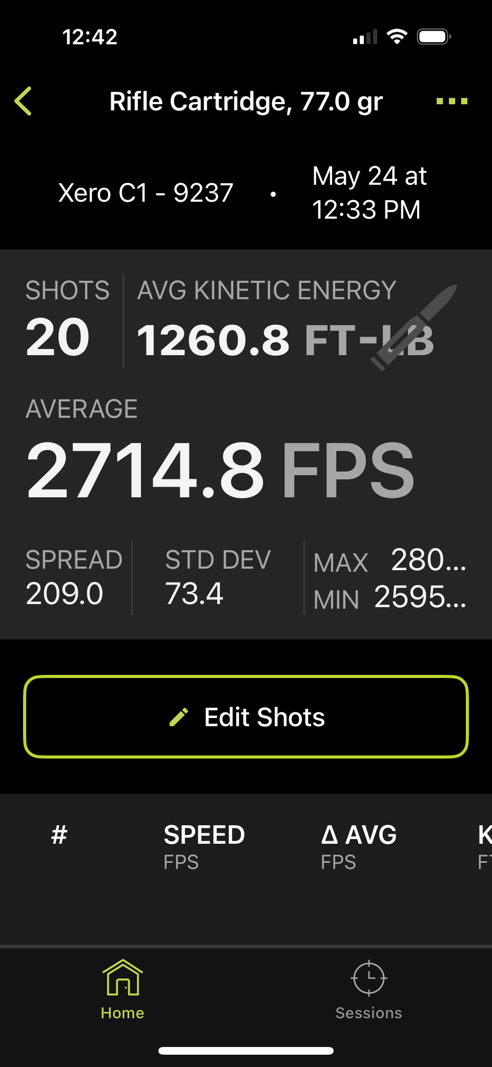

21 shot group with AAC SMK 77gr. Didn’t blow my gun up and that was the first group from the barrel. I’m betting it would be better with some better match ammo. ES was crazy. Barrel is a BA Spr 18”
Reactions: bfoosh006
21 shot group with AAC SMK 77gr. Didn’t blow my gun up and that was the first group from the barrel. I’m betting it would be better with some better match ammo. ES was crazy. Barrel is a BA Spr 18”View attachment 8701527View attachment 8701529
I'd say you certainly got your got your moneys worth.
Is this the "2700 FPS" load, or the "2550 FPS" load ? .. I couldn't quite tell from your chrono numbers.
