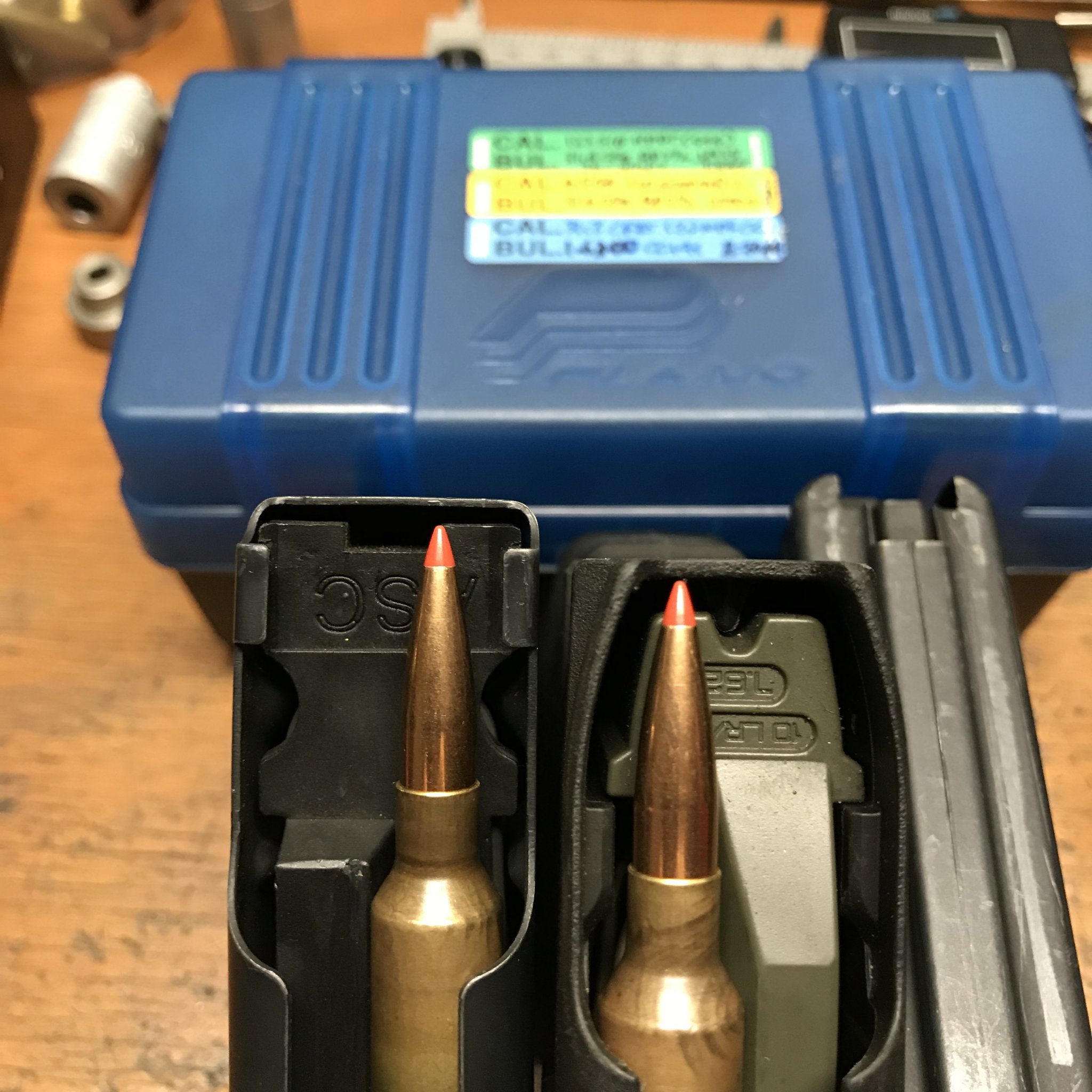

ASC allows me to get cleanly to 2.86+ with room to spare. Magpul max below 2.82. 39883145-6082-4167-8D0B-5AE0C041C685.jpeg
ASC allows me to get cleanly to 2.86+ with room to spare. Magpul max below 2.82.View attachment 6967183
is that the standard Magpul or the M118LR version? Looks like I might need to pick up some extra mags depending upon how the load development goes. It's always nice to have some options, plus it might be easier for ammo management- plastic mags are 150gr stuff, metal mags are 175gr.
I did something similar with 5.56/300 and got some of the colored hexmags for the blackout rounds so it was easy to identify different calibers that could potentially be mistaken.
To be clear, rounds above are same OAL, pic shows difference of each in std Magpul and ASC mags. I also do as you to segregate rounds designated for specific rifles via use of different mag manufacturers. Leaves nothing to doubt.
Reactions: SpeedyR
Any issues with the ASC mags? I've read they don't work in some rifles (I have a PWS MK216), or might need some light modifications to work. The extra internal length would be nice without spending $100/mag. :)
and thanks for the clarification, the two looked like different round OAL.
I run the ASC’s in Black Rain upper/lower receivers in 6.5 CM. No issues with 107 Sierras through 139 Scenars/Nosler CC’s/AMax or 140 Hornady HP’s. Generally limit rounds in mag to no more than 7-8, but they’ll take 10. I’ll reconfirm OAL’s, this having come from a post about 6 months back on same subject.
