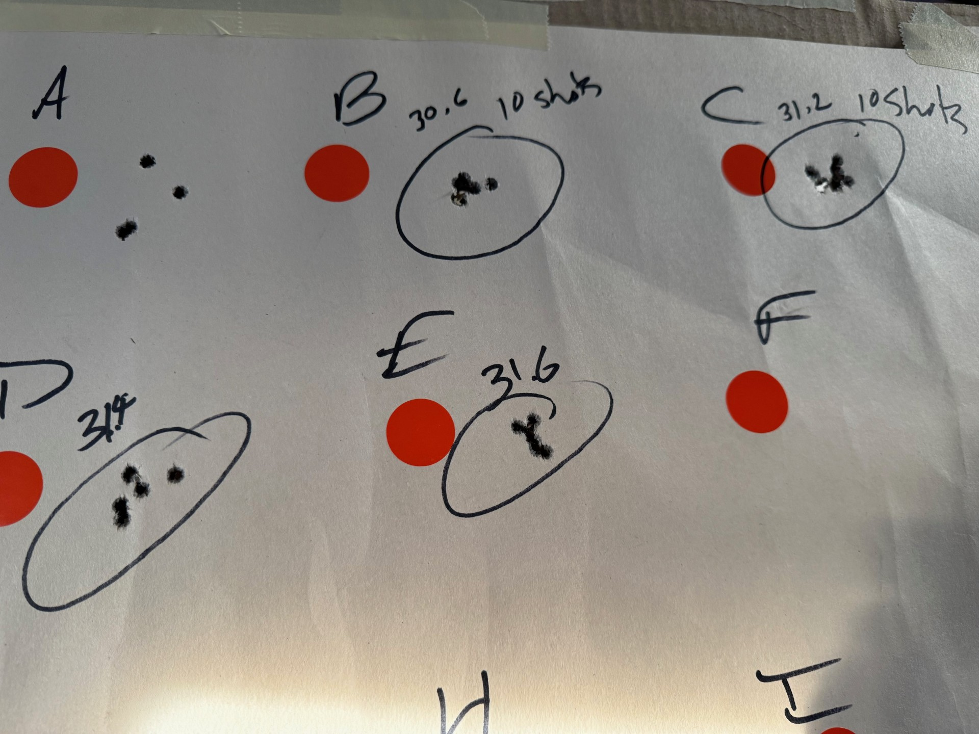

This pic is from the second step of load development I did yesterday. I'm trying VV N540 in my 6 BRA. I did a ladder earlier in the week and this was a combination of initial validation of a couple of the best possibilities for charge weights - 30.6 gr and 31.2. 30.6 won out with 8 of 10 shots being in a sub-quarter-MOA group. The one out to the right was likely me. You can see that 31.2 didn't group as well - though it could probably be brought in with seating depth - but it also didn't deliver the same SDs. 30.6 delivered 4.2 fps over the 10 shots. I also went a little higher with charge weight, which I didn't do earlier. Neither looks promising, and 31.6 got me heavy bolt lift.
The only negative with 30.6 is that it's a little slow at 2852 fps average, but I'll likely stick with it for now because it performs in all other regimes so well.

Sure, I can get 5-round sets with single-digit ES. But, like somebody showing you a single .25" group without showing the other ten or twenty 5-shot groups fired over several sessions, the unicorn groups or ES/SD values don't mean squat.
Truth! I typically measure/compare ES/SD in 10-shot strings, over many sessions to see if they stay consistent. I shoot 5, wait a few minutes for the suppressor to cool until the mirage settles down (338-class cartridges heat the can up fast), and then shoot the other 5. I write down the AVG, ES, and SD for the first 5, and then again for all 10. I can't tell you how MANY times I've seen the first 5 have a stupid-low SD, only to turn into "meh" after the next 5. If I went by the first 5, I'd be kidding myself. And 10 isn't enough either, but I look at multiple strings of 10 over multiple sessions to see if it's consistent.
Truth right there. Got a 8.2 SD on first 10 shots. Went back a few weeks later to confirm with the same load from the same reloading session and got 3 more sessions of 15 SD. Combined data of 45 rounds over 4 sessions SD of 15, all loaded at the same time.
