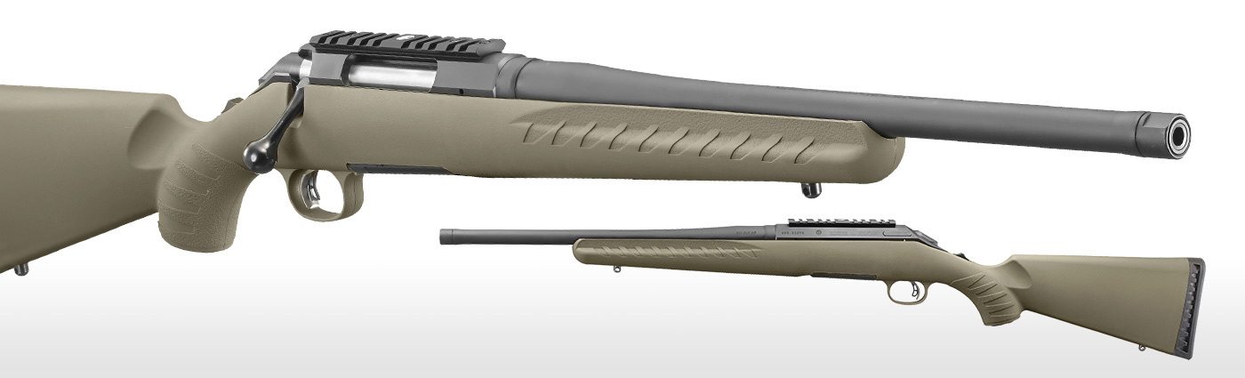

Hear, hear! I'm waiting (though not so much patiently) for barrel makers to start offering sporter contours with flared/belled muzzle ends for that very purpose. Similar to the Ruger American Ranch: http://www.ruger.com/products/americanRifleRanch/images/top.jpg
