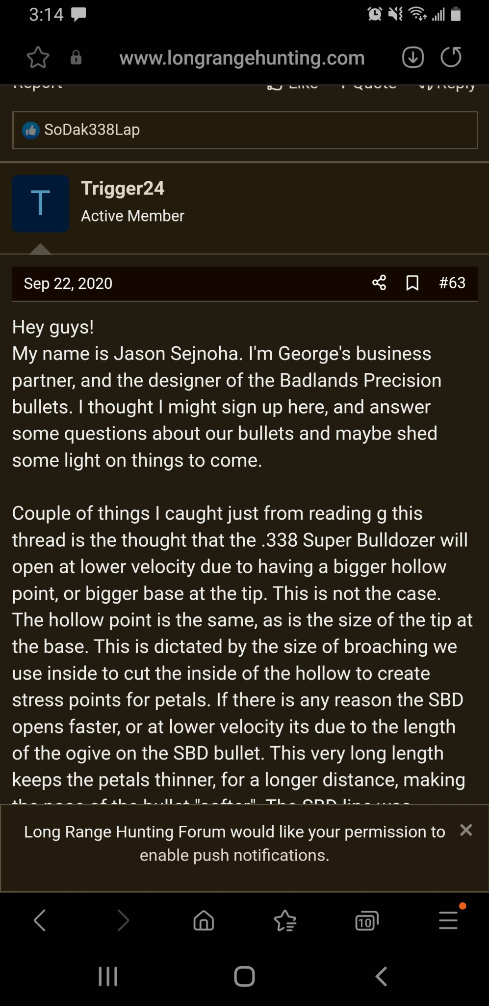

    No one is going to mention the co-founder and designer of badlands bullets being indicted and convicted on child p**n charges?
    They won't see a dime from me.
    Wrong jason was not the owner of badlands. he was a employee. George was 100% the owner . He was a co designer
    Reactions: hohlspitz
    No you are wrong. And defending a convicted peice of shit.
    I am not defending jason I am how ever defending the truth. George and Shirley is 100% the owner jason never had any financial investment on the company. The purchase of the building the equipment , copper business license , ffl, all in george and Shirley name . Jason was a employee collected a paycheck. His comment on that post was un true. George and jason worked togather on designs. That's way Jason's name was on patent. . I have personaly seen all the paperwork. License and ffl. Jason's was not a vested owner or partner. Like all innocent till proven guilty. Once convicted he becomes scum. . But he was a employee it was no reflection on the owners George and Shirley who are wonderfully Christian people.
    I am not wanting to attack or defame the other owner in the company,
    But if you mean to tell me that a man whose name is on the patent, co-designed the product, and publicly claimed to be a business partner, is not receiving any royalties from the product he owns the patent on, I will have to say I dont believe that and personally will not buy a product that would be supporting a man who did the things he did.
    Also, there is no innocence, he was already convicted and sentenced to 15 years.
    In my eyes thats not an adequate punishment.
    again i dont understand why you would defend someone like that, you say you aren't defending him, but then say innocent until proven guilty?!
    Its been proven. Do the research.
