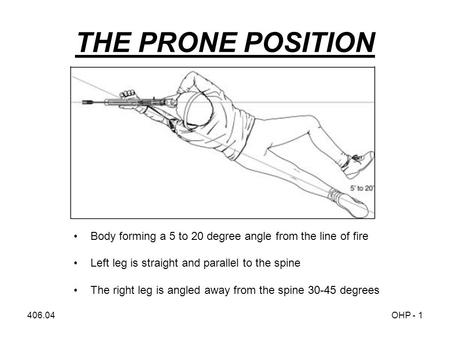

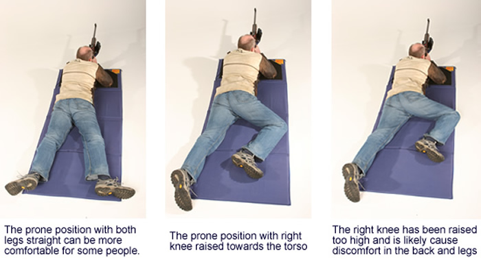

Yes, you want as much of your body in a straight line behind the rifle as possible to manage recoil
A lot like this
Now because of body mechanics, you’re always going to be at a slight angle....
But what you want to avoid is a situation like this.... despite what the official looking graphic says
A lot like this
I agree,, but.... I know of a guy that shoots angled and can shoot a clean 40 round match. Maybe it's because the position was more for small bore.
I read that the right leg angled keeps your heart slightly higher of the shooting mat, and also the position produces less fatigue.
I have personally shot .22 very well angled. But .308 and above I always was more consistent straight behind.
