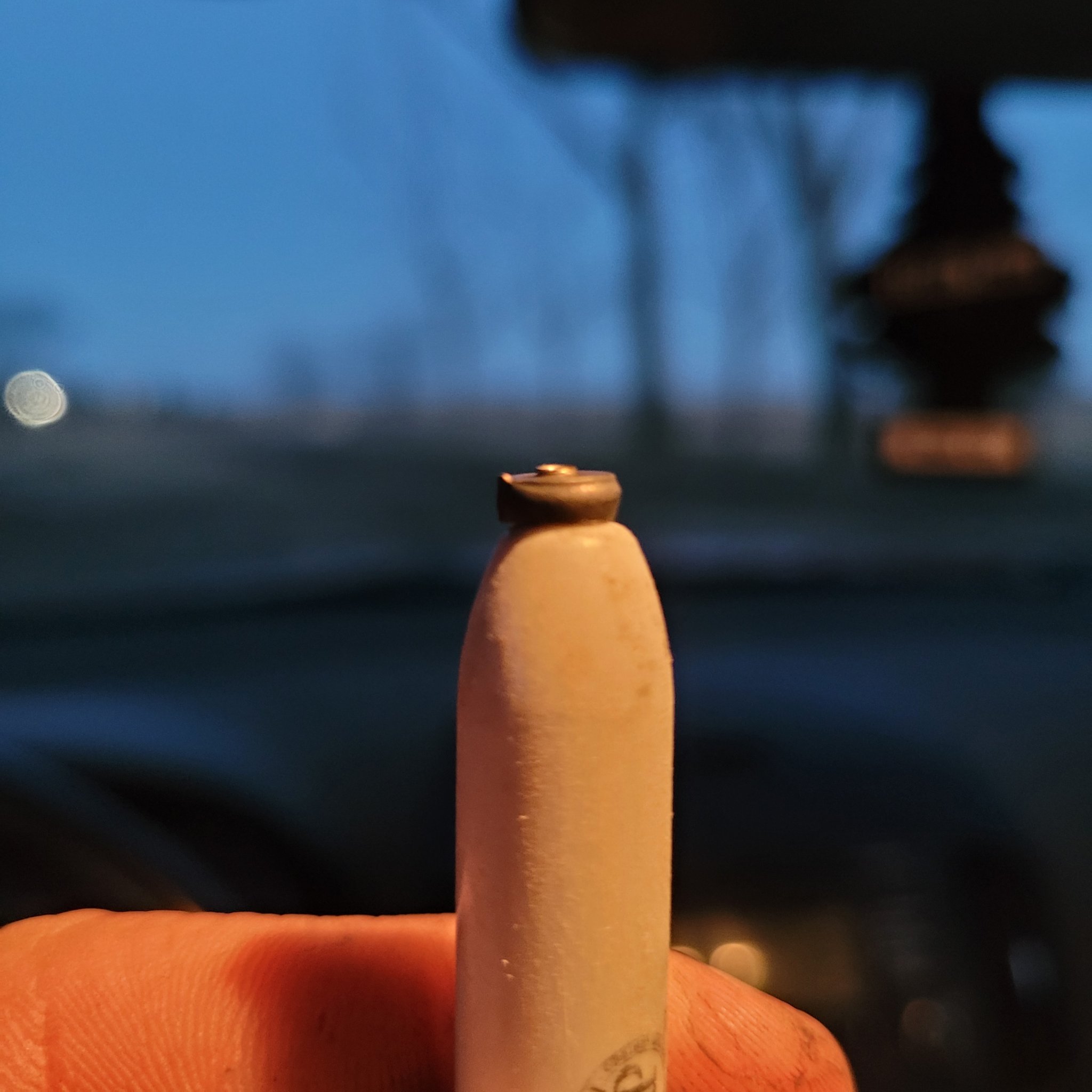

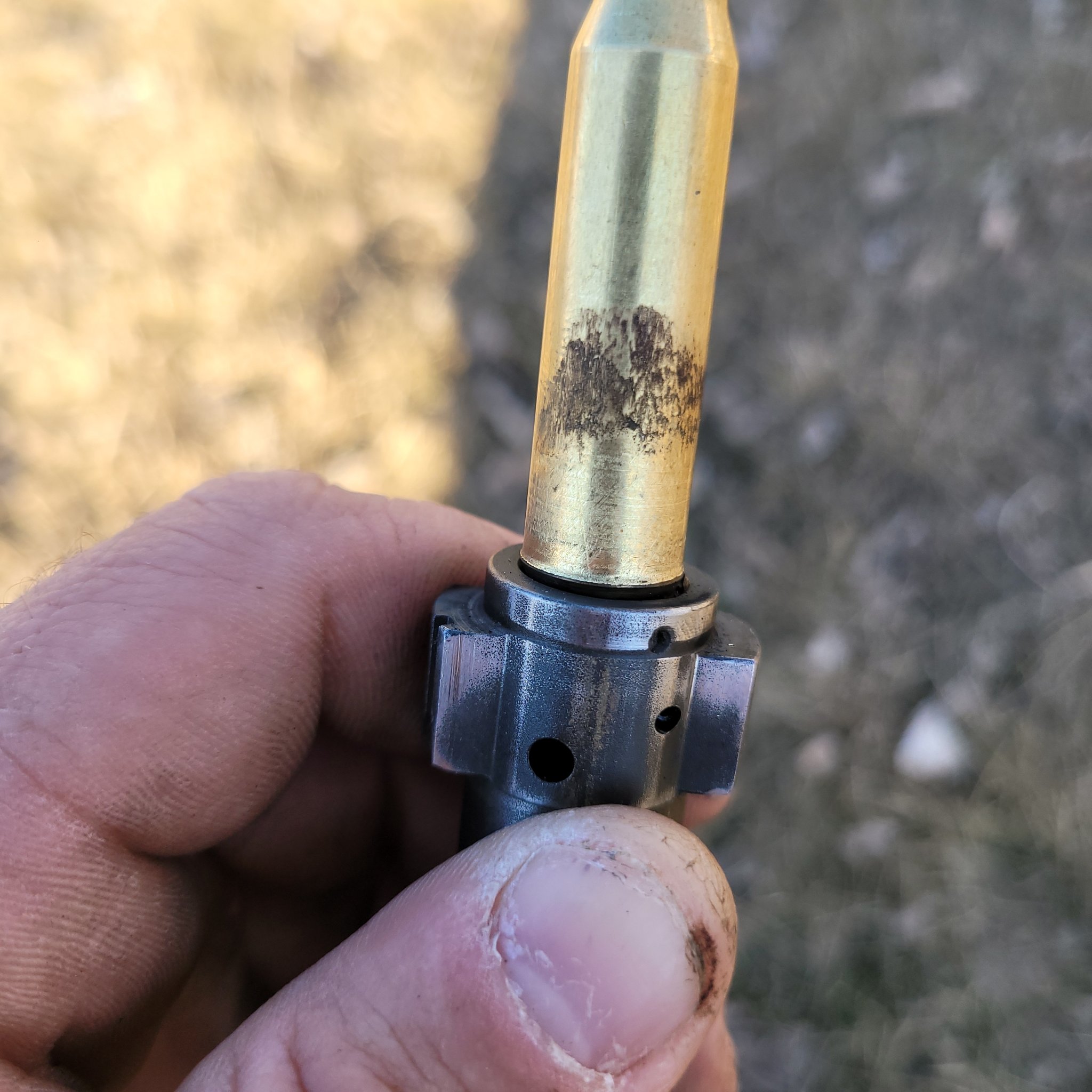

Could not lift the bolt. So wacked it with a mallet. Could not pull the bolt back, so wacked it with a mallet. The case was stuck to the bolt. View attachment 7831291
Could not get the case off the bolt until I tapped it a bunch on the table.
View attachment 7831292View attachment 7831298View attachment 7831303
The primer went flying the moment I got the case unstuck from the bolt.

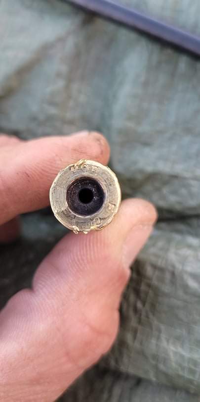

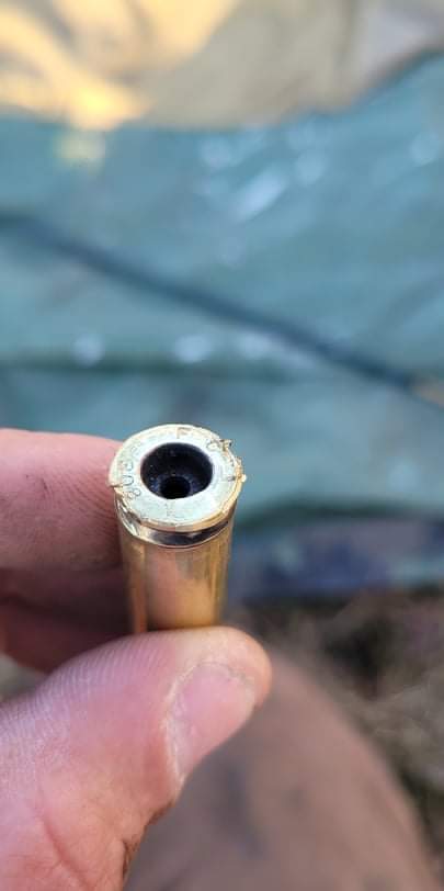

The flash hole seems to be twice the size of normal.View attachment 7831294

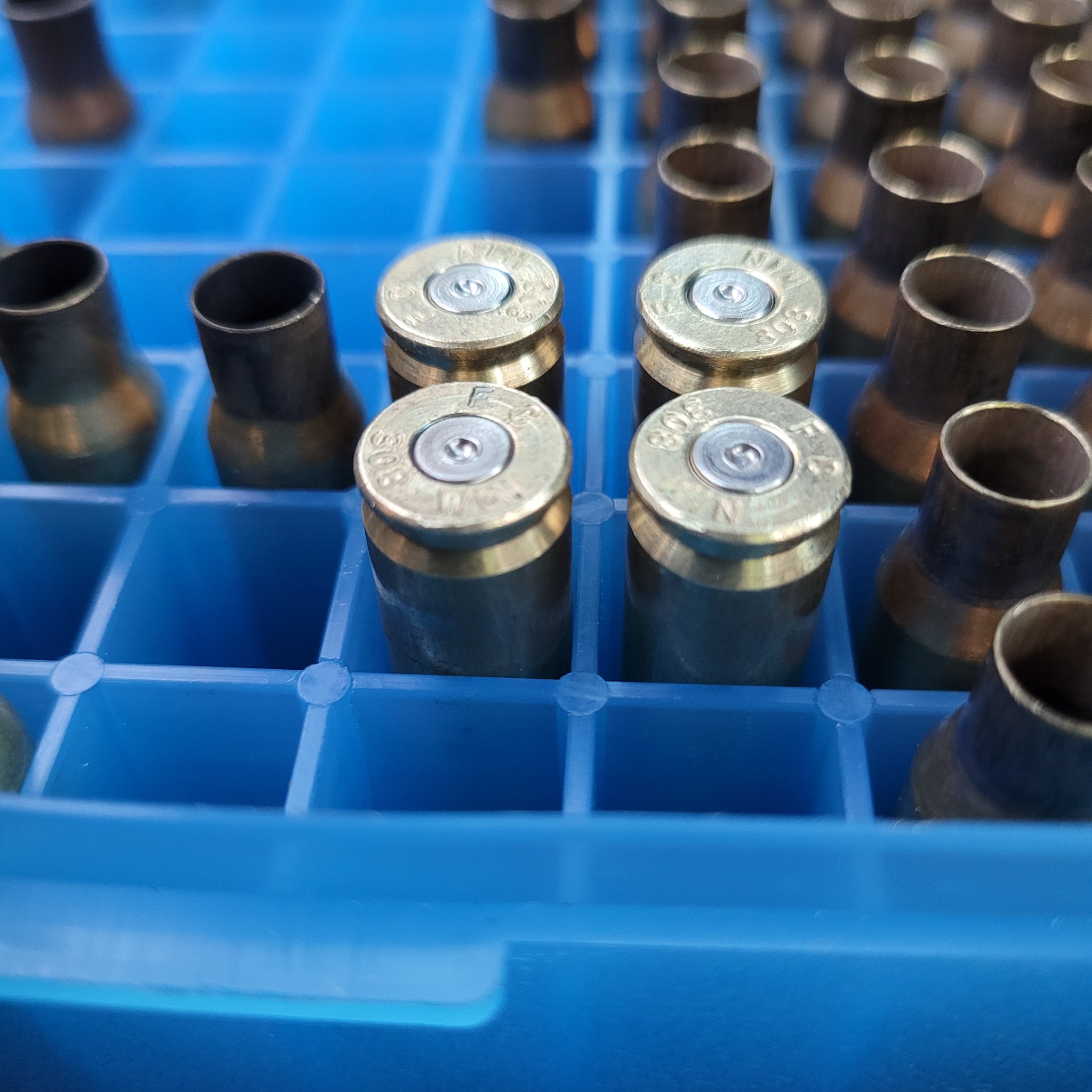

The top two rounds in the next picture were 45.4 the two below were 46.6
I always get cratered primers on most non military primers. So I don't really use that as a sign of pressure. And the primers still have a radius. View attachment 7831297
