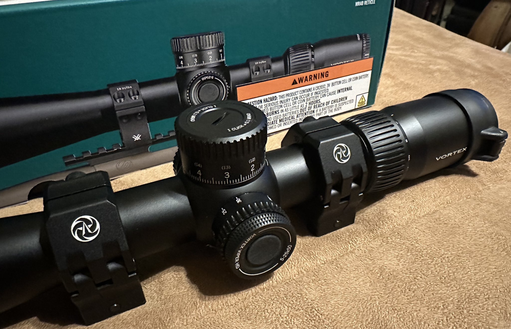

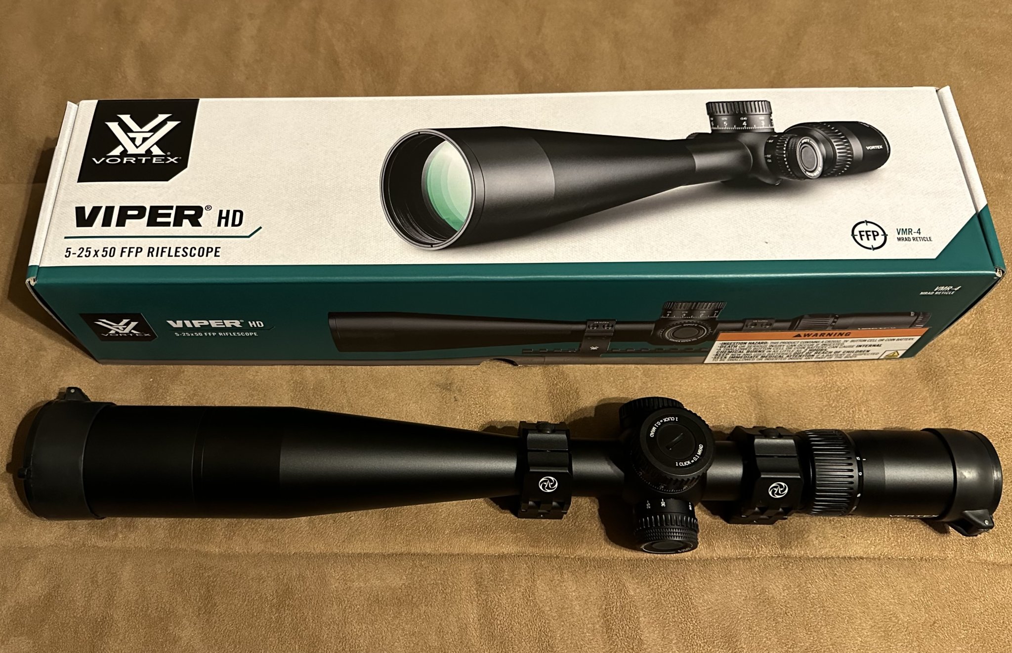

The new Viper HD 5-25x50 could be a good option, but not many reviews out for it yet.
