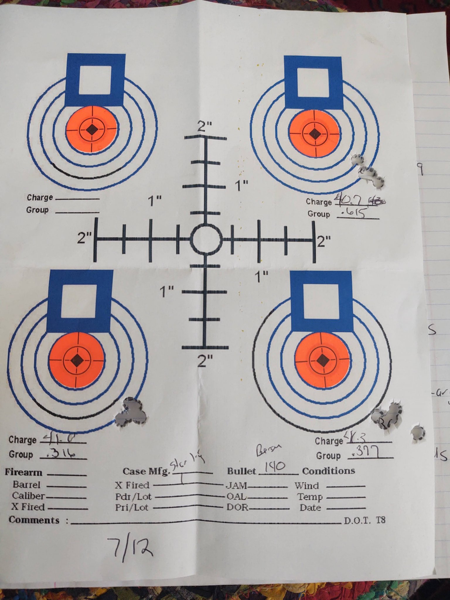

Here is 3 five shot groups at 100 yards all under 1 moa while working up loads for my 6.5 CM.

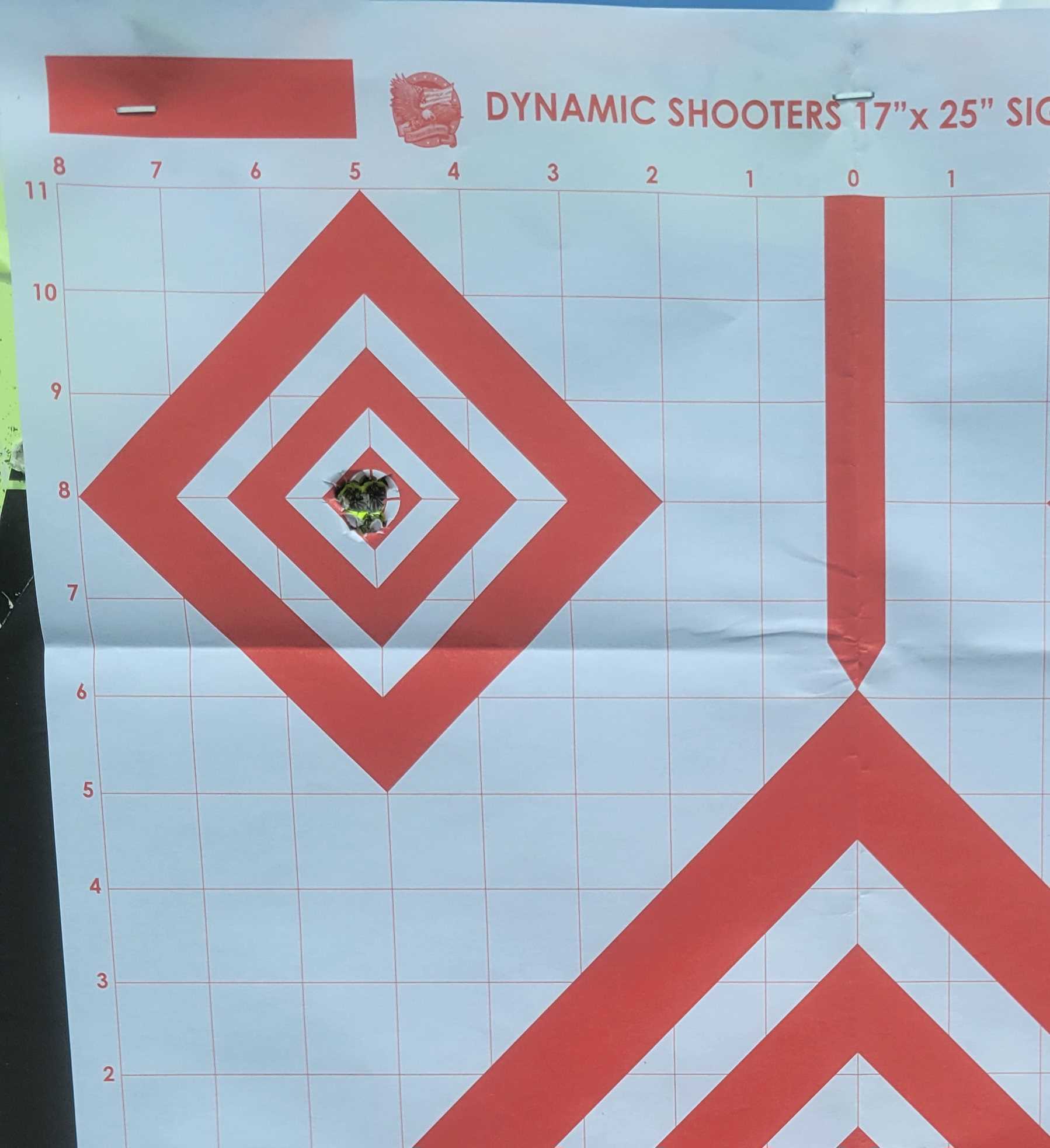

OK, posting target pictures, a favorite internet pass time, here's my little wife's one shot group :)
came from 11MOA @ 600 to recheck zero @ 100.
(1/8 MOA off to the left)
Got 3 things going against her,
Girl, 22 Nosler, Savage Model 10 :)
