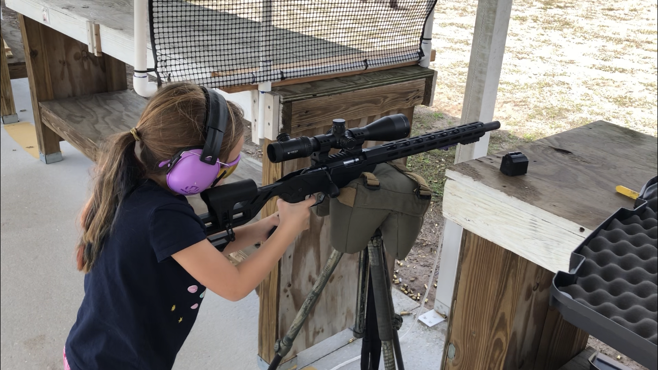

My 7 year old loves her RPR rimfire, and the quick adjustments make it fun for me as well.
The bolt was/is tight, but it has smoothed out with some help from a dremmel/polish,
The ejection was iffy because the spring holding the shell against the ejector wasn’t aligned the right way, so i fixed it

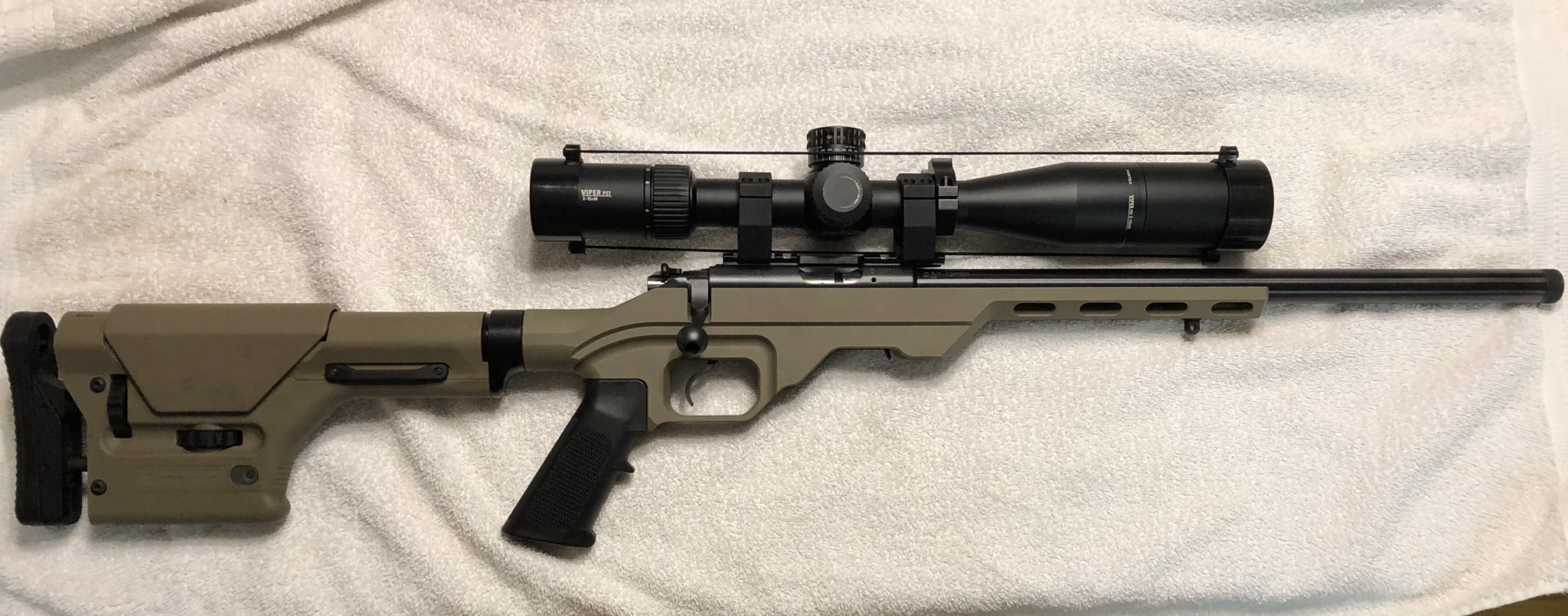

If you are interested in a CZ 455 "Tacticool" with YoDave trigger kit in an MDT LSS-22 chassis with Magpul PRS buttstock, I will be putting mine on the market in the next couple of weeks. I can sell it with the chassis or the original Boyd stock or both. It's a consistent 0.5-0.6" performer at 50 yards with the old Lapua-produced Wolf Match Extra (SK Rifle Match). Slightly, just slightly, less consistent with CCI SV.
The optic in the photo is a Gen-2 Vortex Viper PST 3-15x55 in Vortex/Seekins rings on a 20-MOA DIP rail. I'm quite willing to sell it all as a package deal, but the scope is MOA and SFP - a double whammy for many people here.
PM me for more info.
The ejection was iffy because the spring holding the shell against the ejector wasn’t aligned the right way, so i fixed itView attachment 7027065View attachment 7027066
Classic- you are sick as the rest of us.. A $350 RPR rimfire with a $500 CKYE pod!
Nice work on getting your kids out there... it will be a flash and your shooting buddies will be off to college—- great photos
Thanks, the ckye-pod is mine, but she is trying to steal it because the Harris is “stupid” and can’t go the that perfect height that she needs
