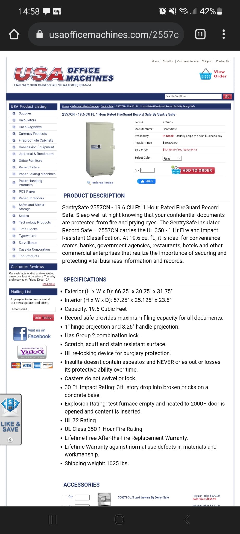

It is worth the time to read the articles completely....No “gun safe” has a UL protocol fire rating, Sturdy Safe did once at a great cost. TL30+ safes with Class A fire rating are available, look for an used one. Bought and paid for testing other than Underwriters Lab test protocol can produce whatever numbers you pay for. UL lab certified does not mean, UL lab fire testing protocol. Request container fire testing documents to compare to UL fire protocol, this will weed out 99.99% RSC. There is a reason they are called a container not a safe. Just ask your insurance which safe they will accept for the coverage you need.
Determine if fire, theft or both is your concern, go from there...

For $500 + $800 shipping from the safe warehouse in NJ to TX I got a used Schwab FireGuard 2557 document vault with a UL 350⁰ 1 hour fire rating, Sargent & Greenleaf Group 2 lock with a relocker should it ever be drilled. Its from the 80's I'm sure, but last I checked safes/vaults don't have an expiration date. It's 1300# empty. You can find them new for about $5k. Called my insurance company and told them. It satisfies all their requirements for both security and fire.
Here's the current iteration of my safe.
