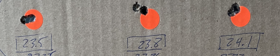

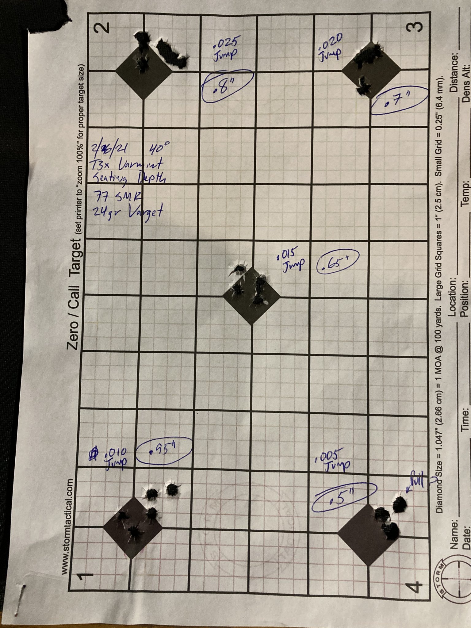

This is my Tikka in .223 with 77SMK's with 24.4 grains of Varget. (Work Up to this).
What seating depth are you working with? Berger says jam the VLD ten thousandths and work out. VLD's are notoriously difficult to tune the seating depth on (that's why they have the hybrid now).
I would encourage you to load from 23.0 up to about 24.7. Find your lands and jam 0.010. Understand that this will cause more pressure than being out of the lands so look for those pressure signs early. If you are still having issues, then switch to a 77 SMK or 75 ELD. The throats are so short on the Tikka's you will not be able to run 80's.
Powder valley has 77's in stock right now. As does midway. Also, the 77 Grain OTM Berger would be worth a shot.

Whats your coal with 77 smk ?
I sold that rifle some time ago. So I do not recall. I think I started 10 off and never moved after shooting this.

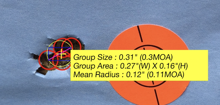

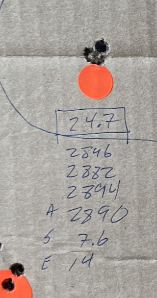

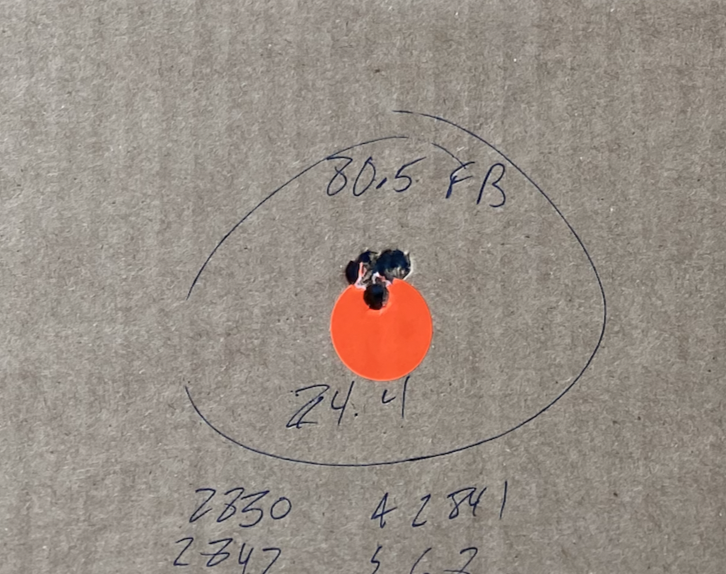

I moved on to a 28" .223 Impact. It loves 80.5 FB so much it's hard to pick a load. On this rifle, I used the cortina seating method.

I will say this, my new rifle hated 80 ELD's. I've mentioned this elsewhere on the hide. I mean it absolute hated them. It was so bad I started to doubt my own ability to load and shoot. I happened to try some 80.5's I had laying around an they work just fine. I also have 77 SMK's, but they are dedicated to other rifles.

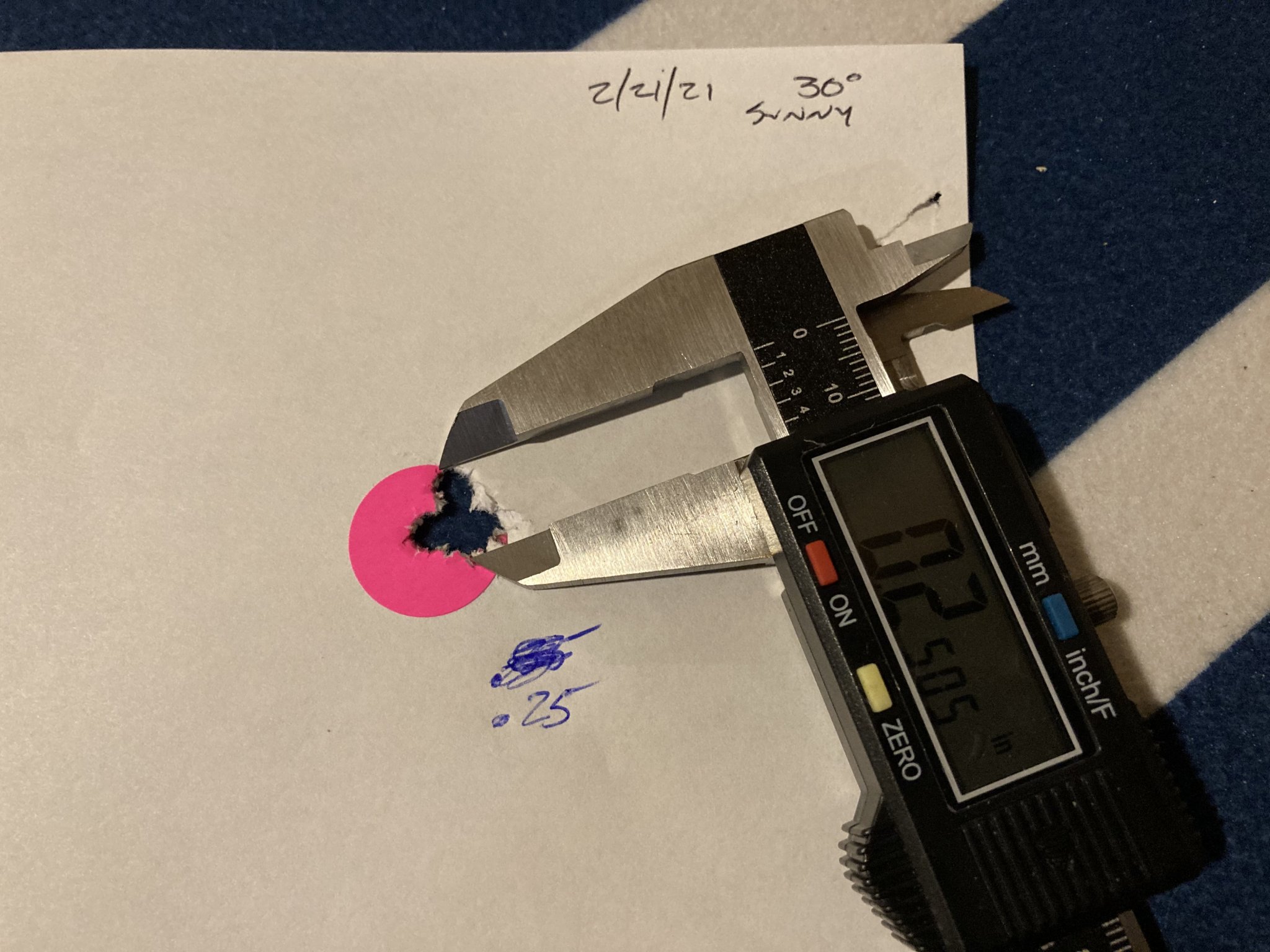

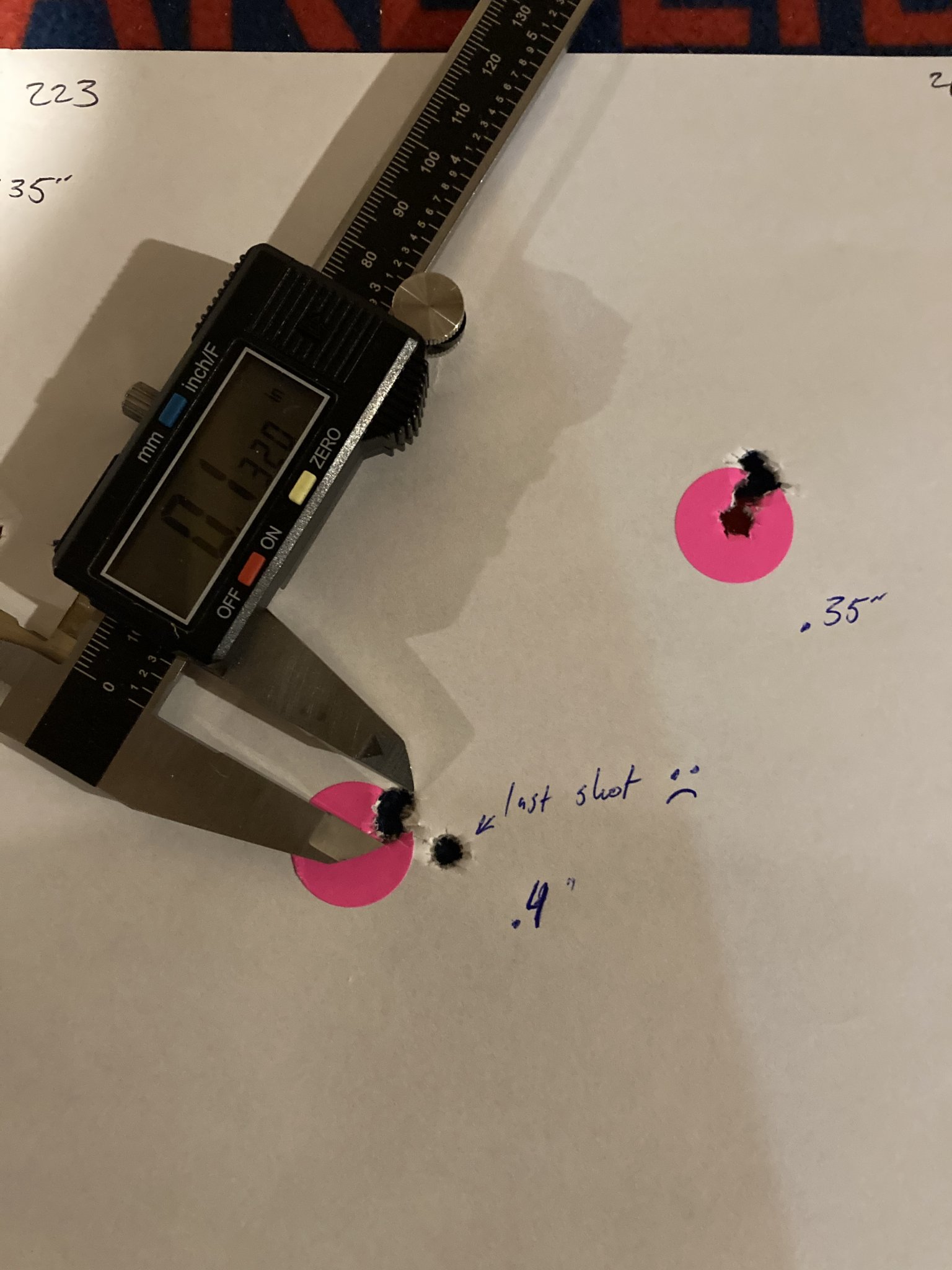

I had a T3X Varmint in .223; it never did worse than 3/4" @100 with any decent load I put in it (that doesn't include 55 grain bulk ammo, which might spew 1-2" @100). Factory 69- and 77-grain SMKs were typically 1/2" plus or minus a tenth at 100; handloads with same bullets did about the same.

I just finished load workup on one of these I’m running 24gr of varget in LC brass with 77smks. After seating depth it ended up liking 5 thousandths off the lands the best but also showed promise at 15 thousands off. All targets are five shot groups. I have no experience with the Berger’s but will say that mine seems to like the SMKs.
