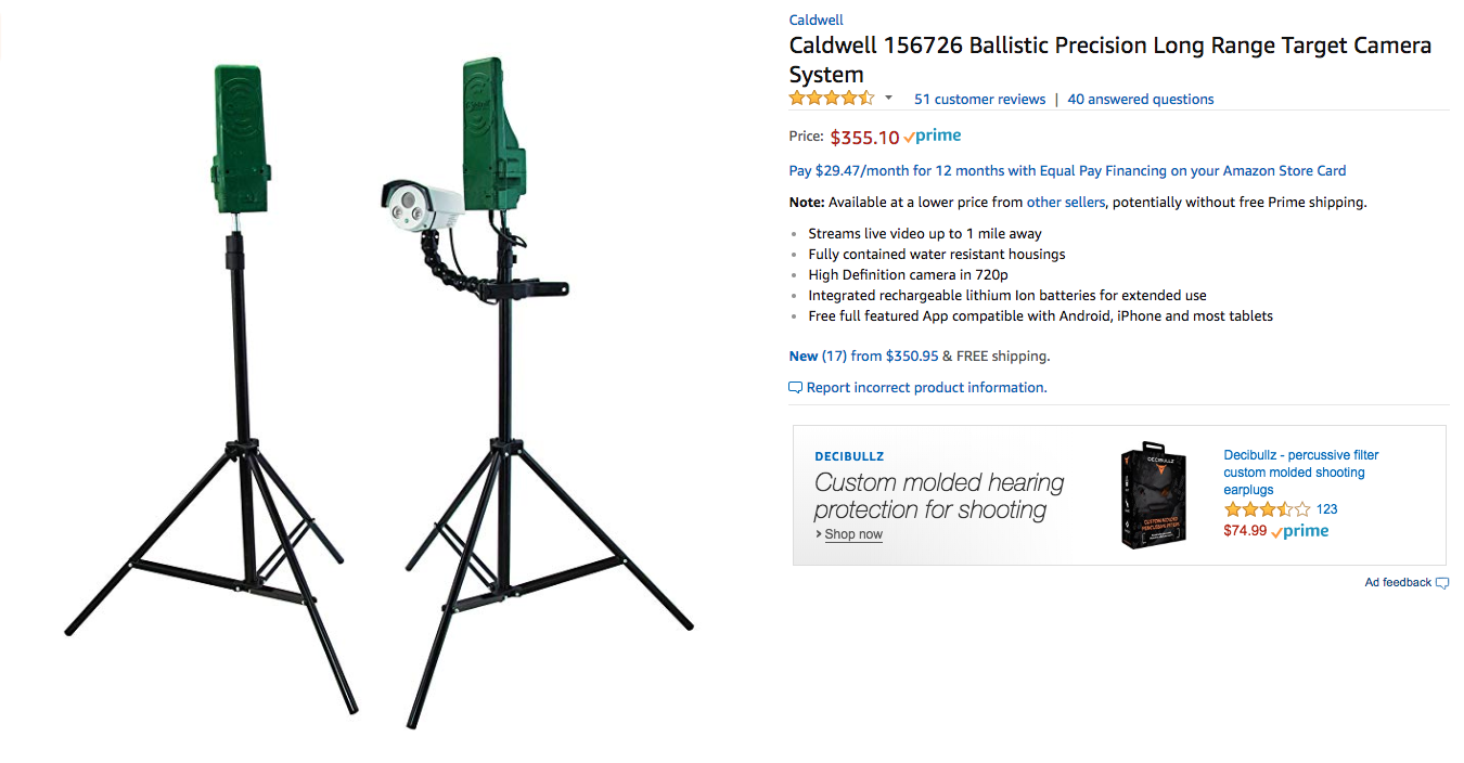

I have one of the long range target cameras and it's awesome. For static paper punching I won't ever buy another spotting scope. I've been told you can DIY one for cheaper but I went with the commercial offering and have been very pleased. I set it up with an iPad and even my skeptical friends have like using it.
Not sure I'd put it out at a crowded public range though.
FWIW this is the one I have. Not as sleek and compact as some of the others but I got a good deal on mine as someone returned it to the store and I bought it open box.
The one I have has 2 signal emitter/receivers w/built in batteries and a camera. If I'm shooting relatively close <300 yards then only one receiver is used. You download the app onto your device and then connect to the camera's built in wifi network. Once you launch the app then you have the image right there in front of you.
Using the app you can zoom in/out, measure groups, save pictures of targets etc.
It really is pretty cool.
