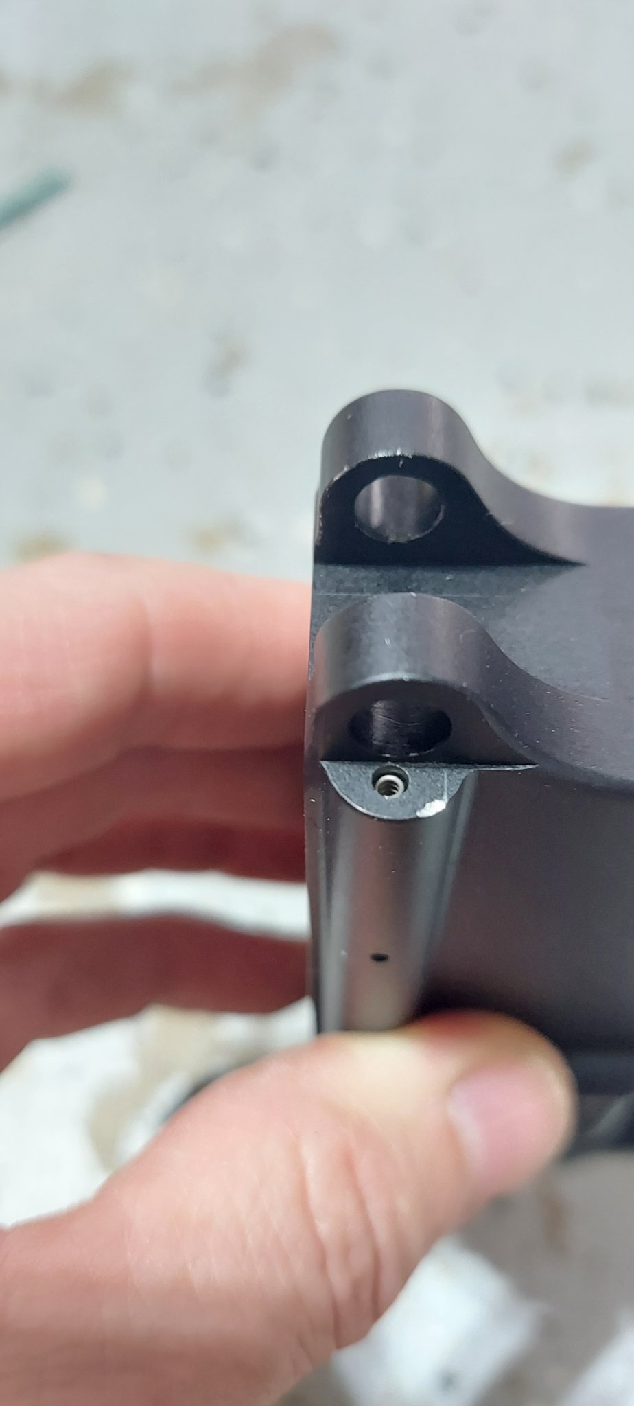

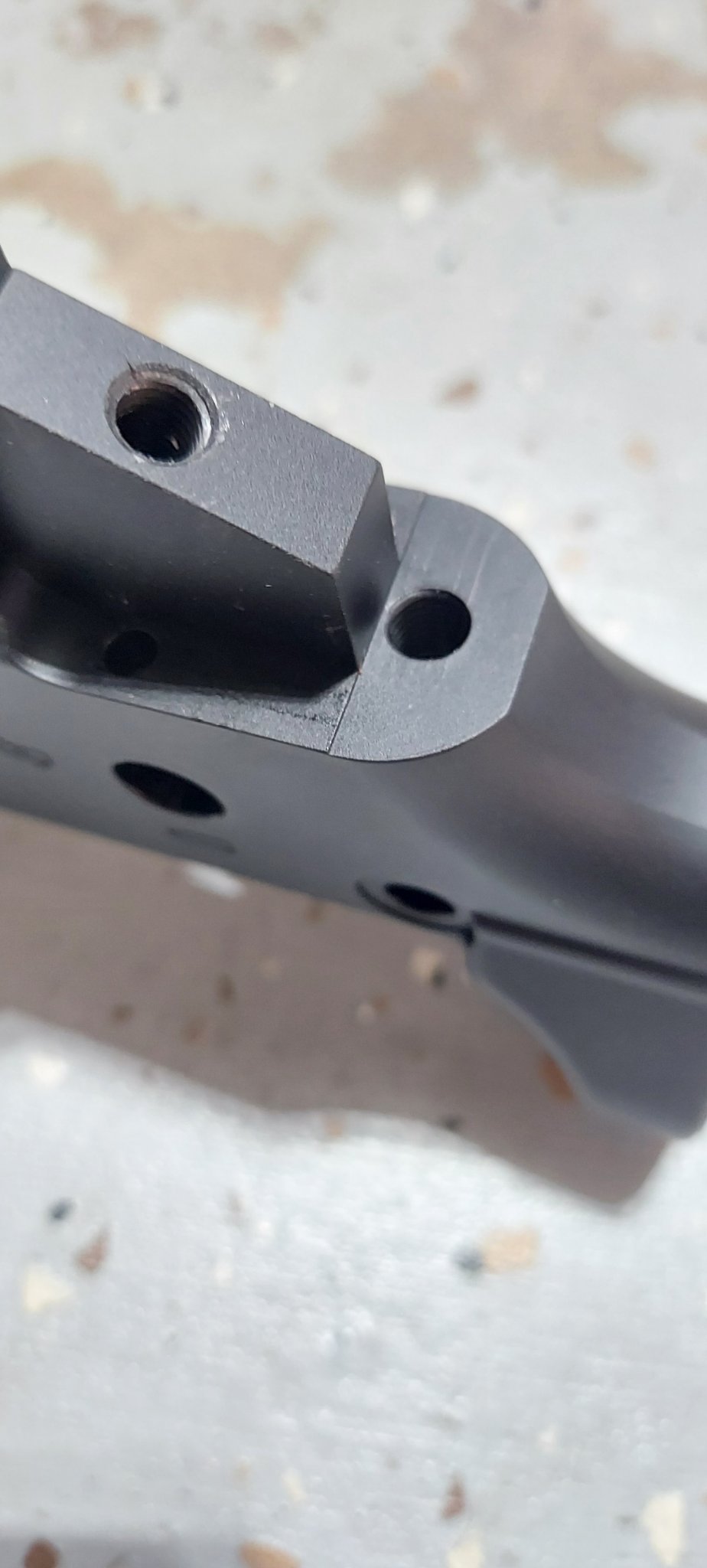

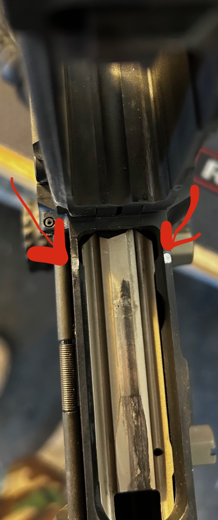

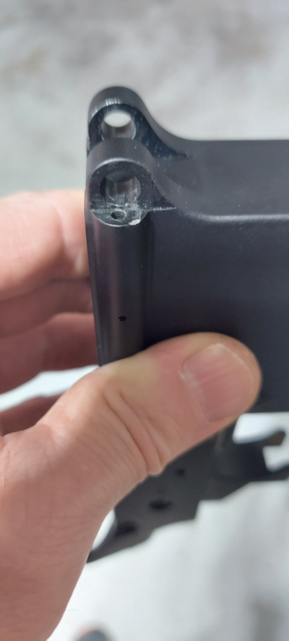

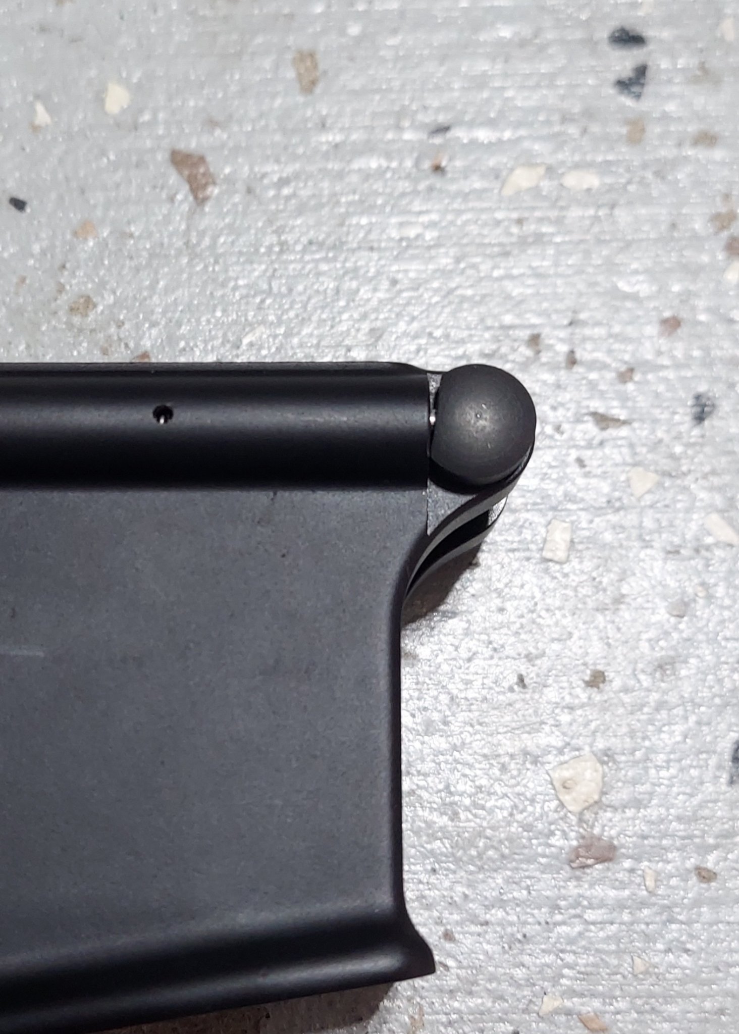

New MARS Piston 5.56, less than 500 rounds. Troubles with feeding due to poorly machined receiver set. You can see I have two hot spots that are wearing on my upper. Lower has same wear as well, where they meet.
Pretty sure those start as raised areas meant to be filed to fit individual lowers upon installation
(Personally, I think this is a BS way to achieve fit as an alternative to better machining tolerance….but there ya go)
Yeah - I found the pic. Dear LMT, thanks for the fucking life safety level issue. I appreciate it.

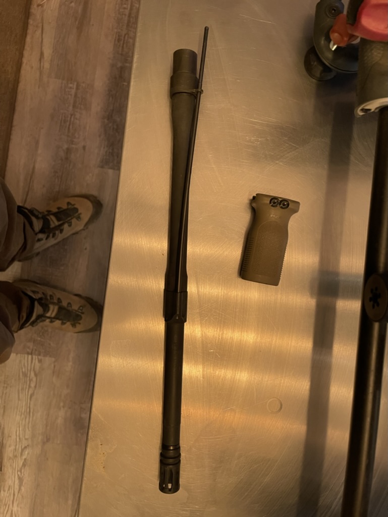

One of my barrels closes on no-go, that was the one I initially contacted them about. The second barrel they sent, wouldn't close on no-go, but effortlessly closes on field. I gave up after that. I could have contacted them again and gotten yet another barrel that would probably be bad, but it wasn't worth the time.
*Edit: Second sentence should be "wouldn't close on field, but closes effortlessly on no-go".
This is the purpose of those marks on your upper and lower. It allows for a custom fit between lower and upper.
What some people complain about these days is hilarious.
Those are fine when they're machined/filed properly. In my case, they were not, and I had feeding issues due to this. I know, I know, how dare people complain about feeding issues.
A field gauge should be bigger than a no go gauge. Closing on no go gauge means you need to check with a field gauge. Closing on a field gauge means headspace is excessive.
