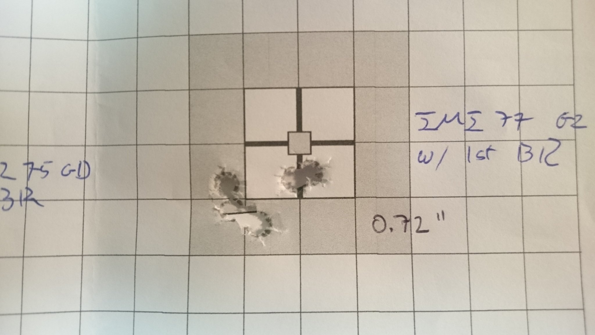

I and this exact issue with an AR years ago. 1st round loaded by CH would have a different POI. I was shooting IMI 77.
I can't explain why, but for me I traced it back the the OG straight 20rd Magpul PMAG I was using. I tried a 30rd M3, Lancer, and GI 20 Rd aluminum mag. It only occurred with the 20 Rd straight Magpulal mag.
It was very consistent.
This was 2 separate 3 round groups. Both first shots(used bolt release to load) are touching and then shots 2 and 3 from both groups are stacked low left.
Fired at 100 yards.

I got the same results using four different mags, so doubt the issue is mag related. (But still possible.)
