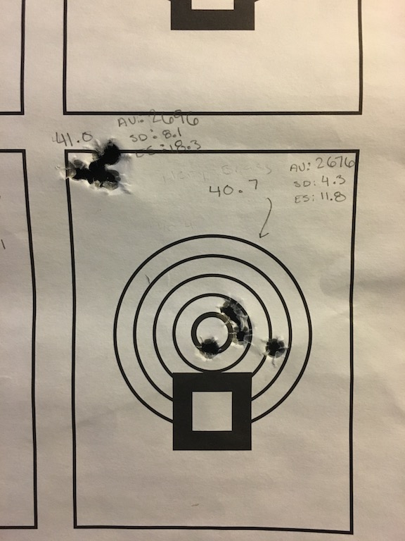

Yes- I am feeling pretty happy with my reloading technique. All of my 5 shot group will yield single digit SDs and ES under 20, BUT my issue has been that some of the groups with an SD of 2 (five shot string) will give me looser groups in the ~.5s" as compared to some of the loads with and SD of 9 that will yield tighter groups in the ~ .2s".
So that's why I started the thread for advice on how to move forward as I am capable of nice groups.
Sorry for so many questions but is the load the same in the groups that are in the 2s and 5s? With such small moa , I assume your at 100 eliminating as much virmem
If so is the velocities slightly higher with the height SDs
No I really appreciate it! I am running a modified OCW test of .3 grain increments of powder (5 shots of each). Yes being done at 100 yard bench w/ labradar. I will take a picture of an example target when I get home to show what I am talking about.
That’s the same way I do it; blending both the harmonics that show up close and the chrono that simulates the ladder.
I focus on the smallest group that’s in the middle of the exact same POI. The shift in POI is really the thing to look for, sometimes it is very small.
Your sampling is so small it is hard to do more than that. Once you can load more rounds you may find out that the 5 rounds that yielded X SD is now different.
Once you have the charge weight you can play with seating to tighten the group slightly. The seating should not really do more than effect the run in to lands. That’s assuming your doing so within reason.
Yeah I guess that is my predicament - of what to do when the numbers (SD/ES) don't match with the group. Here is an example of one for 6.5 CM from last week:
What bullet and length barrel? With those speeds, you have a whole other node that's faster and is as accurate. start at 41.5 and work up. You'll find it. I bet it's between 41.7 and 42.2. Probably dead on 42.
It is on a 24 " RPR 6.5 CM factory barrel w/ HRDY Brass, H4350, HRDY 140 ELDM. I am asking more in generalities and using this picture as an example- since I have gotten this situation a few times. I have worked this same load past 42, but just wanted everyone's opinions on essentially the mindset of settling on a charge when your data points contrast each other.
The issue we have on this side of the computer is seeing the full set of groups and you POA/vrs/POI that shift is really the key and should be your main focus.
what is important is to have all at a clearly identifiable POA, then the POI vrs that for each load.. you see a bunch that kinda all look the same then at some point the group start to move and eventually have a noticeable offset. you never want to be on the edge of that move regardless of group size. Mostly because heat, cold and reloading variance can bring you to the ofset
That's helpful info - accounting for variation in POA/POI
