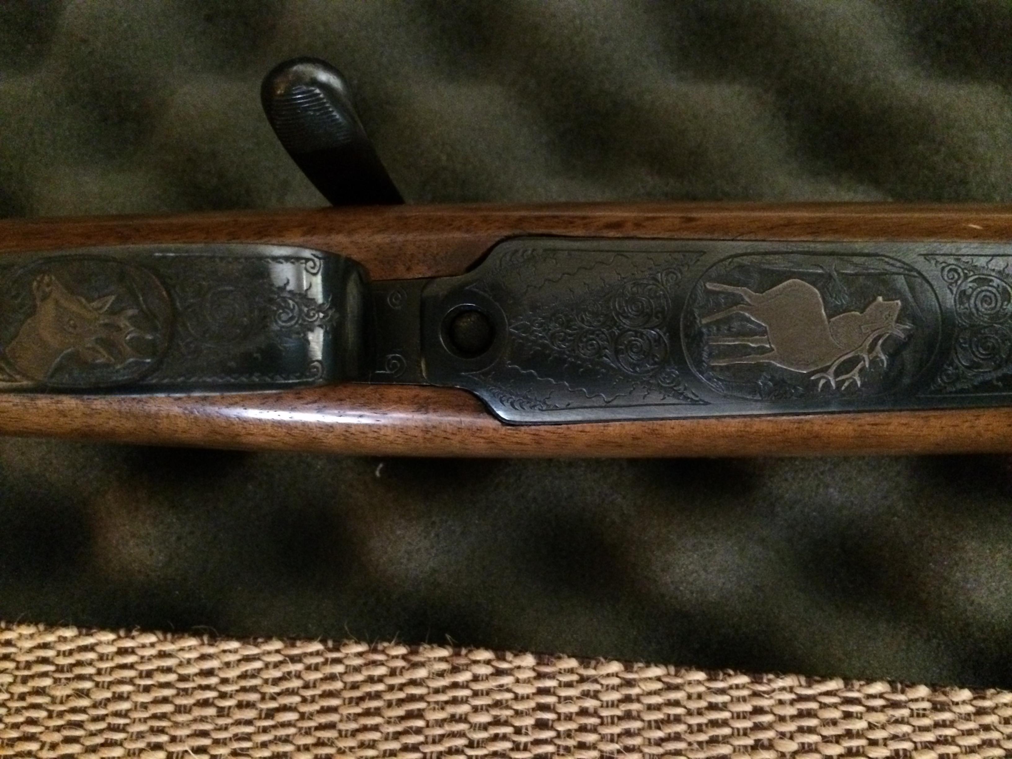

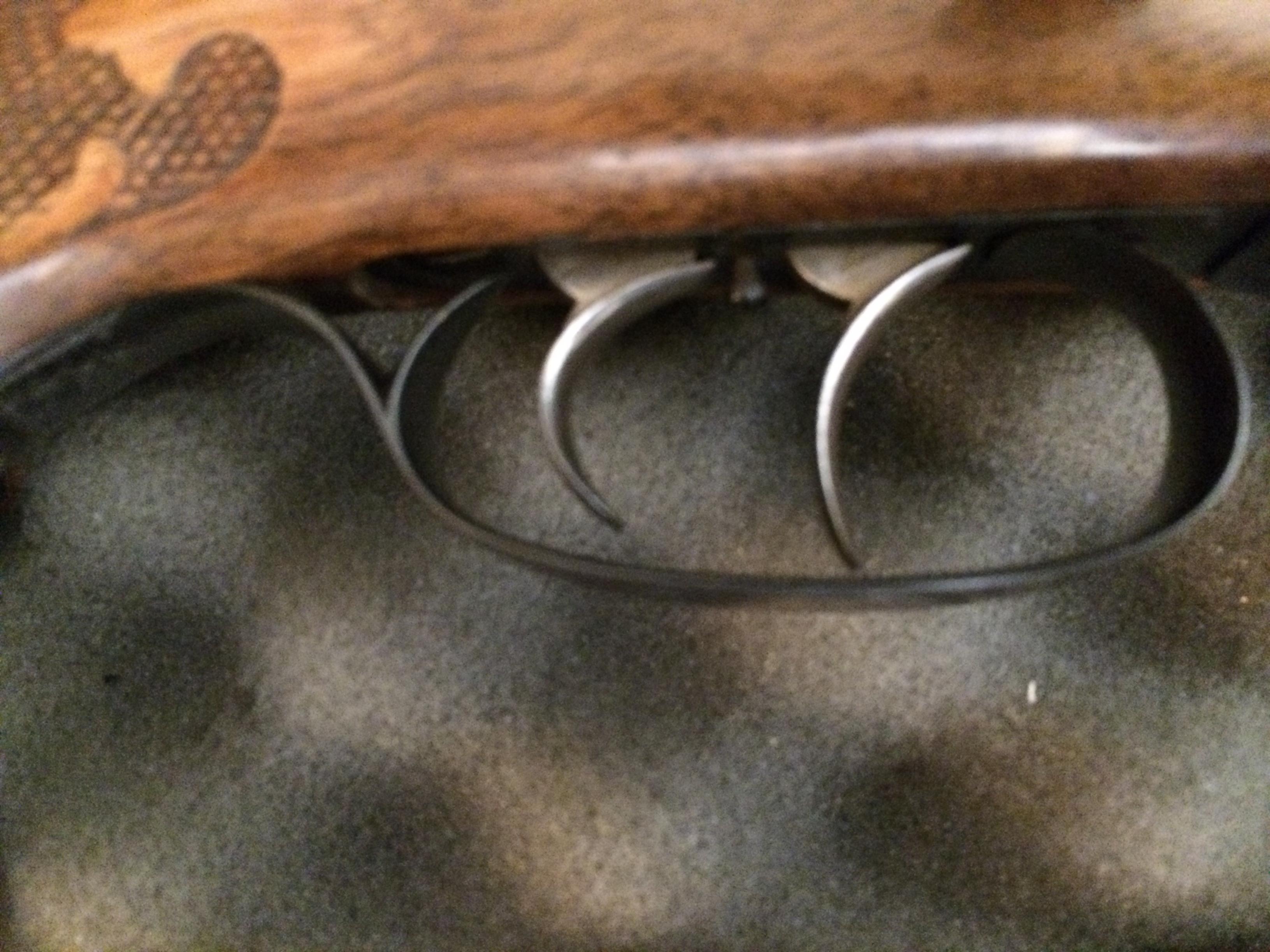

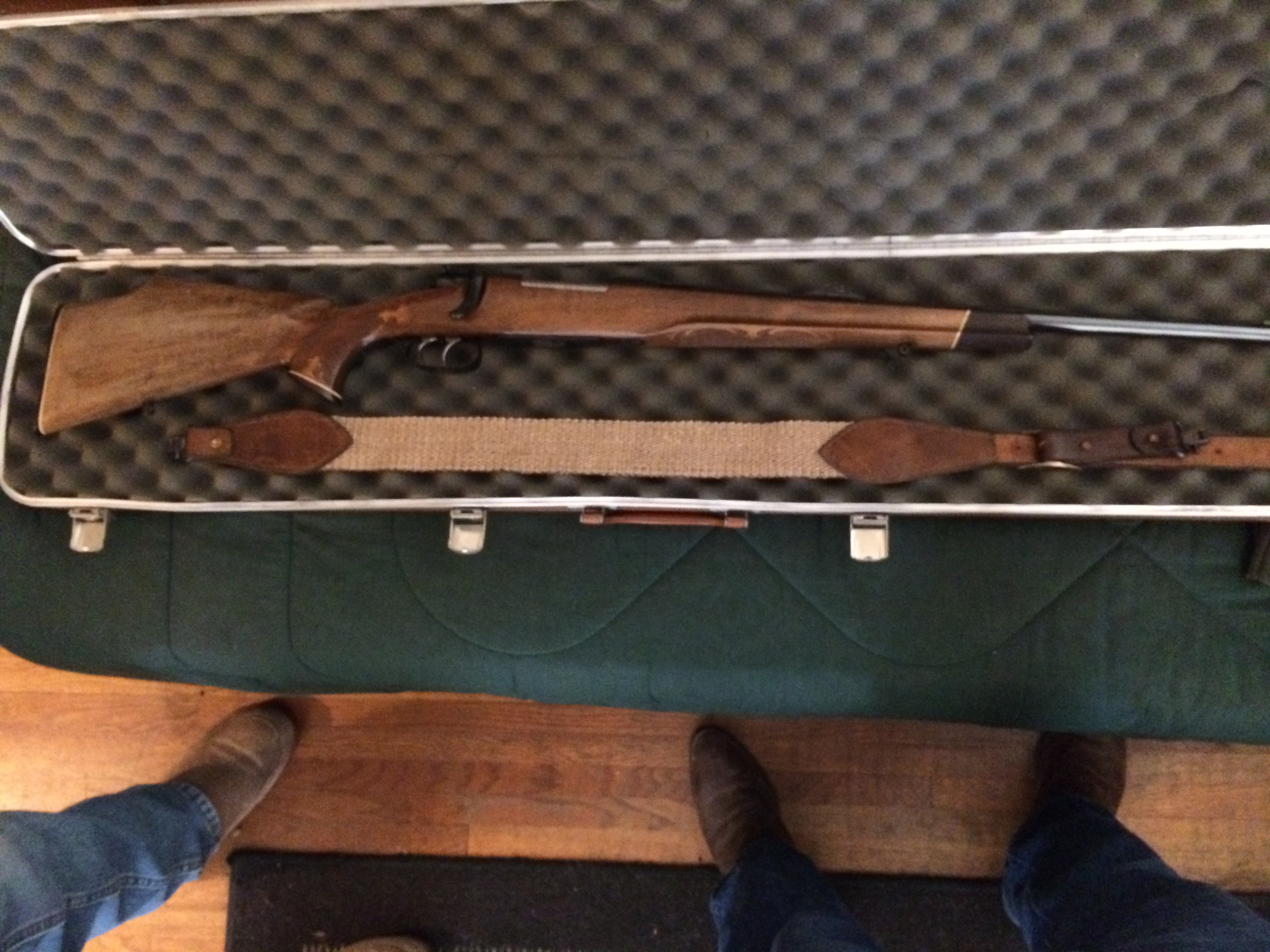

Very disappointed, this rifle has been heavily sporterized for hunting it seems, no definite proof marks. The guy only knew it was made in Europe. Here are a couple of pics. The only numbers and what looked like markings were on the barrel and side of the receiver, but very hard to see the markings
I'm sure there are some guys here than can comment on those proof marks. I will say one thing, that's an especially nice sporterizing job done on it. Never seen one with a double set trigger. Most seem to involve chopping off the barrel, and whittling down the military stock. What caliber is it? The replacement stock is super nice. Did you buy it?
It is a 30-06, the guy said it has been a safe queen and never shot (by him)
He wouldn't let me take it apart or anything, was looking forward to a some what original Mauser, not a sporterized one. I too have never seen the double trigger set up, and the stock was very nice. I did not yet, I'm just the middle man for my father who was interested but out of town at the moment.
Can't give you a value... sporters are outside my main interests.
It does appear that the rifle went through the proof house in Vienna, Austria... the nitro powder proof mark with the V, indicating Vienna. The other proof might be Austrian as well, but the photo really doesn't show up the detail... I believe it looks similar to an Austrian Bundesadler (Federal Eagle).
That rifle deserves to be shot.
Sorry that is the best I could get, this place was poorly lit but thank you.
I agree deserves to be shot, I think my dad is going to pass on that, as he was hoping for an original Mauser, unless we can find similar ones priced way lower than what the guy is asking then maybe he'll pick it up.
Lol, don't get me wrong, it was a beautiful gun, but we were under the impression that it was an original mauser, not a sporterized one. What would any of you price/suggest this at, is it worth the 1k asking price?
I'm no Mauser fan/specialist, my opinion is that the Mauser was brought to its ultimate in the 1903. That said after the war many GI's had 98k's built into fine hunting guns by some skilled German smiths. I don't have an eye for the guns but the engraving, double set triggers, wood strikes me as European old school. It is an interesting rifle.
What's it worth? That's for you to determine. If you had your heart set on a mil spec gun it's worth less to you than it may be. To someone that collects hunting rifles.
West caliber is it? If 30-06 that leans toward a GI conversion some.
Yes 30-06. The gentlemen said that he believed it was 60's made in Europe. Maybe this is one of those its worth ehat ever someone will pay for it?
That actually looks like a postwar commercial action to me, FN maybe or even one of the others. Anyways not enough in the pictures to tell but I not going to say its a sportered-mil action. If its an actual commercial from Germany, 7-800 wouldn't be too bad, but they were not made in .30-06 very often so its hard to say.
Though it probably took a lot more labor than Im willing to pay for $5-600 would be tops for me. There may be history that makes it worth more but it would have to have good provenance.
Id be more attracted to a pieced together Russian return though its a lesser rifle.
View attachment 46399View attachment 46400View attachment 46401View attachment 46402
You might want to re-think "disappointed". That is a pretty nice sporterizing job. As to the origin, it really doesn't matter at this point except to know whether it was good quality or not.
Could you get a pic of the left side of the receiver and if possible, take it out of the stock? Thyen take some pics of the bottom of the receiver?
Seller wouldn't let me take it out of the stock, and didn't seem happy to me taking pics for some reason
Just talked to my dad (who is the one interested) he is going to try offering around 300, because he doesn't know who built it or much information on it, hopefully the buyer says yes so we can get some better pics!
If you get that for $300 you'll be getting a bargain I'm sure. If he needs to sell it and has a little time he'd more likely get around $500 for that one. If he had who sporterized it, and he was a guild member, that could go for as high as $2500. Remember, that's based on a "well" known gunsmith. It means a lot in that world.
Added: A lot of my best deals were Mausers that someone sporterized most of the way, and I finished. The ones I sporterized, I put all the money into them and will never get it out. They've all given me a lot of good service. Even if some of them weren't entirely the way I wanted them when I got them back.
Yeah I thought that a lot of the price dependeed on who built it. He had no idea who built it so gonna just make an offer
