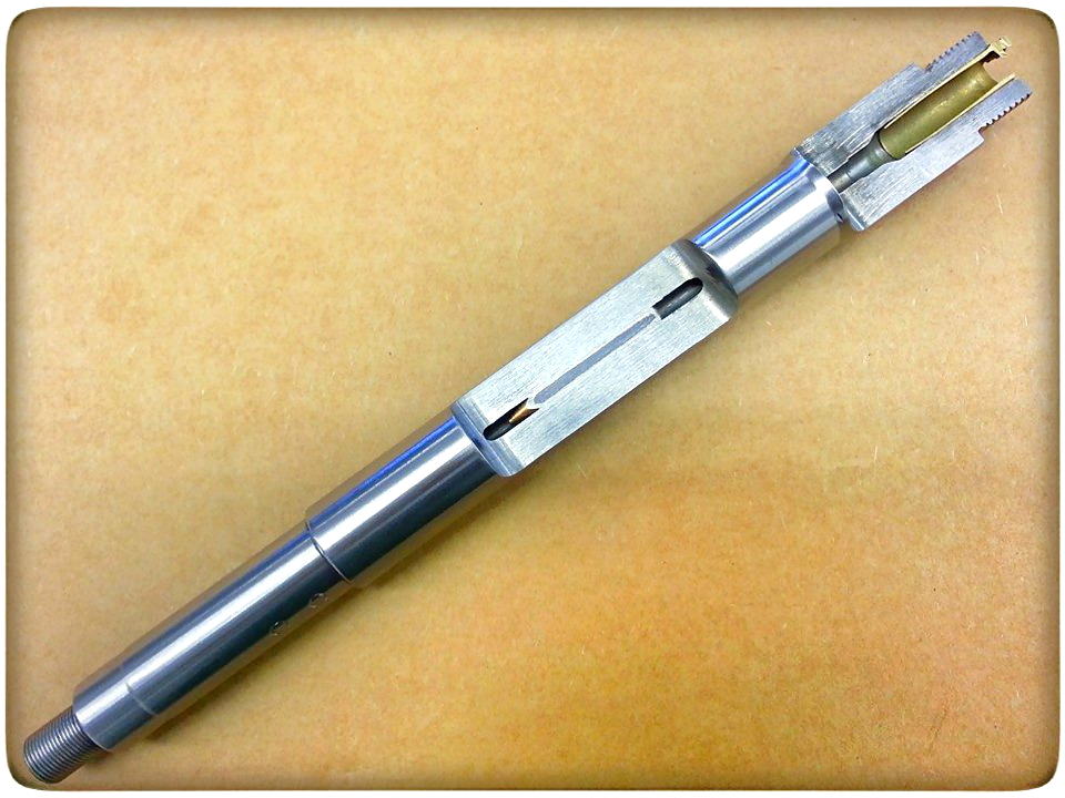

You get a fire-formed .223 bullet
The long sub's generally WONT fit in the chamber.
The short supers generally WILL fit in the chamber.
Im surprised in the first pic of the cut apart barrel the thing didnt blow like the second set of pictures. Looks like a bolt gun barrel in the first pics.
I did not do the cutting, a friend sent me the photo. I would have just tossed it in the trash if I did it and not told a soul. :) After that Ka boom down the road from my place with that 338.. I'd never fess up to doing something this stupid. That poor guy became a celebrity of stupid over that.
I don't know what gun that photo came from but you can see the two rings from the set screws of the gas block. The threads on the chamber end are confusing. I am thinking that barrel began its life as something else.
I just thought it was pretty cool how it squeezed that .30 cal bullet that far down the pipe.
It is pretty amazing the destructive force of 18 grains of h110 or what ever blew that AR bolt apart.
Shit I had to go look at SAAMI prints. I never realized it would even come close to chambering until 30 seconds ago. Then again I dont own nor have I shot a 300 Blackout. Hope nobody got hurt but that is a pretty cool picture.
There are bullet swaging dies that can reduced the diameter of a bullet, but that is generally lead.
I wonder how many tons of pressure you would need to do this one. Would a 12 ton or 20 ton have enough force?

Great visual of why you need to be extra careful if you run both 556 and 300 Blk Out ARs. One of the major selling points of the 300 Blk Out is that all it take is a barrel swap... all the other parts are the same. So I can see how if magazines are not clearly marked or all gear separated by caliber a split second of carelessness can cause a potential big problem.
There's a margin of safety in that a 300 Blk Out round doesn't "easily" chamber completely (bolt closed ready to fire). I haven't tried it in my rifles but I believe the bullet has to be pushed back into the case to allow the 300 Blk Out case in far enough for the bolt to close in a 556 barrel. So I think it comes down to neck tension/crimp that makes the difference between cambering completely or not. There was a post on another forum that showed how it was possible even with some of the heavier bullets.
So I guess the moral of the story is to be careful.
