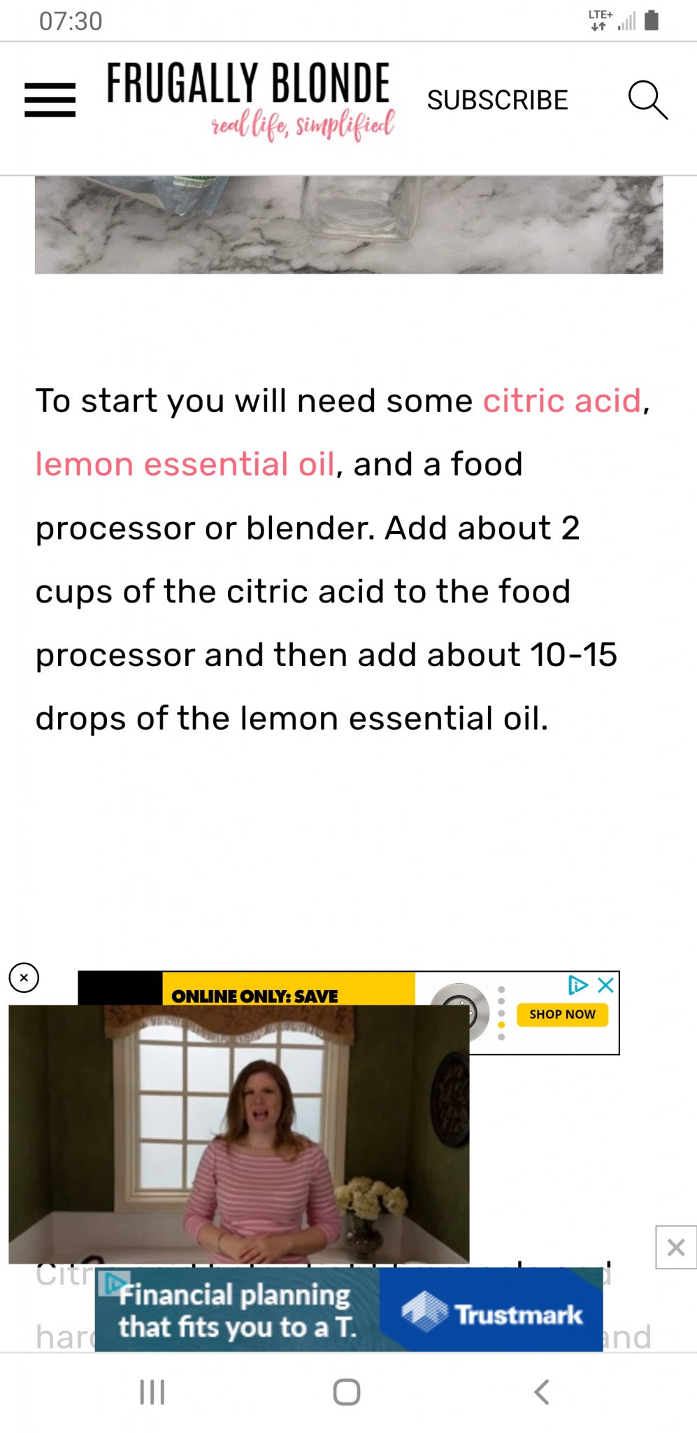

Well, yeah, if you want to use dishwashing products. I buy the lemon juice made specifically for cleaning brass.

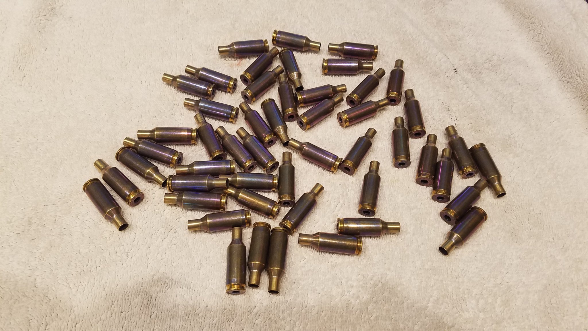

My first attempt at citric acid and drying in the toaster oven.
Some really old Remington 6-BR brass.
Both things went wrong.
Too much Lemishine and the toaster oven was at like 350°
Forgot they were in there and they got that temp for something like two hours...
The color was really pretty though. 😁
That poor, poor brass......

Like I said, it was my first attempt and likely caused by too hot, too long in the oven.
The stuff I've wet cleaned since then looks like gold.
And yeah, multiple rinsing is necessary.
I went back to tumbling with rice.
I only wet clean if it's dirty range pickup brass.
The fix was easy. Less lemishine and putting the oven on 170° with a timer

Hi all,
So I'm all the way down in South Africa and we can't get Lemi shine here... to be used when wet tumbling brass.
I've been told to just use citric acid.
So.. same measure, 1 table spoon ?
or do you add something more to it.
G
Do a Google search for Citric Acid near you. The amount varies by how hard or soft your water is. A 45 auto case full works here for me. The last place I lived it was a 9mm case. Trial and error.
