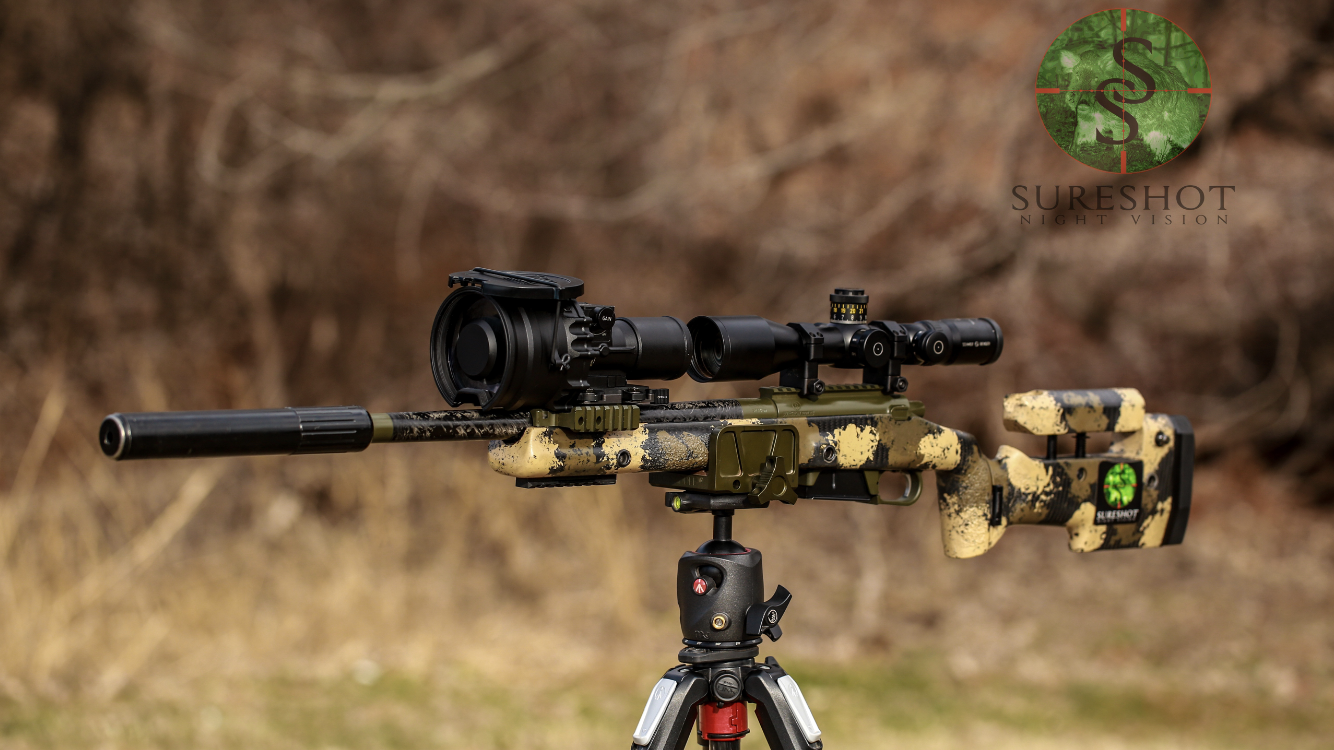

    Ok so theoretically speaking here... If you could get your
    Pvs-27 re-tubed with whatever tube you want, what would you choose. Here’s your choices!

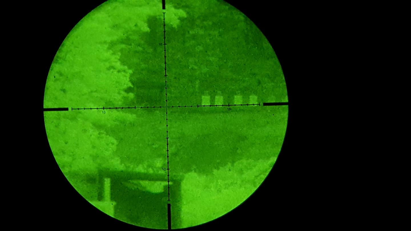

    So we’re back at the range again... Same targets at 800, same really dark conditions but with a 4G in the 27 instead of the L3. Obviously if the L3 needed a boost with the illuminator were going to need it for sure with the 4G. Click it on and bam, still 70lp resolution!

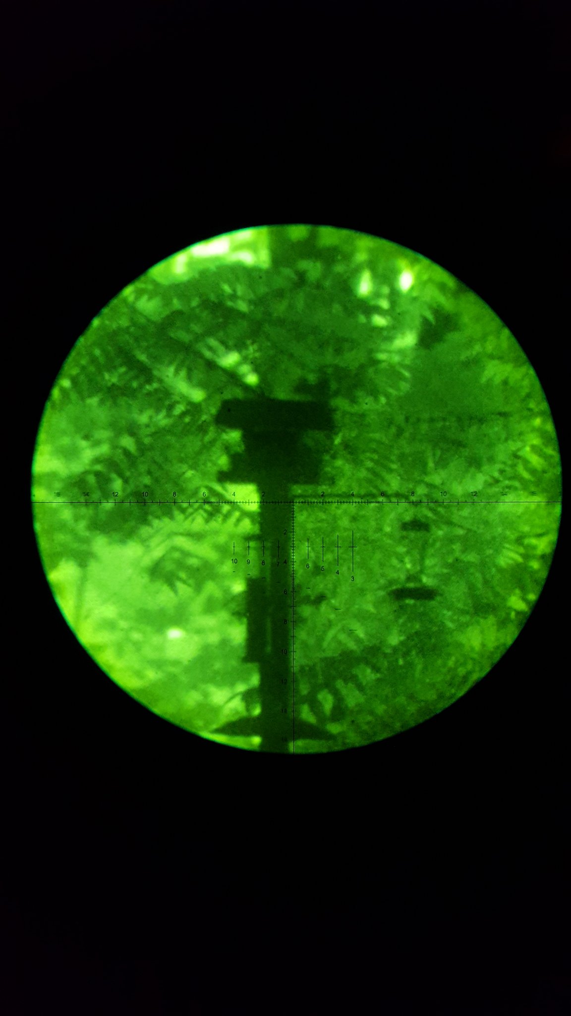

    I dont think its any secret that the highlight resolution is better with the 4g than the filmless. Now how each entity comes up with their numbers and how that process compares with each other, I do not know.
    **just thinking out loud here** Keep in mind that video was made through what I assume would be pvs-14's. So in a clip-on would the difference be even more noticeable since you are magnifying the image?

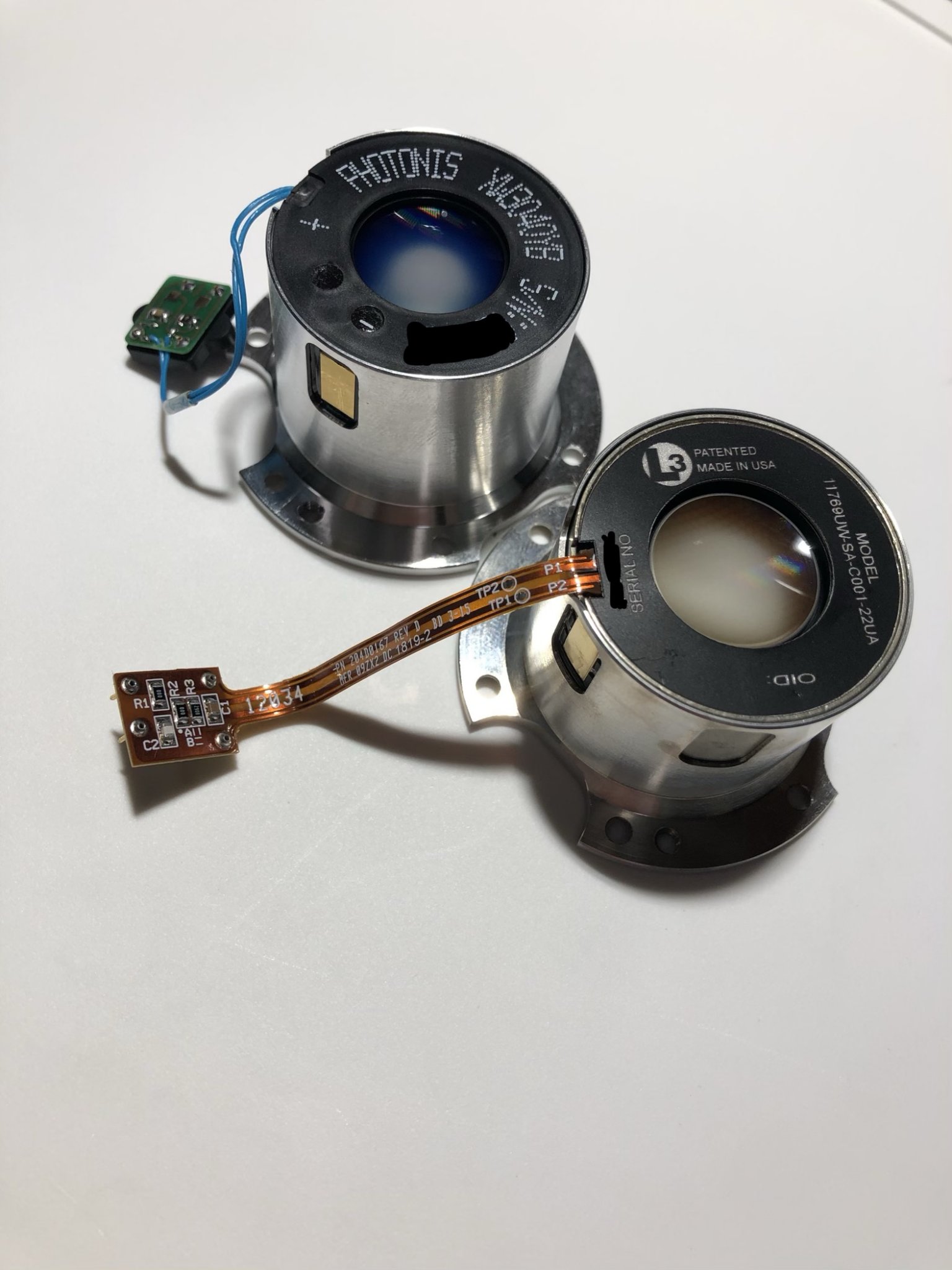

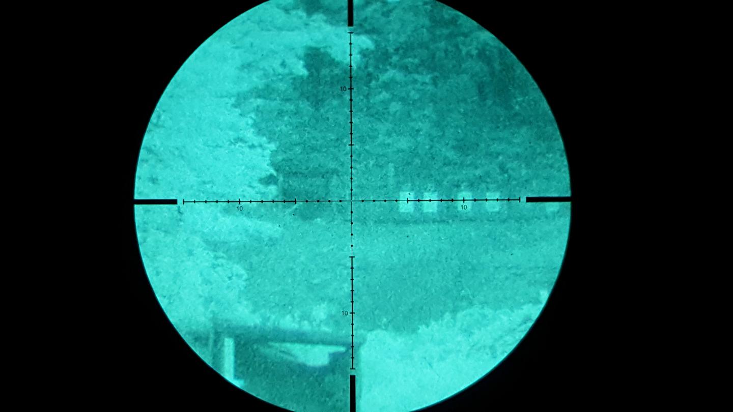

    So I picked up a brand new pvs27 and immediately started seeing if this was possible to do. I spoke to several people at FLIR and basically they might be willing to swap a tube, but only at the request of a .gov agency. So if you know someone who does this work, let me know!
    Regardless, I'm not sure that swapping tubes would get you better resolution. Here is a picture of my PVS27 vs. a loaner CNVD-LR from L3 with a WP tube. Both through a Leupold Mk 6 at around 8x zoom at 500 yards, no illuminator. You can see the box housing a steel target and the white paper targets to the right.

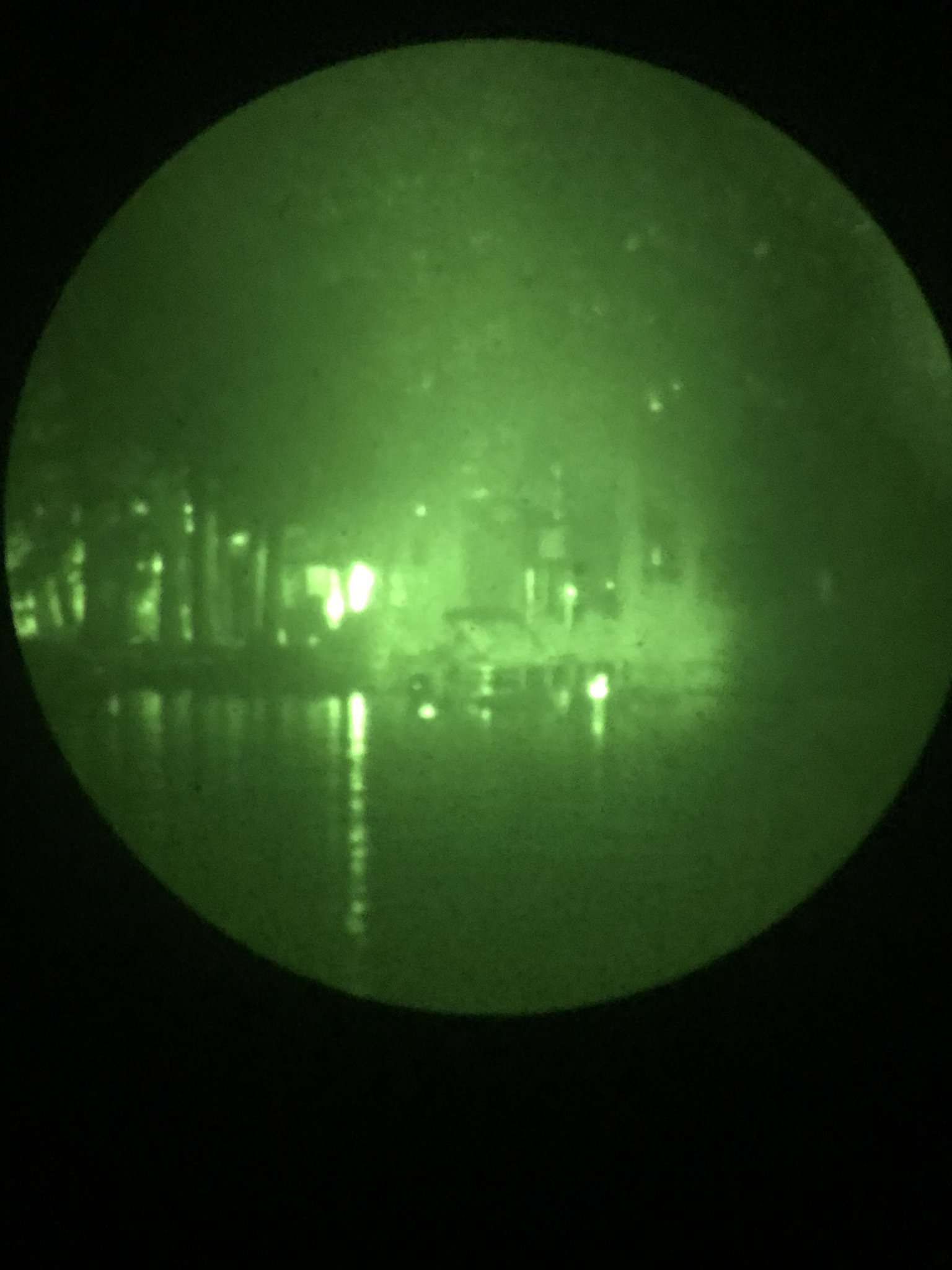

    I took the pvs27 to a lake the following weekend at was able to clearly see a party boat (pontoon boat) at 903 yards with a Perst 3, no ambient light nearby. That is the third picture. I had a handheld iPhone behind my scope, so take it with a grain of salt.
    For what its worth (I wish I took a photo), I was able to clearly see details in a church steeple under a full moon this weekend at 1940+ yards with no illumination and the pvs27. And was able to easily get up 15x+ zoom before the image started to degrade. So short story, having a white tube would be cool, but I am not sure it would gain you that much. Maybe I got lucky with my unit, but the CNVD does that fair that well, especially at higher zoom ranges (granted it was not designed for that).

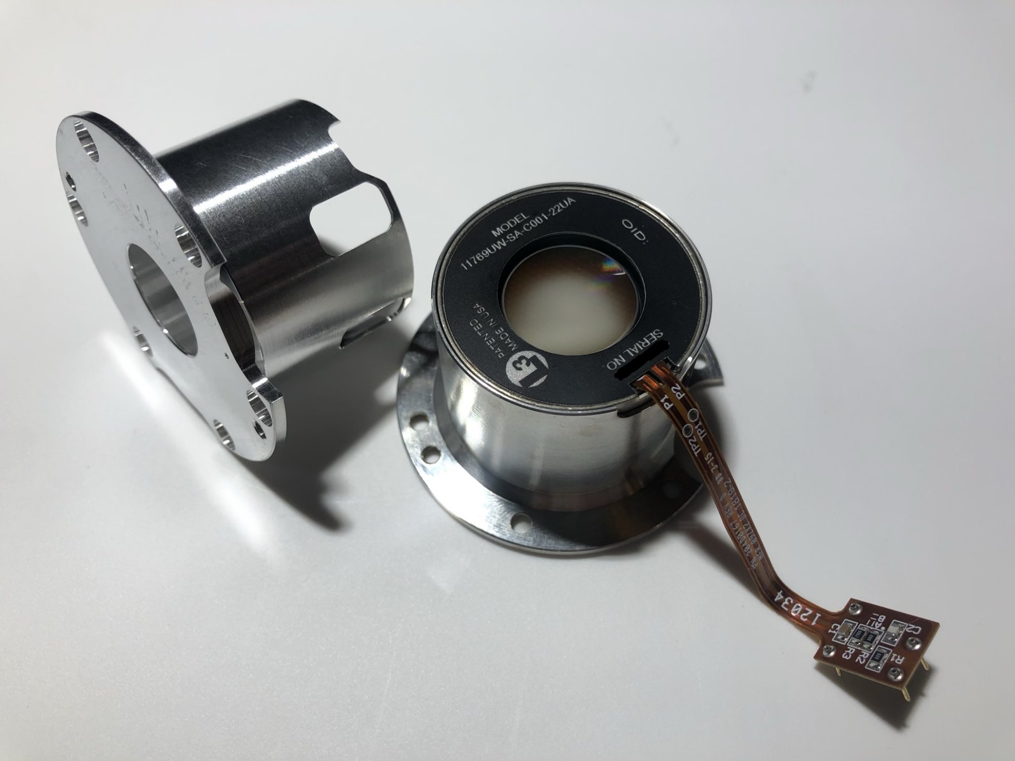

    I want to know how you did the install haha.

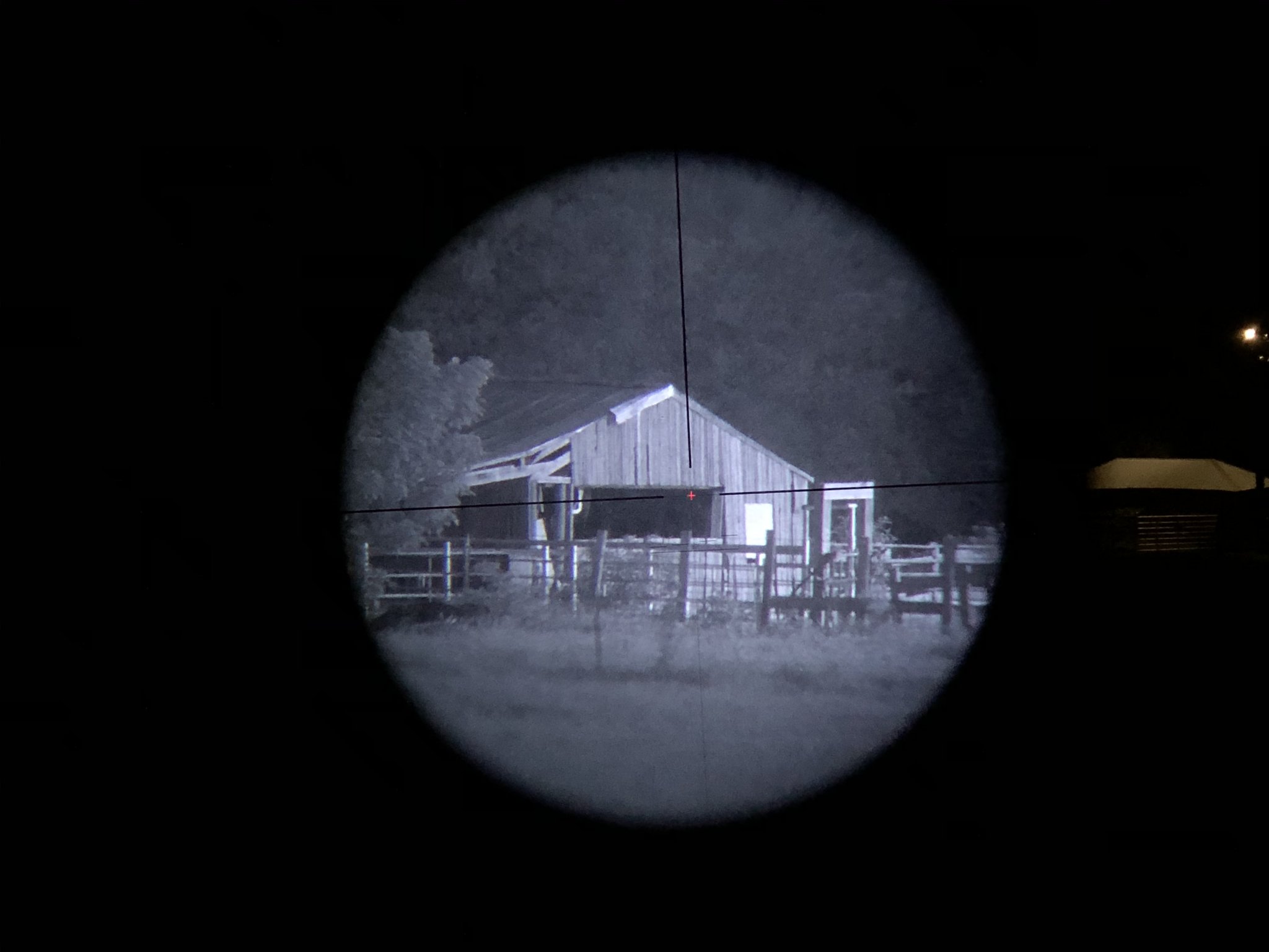

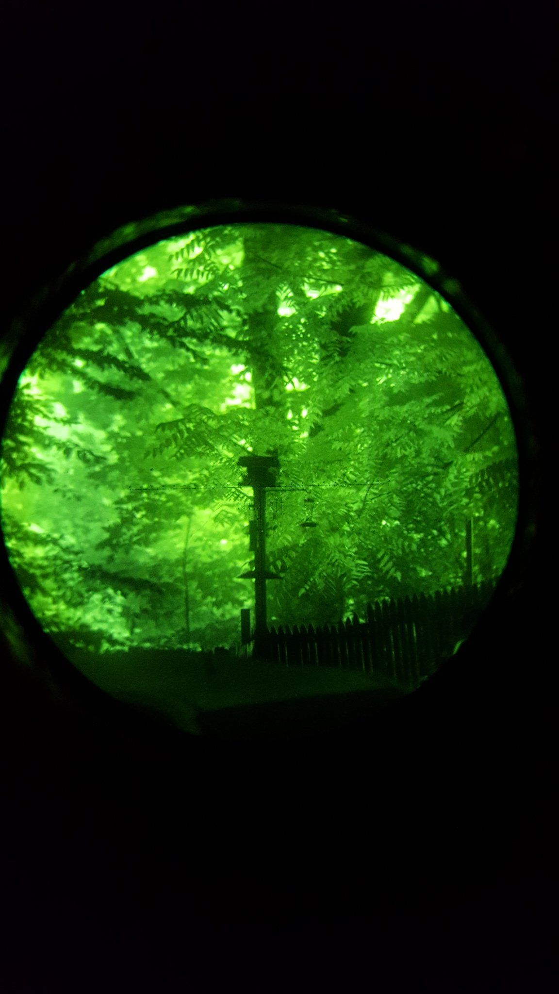

    My PVS27 has pretty good performance. This is it through an Athlon Cronus UHD Tactical spotting scope at 7x and 20x at 100 yards.
    Well I’ll say this. It ain’t easy. Not even almost. I have built just about any kind of night vision device under the moon and this one is no joke. There are parts and pieces in there that HAVE to be replaced with every unit. The tube gets epoxied into the aluminum housing seen above and you can not remove it. So you have to have those on hand and if you screw up with the epoxy.... Well you’ve lost a $3000 tube because you’ll demolish it trying to get it out. Then there’s no contacts in there. Meaning the power and ground wires get soldered directly to the tube. There’s a fine line of not enough heat and too much when it comes to the pot of that tube when soldering to it. It took quite sometime and I was a nervous wreck but hey, it’s a bad mofo now!
    Jay
    Jay

    Jay- can you share known tube specs on that WP image. She’s a beaut. Gotta be 81lp
    Thanks man! It’s:
    72lp
    34.5snr
    .8 ebi
    .8 halo
    62k gain
    I have a couple more that have a bit better specs but they were .6-.7 halo. I wanted to pick at least .8 for recoil reasons.In person it looks better than what the sheet says. It’s a very nice 22ua.

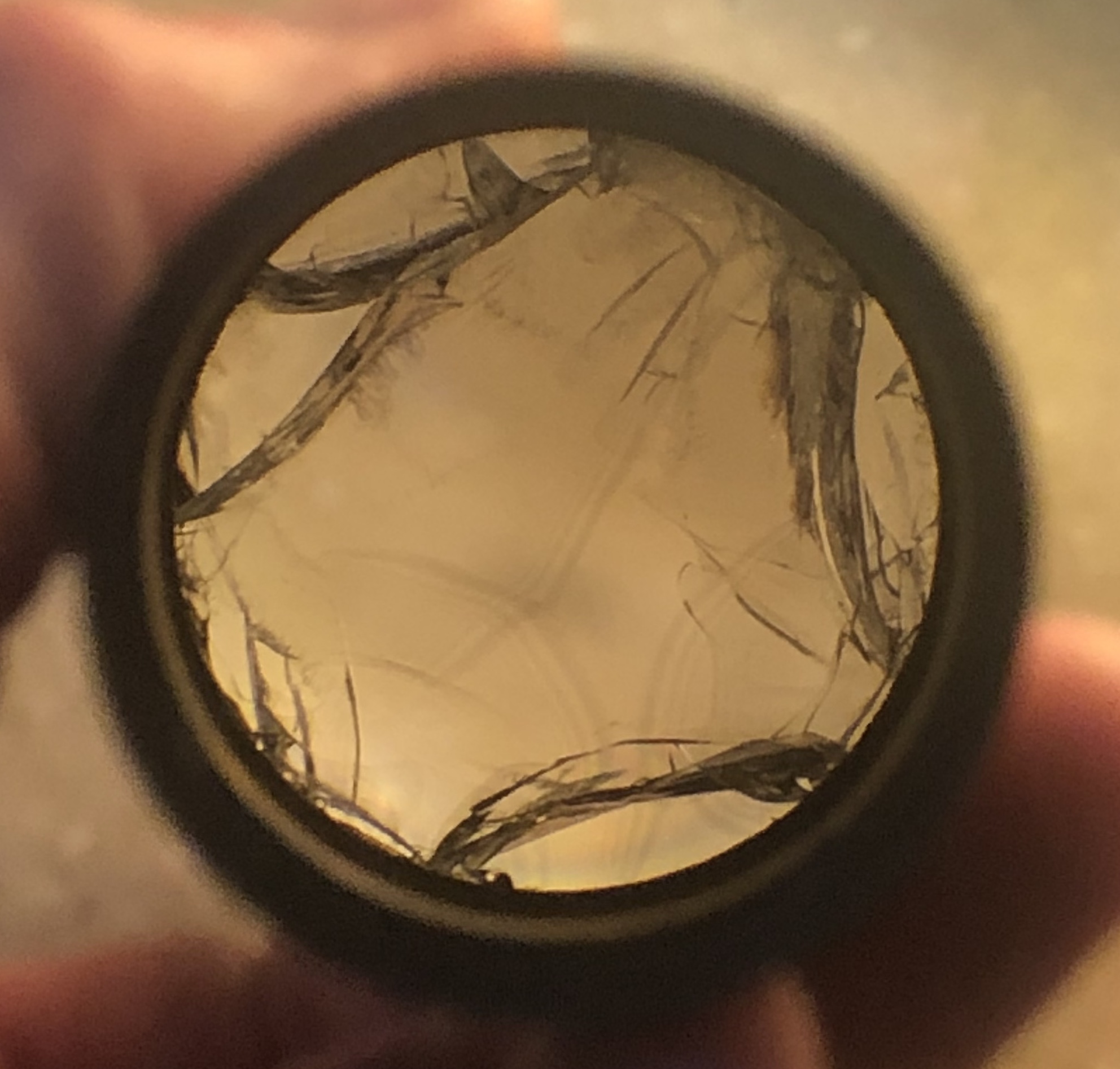

    Well fellas.... I knew this wouldn’t be easy and I went in to this project knowing that there were several thousand dollars on the line. I haven’t had many problems but there’s been some no doubt. It’s been a learning process and I’m always open to take on a challenge that others are scared of. Last night I had the 22ua 100% complete. When I say complete I mean complete. The collimation was absolutely perfect. Maybe not perfect but 1/8 MOA from being there. Considering they come from Flir with a 1 MOA guarantee I’d say it was pretty good. The lock tite had began to set and the set screws on the prism we’re becoming pretty stiff to move. Once the elevation adjustments were completed and tight I moved to the windage adjustments to snug them up before I called it a night. As soon as I started to turn the windage adjustment.... Click 😩
    I had a really good idea of what I had done.Powered it on and yep, broke the input glass on the prism. I’ll blame it on my massive arms and brute strength but you can call it what you will. I thought the resistance on the set screw was the lock tite but it was already tight enough.
    Its no big deal. I mean it is but if one thinks he can go into a project like this and not mess something up he’s delusional. I know what I did wrong and I know how to avoid that mistake next time. Yes it cost me a couple grand and it sucks but I’m determined to get this done and I won’t stop until I do. Here’s a picture of the hiccup.
    Jay
    Jay

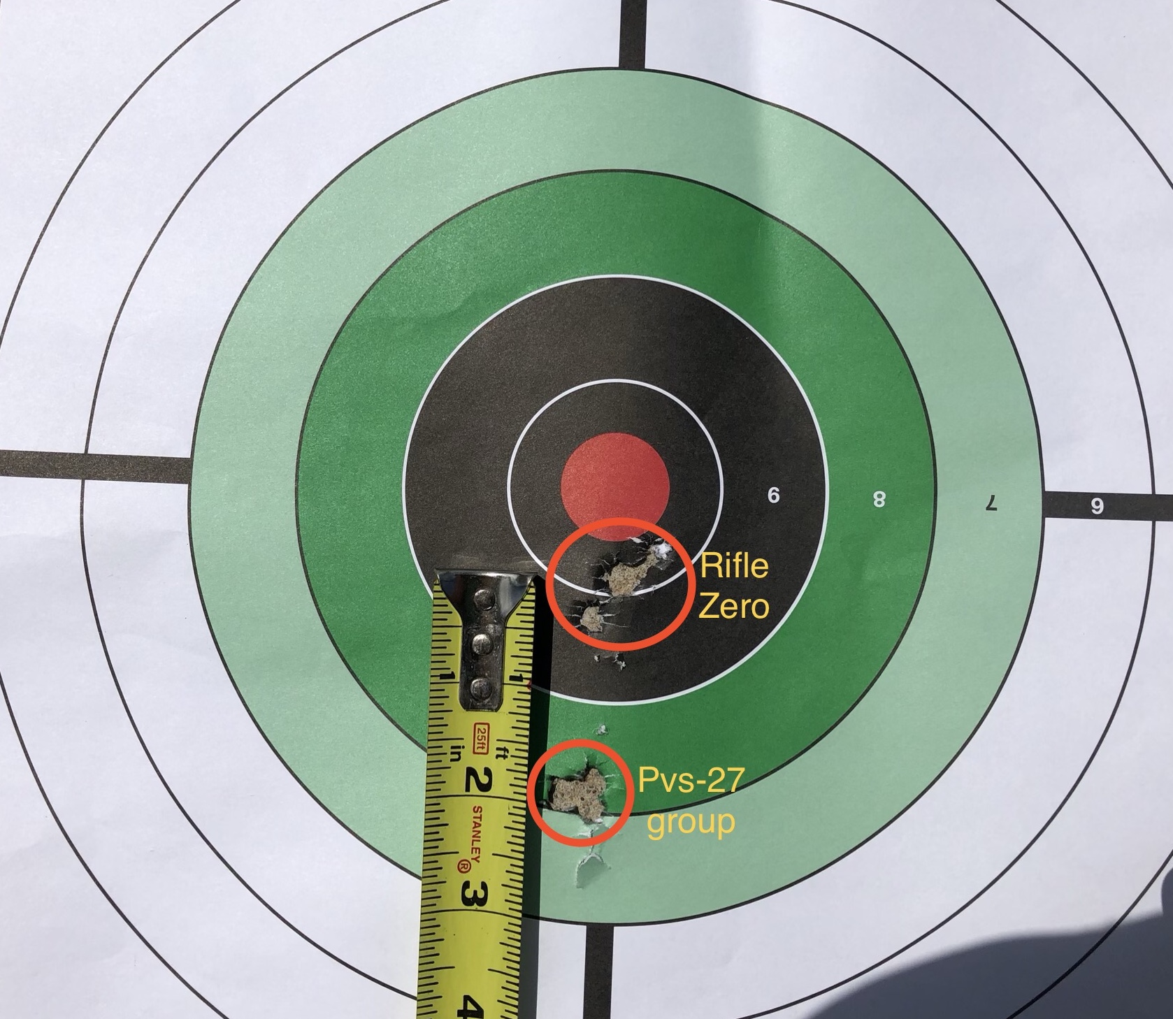

    Well fellas, I took the 27 out for it’s first live fire test last night. This post isn’t to tell you about how it looked but rather how the collimation is going. But I can’t proceed without noting that this MF is absolutely beautiful! Ok back to business...So I took two rifles to do some testing with.
    Rifle #1: Surgeon .308, 18” proof carbon, Manners carbon folder equipped with a badger EFR and harvester can. 3-27 S&B
    Rifle #2: HK Mr556/4x32 Acog
    I got a quick zero on the rifle (I mean quick because I was losing daylight) and who wants to shoot during the day anyway? Zeroed the turrets and then waited for dark.
    I had some 6” circle plates hanging at 200 and 230. I dialed up .5 Mils and started firing at the 6” imposter. I hit every shot I fired except for when I’d get excited and try to hit it mid swing. I then added .2 to the turret and beat on the plate at 230 some just to spend some rounds under the 27. Then I mounted the 27 to the HK and fired 60 rounds of 69 grain SMK’s at 230 also. Same results, sparks went everywhere.
    I then put the 27 back on the surgeon to see how much shift I had. Looking back I should have grouped it first thing of the night and then grouped it again when I was done for the night. But I didn’t and I’m going back tonight to do that....
    When I first swapped the tube this thing was 6 Mils or so high and 2 Mils right. Last night I put 50 rounds through a pretty lightweight.308 and 60 rounds of 5.56 under the 27 and it’s exactly 2 MOA low. I understand there’s several people out there that already have more collimation shift than that but I’m not satisfied at all. I’m shooting for 1/2 MOA or better. Can I do it? Hell I don’t know but I’m definitely going to try, aim small miss small right?
    Going back tonight to adjust collimation and then beat on it again. I’ll have a pretty cool video of it in action soon also. Anyway here’s the host rifles and the 5 shot groups when I was finished. Apparently my rifle is more accurate with the 27 on it 😂. That’s a heck of a 5 shot group, especially at 2am!
    Getting this thing collimated better and sending to get coated this week!
