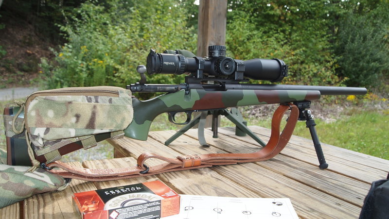

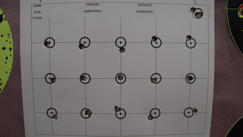

Yesterday I shot 15 one shot groups at a 1/2 inch circle at 100 yards using 175 grain FGMM. My sighters are top right......
The rifle....

something you might want to try is shooting dots not groups.
new shooters (but not only) get spooked about the last shot if they have 4 touching, its really hard to coach out
down load a few targets that are set up with dots in rows and columns
shoot one per dot
also start taking some notes about first shot, last shot. you dont have to get crazy about it but you will be amazed the patterns that form
if you arent into the dot game then at least dial you scope 1-2 inches away from the bull.
the idea is to aim at the same spot every time and not have bullet holes mess up your sight picture.
if you hit the "X" with 2-3 shots...where do you aim next.
your little bull turned into a 1/2" hole

PMClaine........that 1/2 in circle target is fantastic where did you get that I wanted to start shooting 1 shot drils at small dots instead of shooting groups.
Lowlight is trying to get the target page links from the Data book suppliers back on line something is screwed up with the service provider I guess and it cut the old links.
If you go to the link 1J04 so kindly provided go to the reference section on the left side of the page for the target down loads.
I thought something was screwy buddy. Thanks for the explanation. It's a good link still. I just printed out some more for myself. ;) By the way, I REALLY love that Rifle setup. Damn !!!
A Mark Williams, Raven Rifles, Pulaski VA build....
The gentleman aims to please and knows how to speak the language of M40.
Simply Beautiful. In hindsight, I remember you showing this Rifle in the past and answering a question or two for me on it. The name rung a bell. ;)
