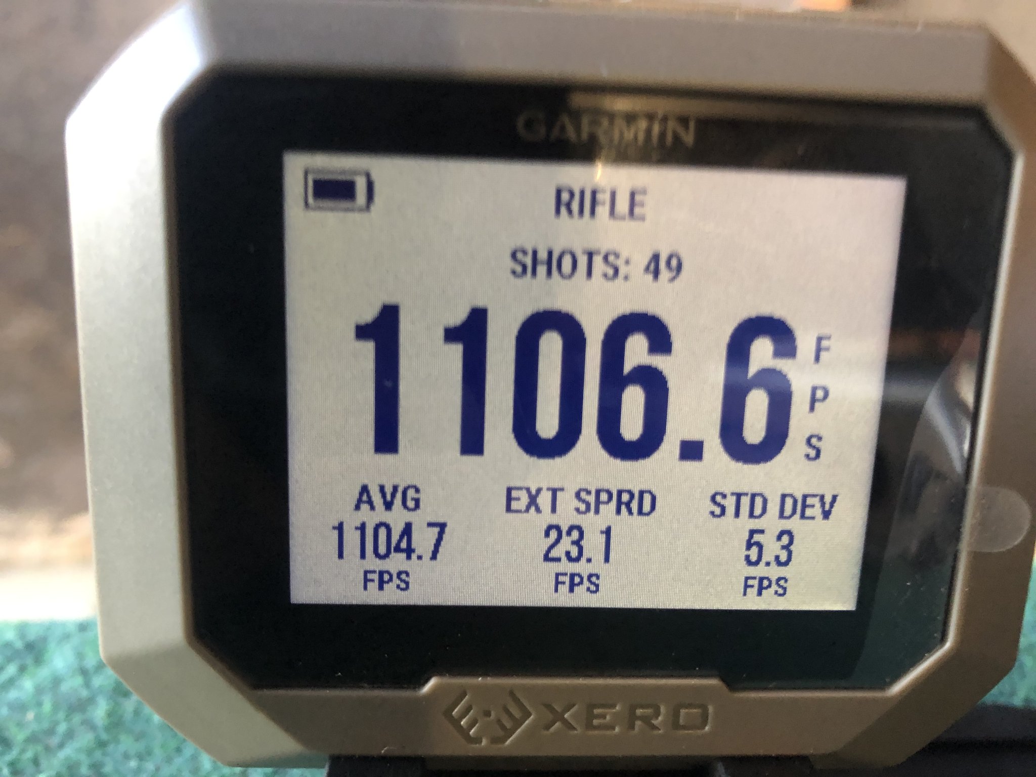

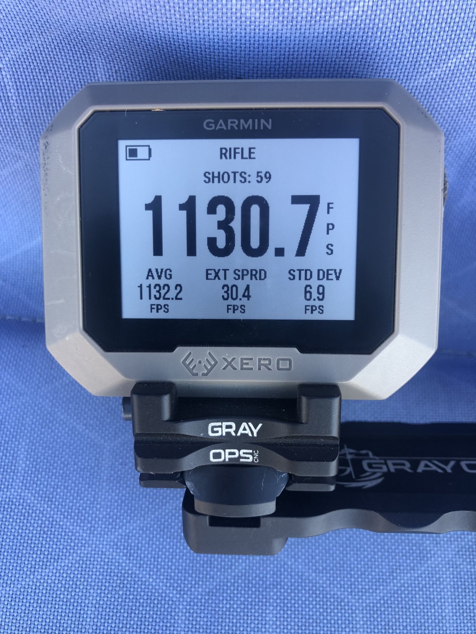

I lot test all my ammo for my rifles and have GREAT lots of ammo. * Current * Eley Match 7.8 SD, 19 ES of 65 rounds, *Current* Midas + SD 8.6 & ES of 21. The groups are round at all distances inside of 275y. Each ammo shoots equally well in both of my primary rifles.
