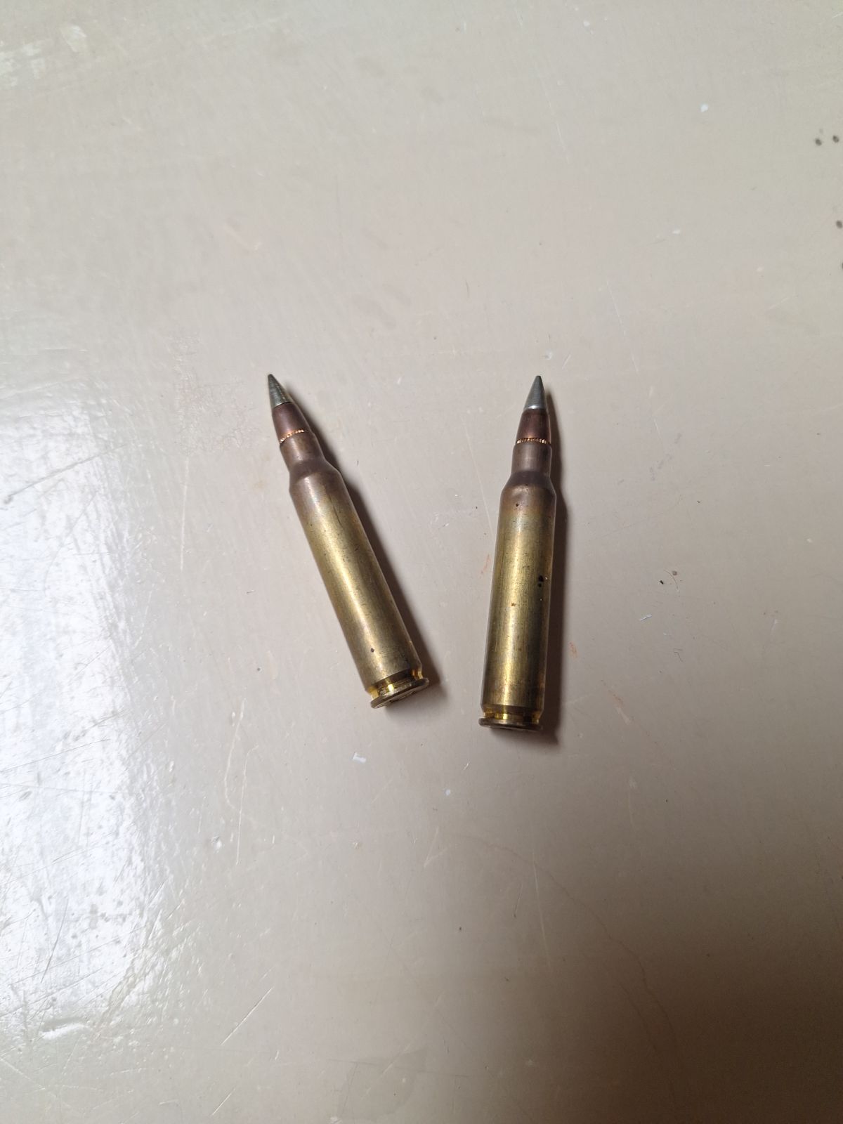

300 blk being fired in a 556 chamber. He also stated on the phone, hand loaded cartridges.
Would too powerful of a hand loaded cartridge be the same as a hot load?
He said that that area of failure is designed as a failsafe so that it gives way and fractures first rather than more catastrophic events occuring.

He said, "I think I found the culprit"; then sent me this photo and said, "M855a1 was mixed in with his training ammo". Then bashed LMT a bit.
Interesting write up on the m855a1

I'm sorry, but your trading partner appears to have a terminal case of the stupid.
As why I'm here to get a more educated opinion of the matter at hand. My expertise in regards to these specifics; lack. I can read plenty but first hand experience from fellow members had been very helpful.
