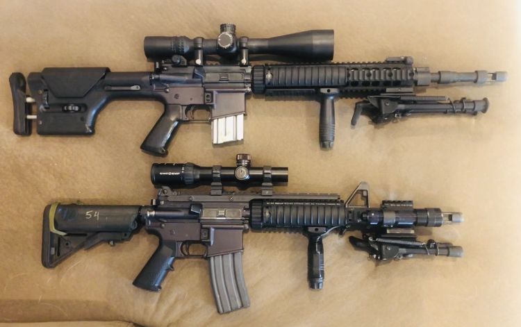

I've built an imaginary rifle in my head for exactly the same purpose. It always ends up being a 6mm Grendel variant, which I'm already set up for, 6mm ARC if I was starting from scratch.
17" rifle gas barrel, 7.5 twist, straight .750 contour or just a little lighter. Heavy buffer/spring, probably a APA gen 3 little bastard for the cherry on top.

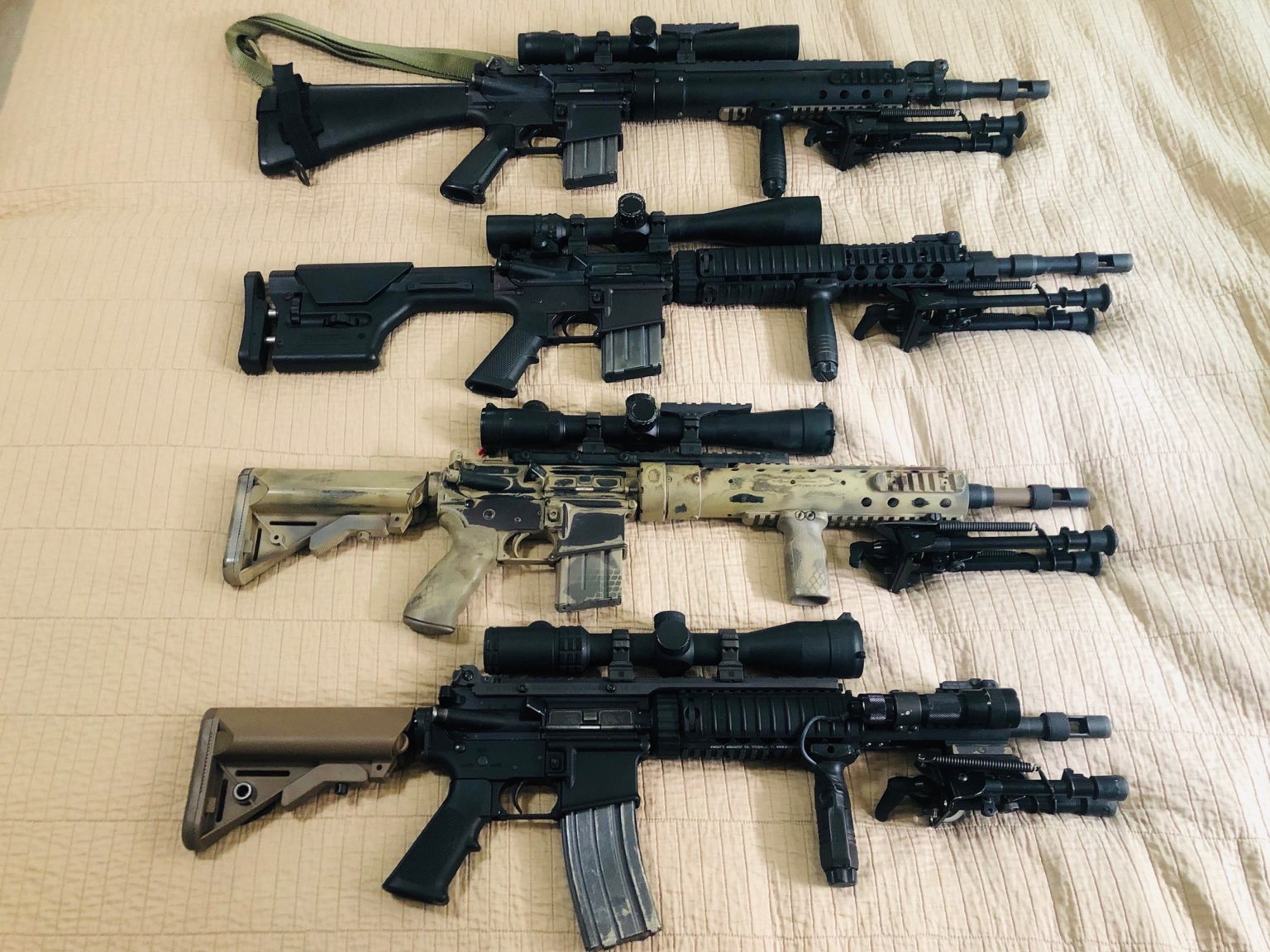

This would slot in nicely between my 22" 6mm Grendel that weighs 16lbs and the 12.8" 6.5 Grendel pistol I'll finally finish soon.
scar 20s.
sub moa with a chf cl barrel that should be able to handle mag dumps a bit better than some similar options.
light recoil, easy to keep on target with a clean running piston system.

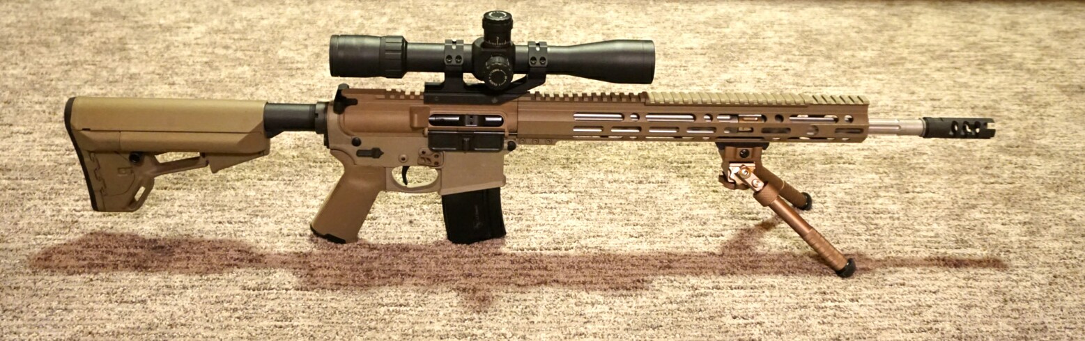

Honestly a 20" 6.5 Grendel will do all you need, quality ammo when available is usually under $20/box during normal times, there are surplus options from PPU and others for plinking.
Reloading is stupid easy, XBR, RamShot Tac, R15 and several others all work well in the Grendel, also due to the smaller case capacity you're usually getting anywhere from 240-250 loads per pound of powder.
I'd recommend getting a Quality SS Barrel in a 1-8 twist, it will shoot the 123SMK or 123 ELD's very well. Best Barrel for the money is a 20" Proof Research SS Barrel, also barrel life is very impressive 5,000rds easy before accuracy starts to drop off just as long as you take care of the barrel and don't treat it like a bullet hose.

I went through a similar decision several years back and settled on a fluted Alexander Arms 18" 6.5 Grendel barrel. It's a midlength gas system and it runs great, but I would have liked a rifle-length system if it was available. It has a standard carbine receiver extension & buffer, and it is 100% reliable with all ammo. Paired with an SWFA 3-15x scope & piggybacked Holosun red dot, it's a versatile & capable rig (~9lbs) that makes ringing steel at 600 yards boringly easy, even with unpredictable wind. I'm looking forward to stretching it to ~900 yards when I get a chance.
For what it's worth, if I was building this again today I would definitely consider the 6mm ARC as well.
Reactions: LRRPF52
I've got largely the same setup for my deer hunting / long range plinking rifle. 18" AA fluted 6.5G barrel, 2-10x Weaver Tactical. Weighs a bit over 9 lb, and maybe 1.5 MOA out to 600 with American Gunner. Not super happy with the accuracy but it's fun and my 129 ABLR loads have been great in deer.
I'd go with something like that, but 3-15 if you're in more open country and 6mm ARC if you're not worried about hunting or factory ammo.
