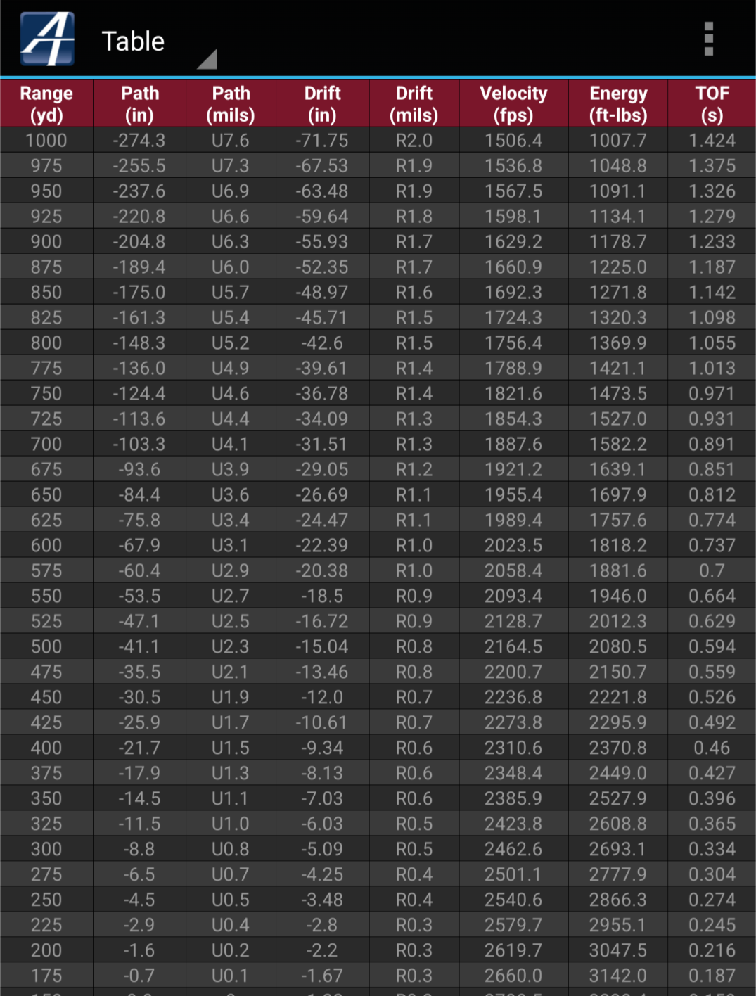

as for fps, i think you are referencing energy transfer. either way either caliber has enough energy to efficiently kill with. attached mine on a 26inch and you can see its well above efficient past 650 for either metric you want to use
Reactions: Nards444
