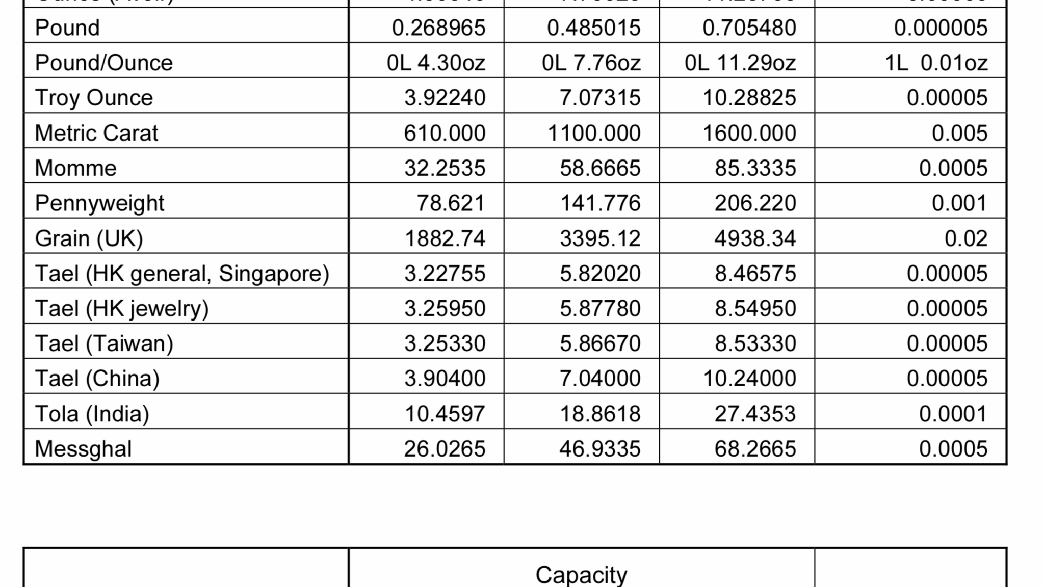

I ran across some chit-chat by some hobby jewelry kind of folks and read about this scale "Smart Weigh GEM20" for a whopping $25.00. Best money I have spent. My only complaint would be the automatic shut off feature. You hesitate and scratch your butt, damn thing shuts off. I like that it goes out two decimal places also.

I have that one and THOUGHT worked great, but found a big problem. It seems to have different repeatabilities at different zeros. For example, I can zero it with nothing on the platter. Place what's supposed to be 115 gr 9mm with 4.1 gn titegroup on it, zero it, and measure a tray of 50 rounds. Most will go back to 0.00, some will be -.2, -.3, -.4 grains light, some a 1/10th or so heavier. Makes sense since not all cases or projectiles weigh exactly the same. But if I empty the platter, zero it, and re-weigh all of the same rounds, the ones that the first time around all settled on 0.00 will now differ by .2, .3, .4, etc. If it worked correctly, all the ones that weighed 0.00 different when zero'd out should weigh the same overall weight, but they don't. And... the 10g calibration weight they gave always weighs exactly 10.00 g. I really don't want to spend $600+ on a lab scale, but I can't have weights that suspect loading titegroup. Anyone have one that's in $100 range that would pass a test like this?
My Gem 20 will do what you're saying, but the variance is hundredths of a grain, not tenths. I have often weighed the same charges twice with different zeros and it varies at most by one or two hundredths.
It is claimed to have accuracy of 0.0001 g, which is about 0.0015 grains, so while the readout shows hundredths of a grain, its resolution may not actually be that good. Still, I've never seen it off by anything close to a tenth of a grain.
