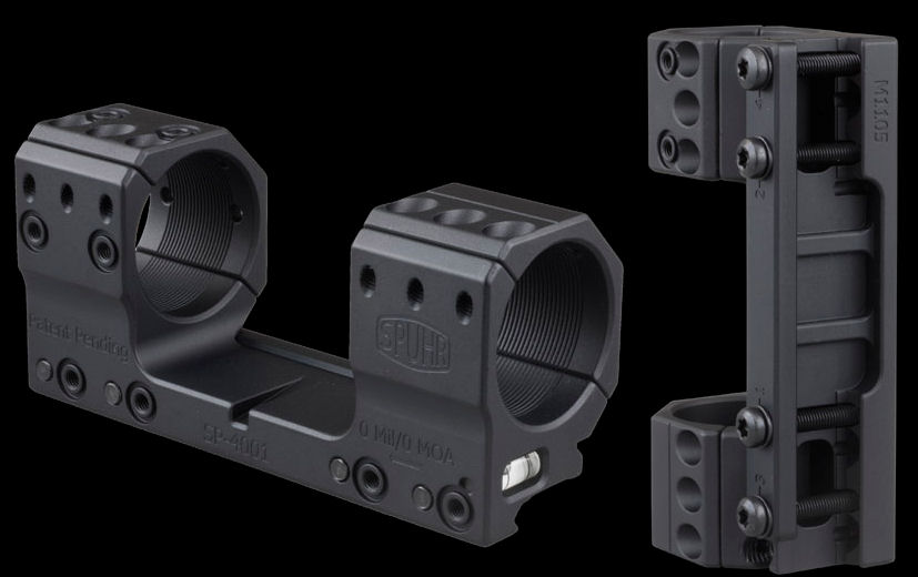

If you do not already own a nice set of rings, I really like the SPUHR mount with integral level.
By the time you add the cost of quality rings or 1 piece mount and the cost of a quality level, you really dont do too bad with the SPUHR, and having them integral, with the level protected by the mount housing is nice too.

My preference is to have the level in my line of sight when I open my left eye-I'm right eye dominant. I also run an angle cosine indicator. I currently run a Horus unit that combines the two but I'm converting to the Flatline Ops system. The Spuhr system looks nice and solid but I'm still choking on the price...even though I realize that when all is added up its only a bit more expensive.

I prefer the Spuhr. I have heard the argument that the resolution is not accurate enough. Well, when compared to a plum line I can tell when my scope is 100% level by referencing my Spuhr level. This has been confirmed with hits on man sized targets at 2200 yards- somewhere around 26 mils of elevation adjustment and NO cant induced error.

The Spuhr is the only level I have been satisfied with.

i just picked up a one piece SPUHR along with the leveling tool (i also checked the leveling tool against my feeler gauges just to make sure). While mounting to my rail last night (its a surgeon so i know it is strait), I began to question myself and the mount. While standing behind the rifle and centering the bubble level the crosshairs looked a little off then while lying prone next to the rifle the bubble was off by about a third of the tube. I am wondering which position is the scope actually level?
Hmmm, i have spuhr mounts on al my rifles, and none of them show any bubble errors the way you describe. What i always do to check the buble, is to mount the spuhr on the rifle without a scope, than put a profesional bubble level ontop of the mounted spuhrmount, and sofar all spuhr bubles were dead on.
