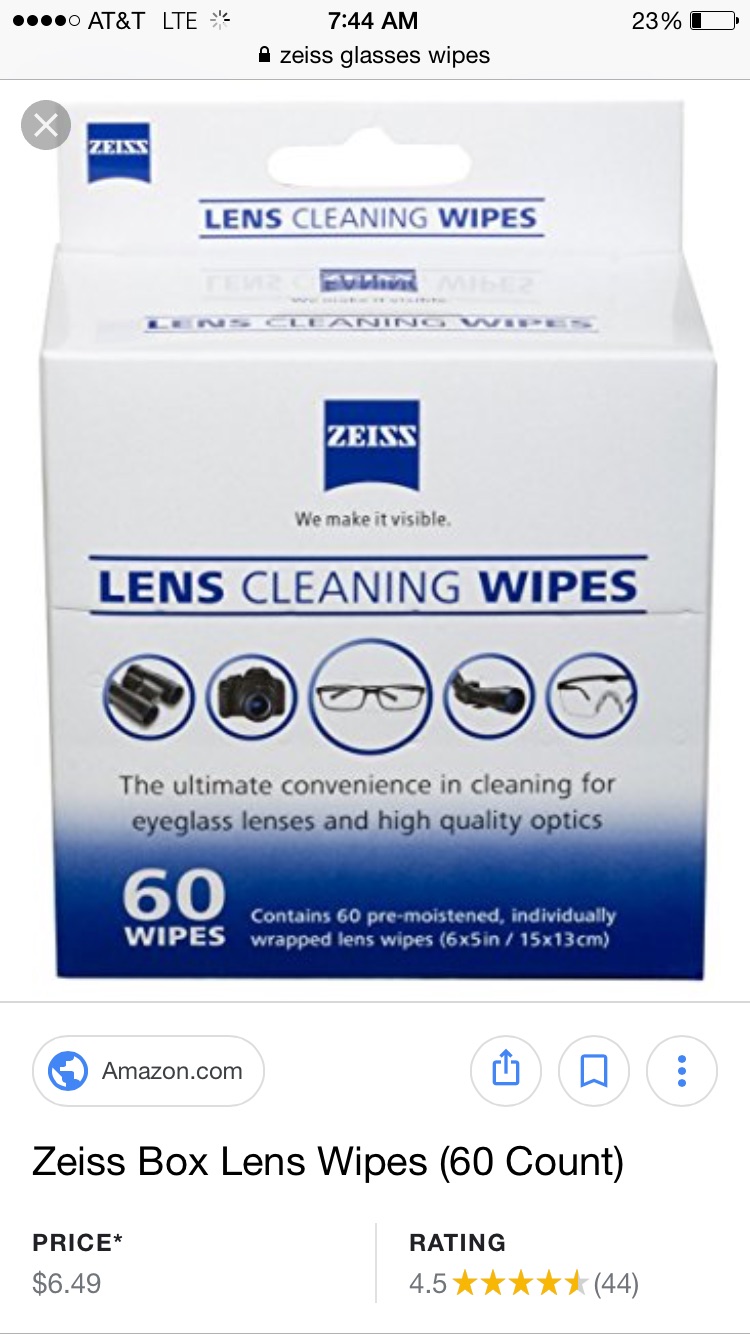

Are these good to go for field cleaning?
buy a box open a packet and smell it and i bet its rubbing alcohol thats packaged for Zeiss...and with Zeiss printed on the box im pretty sure its ok to use.
It is. They also work fine for hand wipes. They are all over my gear so I always can find one in a hurry.
Just be careful you don't leave the ripped open packets all over the place....those square wrappers..

The Zeiss wipes left my prescription glasses completely ruined within about 2 years. For my next pair I switched to washing them with dish soap and water or alcohol based lens cleaner and a soft cotton cloth - replacement pair of glasses still look new after 2 years. I don't trust the Zeiss wipes after that experience.
Reactions: Ravenyzf-r6
What exactly about the Zeiss wipes caused your lenses to be ruined?
Were they glass lenses or some type of plastic/polymer?
