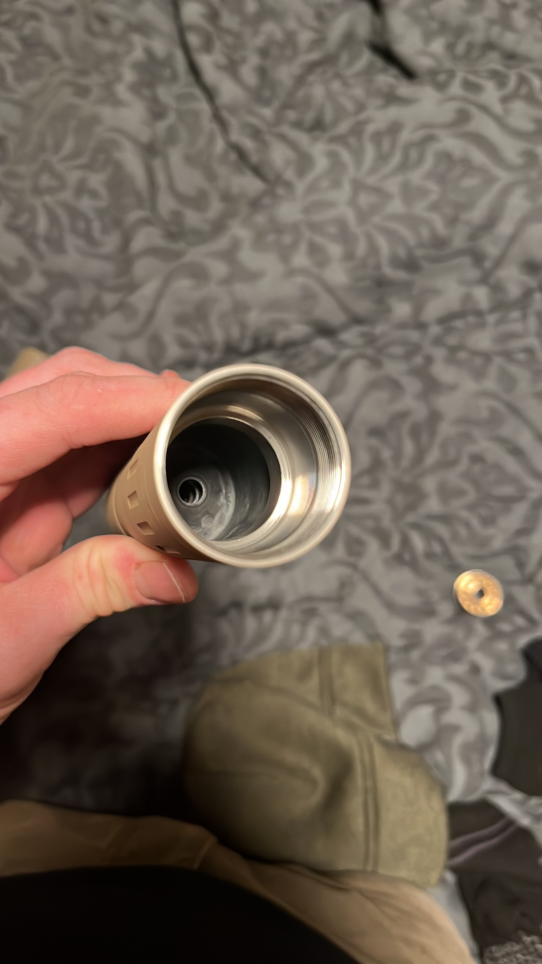

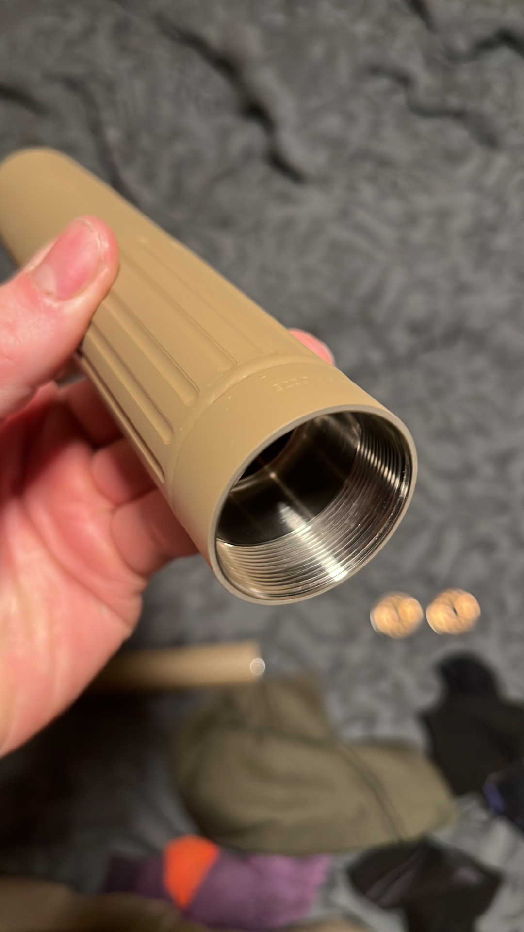

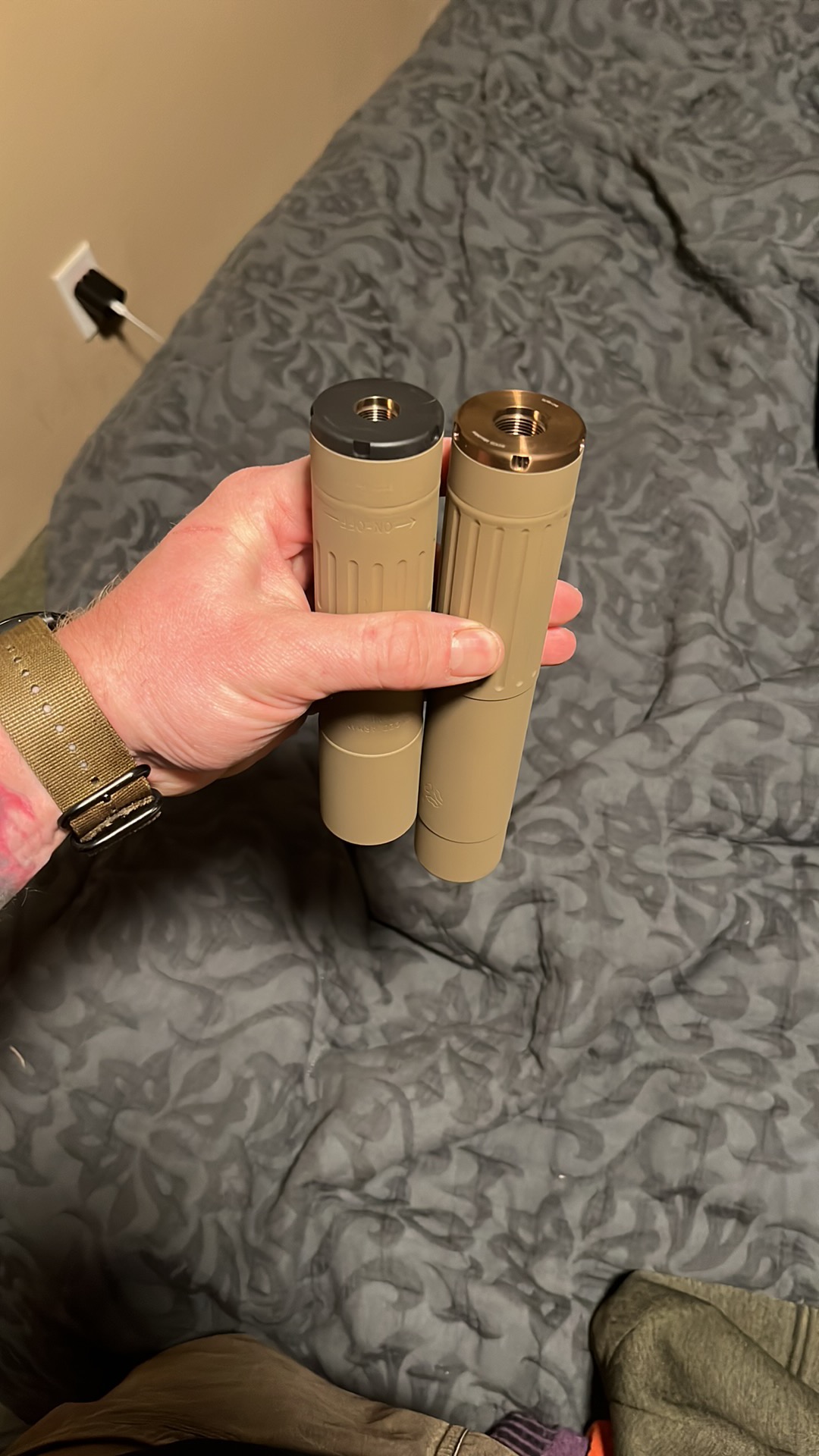

So @smacha538 and I both had our cans converted over to use the Q cherry Bomb. I havnt used mine on a precision gun, but I have beat the piss out of it on a 10.5” M16 and zero complaints.
I know @smacha538 had a rifle go from 1”+ to sub 1/2 getting the can away from 51T
Honestly had I known about them earlier I doubt I’d own my thunderbeast 338 can, but it does sound insane on a 20” 6.5PRC

I had my SDN-6 converted at ECCO and it’s been great, started with a plan B mount and cherry bombs, but they got full of carbon really fast and would scrape carbon while removing after they had been undcrewed. Switched to Area 419 hellfire mounts and am extremely happy that I did. Now I can use suppressor or 4 port match brake, and the mount adapters are relatively cheap for all of my guns.
