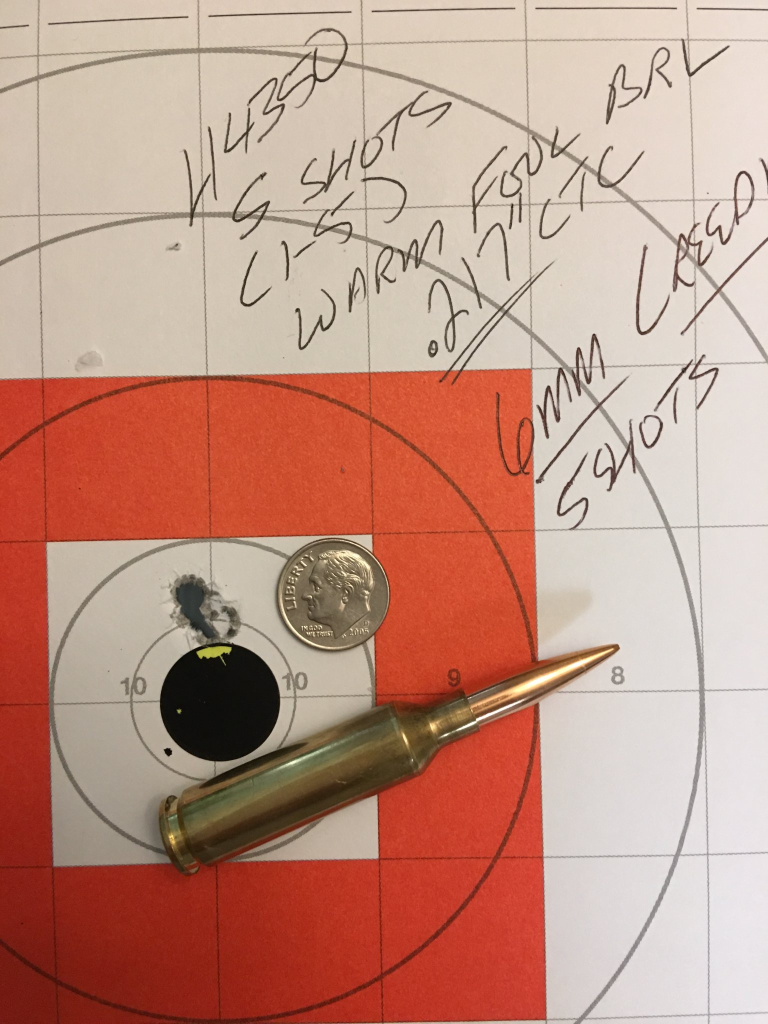

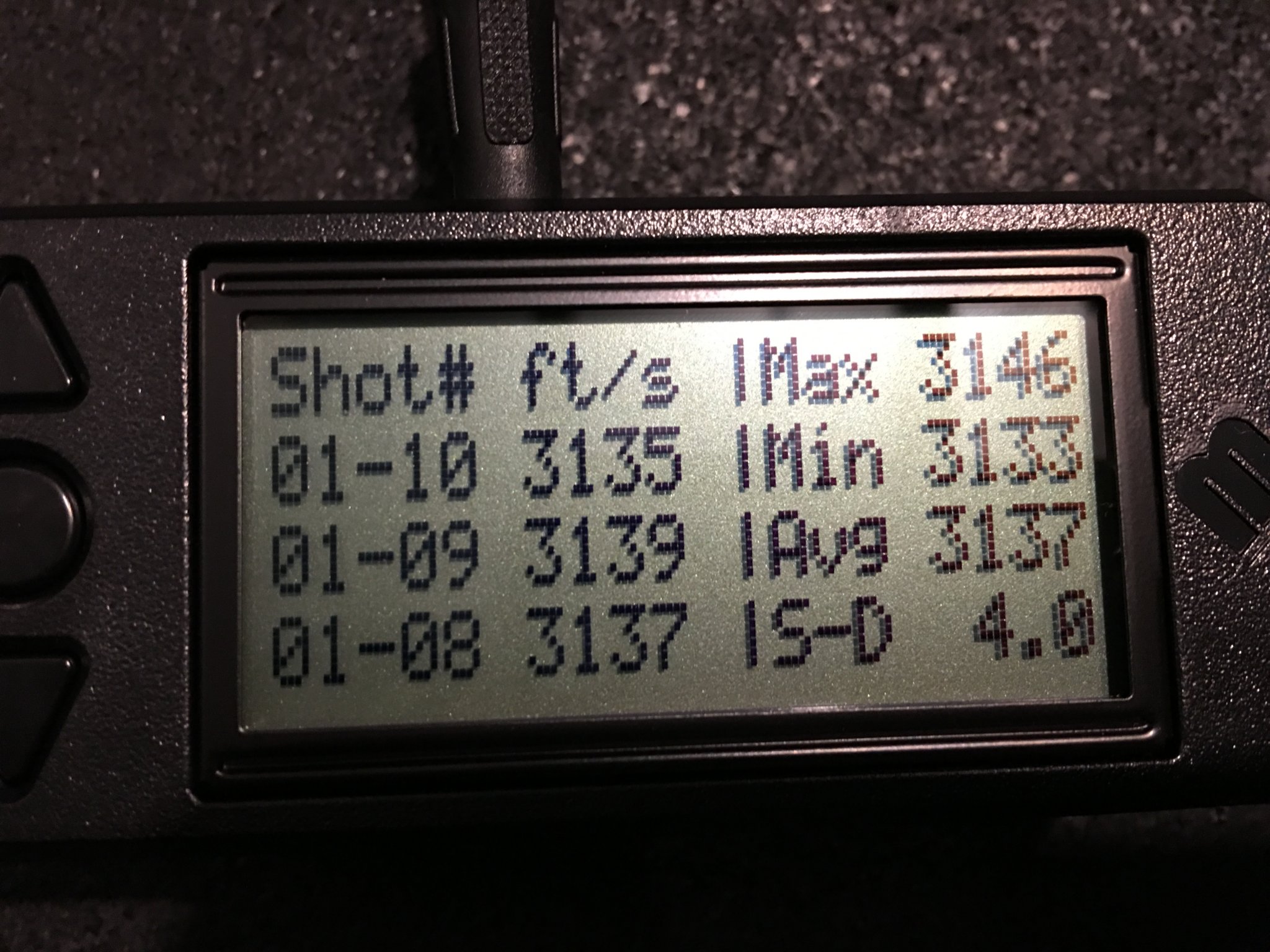

6mm Creedmoor for me. Load development was easy. Seond load gave me little 5 shot groups at 100 yards. Several 10 shot strings over the chronograph posted SD’s from 4.0 to 7.5. I am shooting a Impact Precison rifle.
