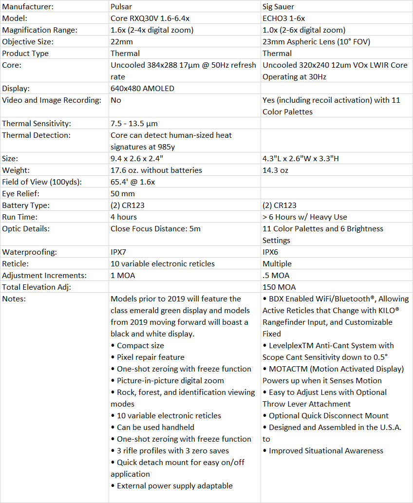

    I am a noob when it comes to thermal's and hoping someone in the know can fill me in on "cheap" thermal options ($3k and less). Have had my eye on the Pulsar Core RXQ30V Thermal but wondering if this new Sig would be something I'd enjoy more.

    Again, not knowing anything about Thermal, just doing a quick comparison of the ECHO3 to the Pulsar Core RXQ30V I get the following:
    Not much is known yet on the Sig other than the little information Sig put in their press release and from their website. As I've tried to self educate on thermal's while the Pulsar has a larger core, the Sig has a smaller µm value - not sure if this is better or worse. Also, Sig lists refresh rate at 30hz while Pulsar is at 50hz and my understanding is that the higher the hz the better the display responds to motion so one would assume the Pulsar would perform better with objects in motion or if you are moving the scope around. Finally, I've read that having a lower resolution core can be made up with a higher resolution display, etc. but Sig does not list the resolution of the actual display so not sure how that will rate. Again, anyone with better understanding of how all this works - I am all ears.
