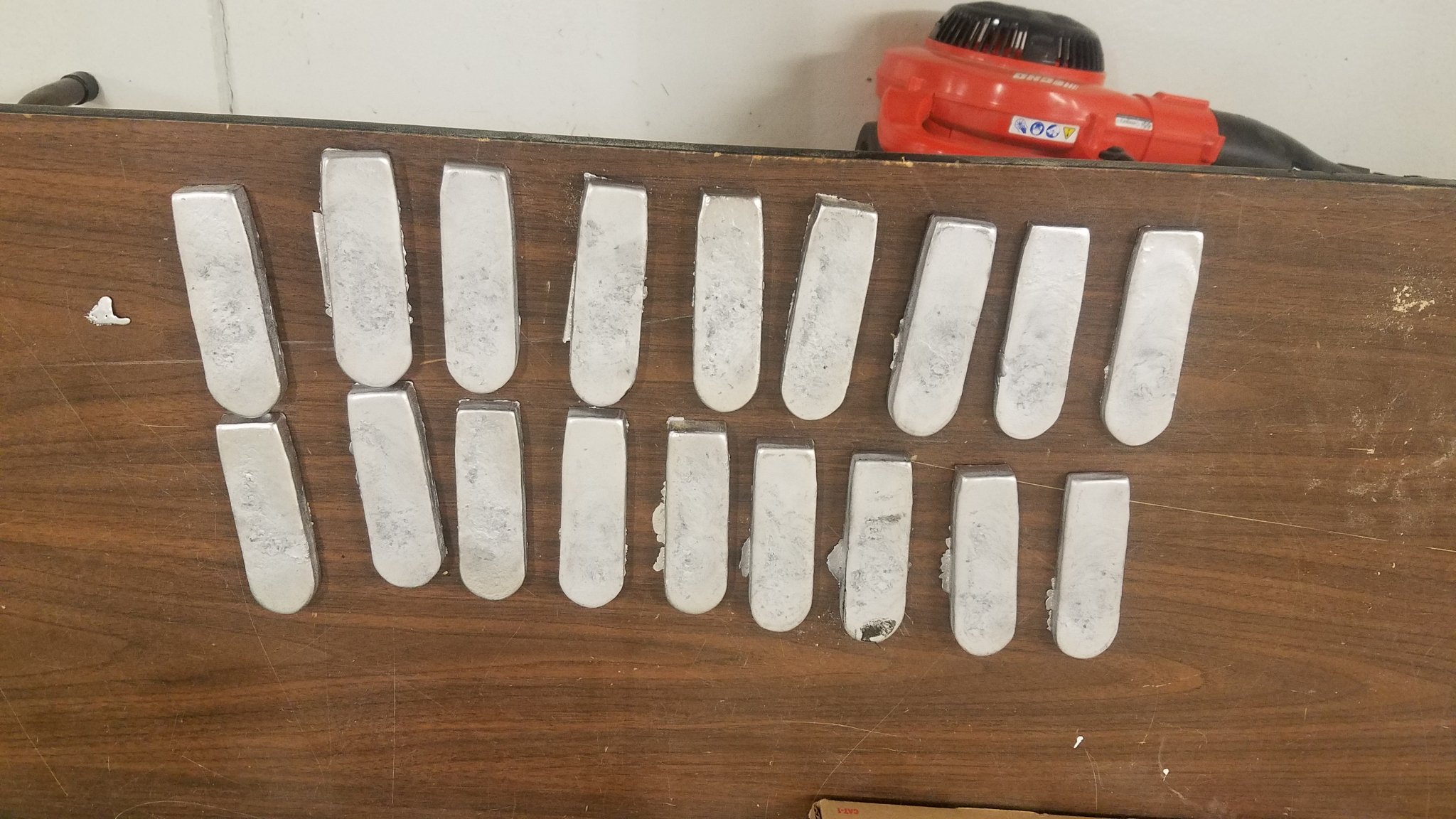

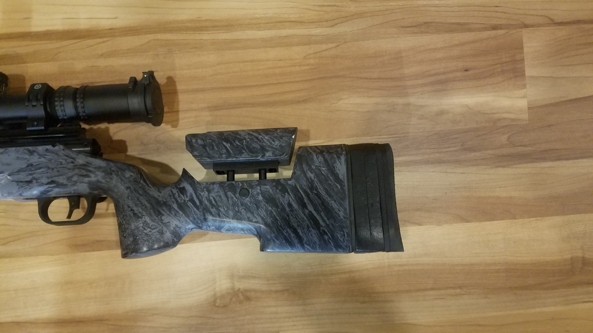

Cast spacers or whatever from lead.
Files to shape easy (take necessary precations) paint with epoxy to seal.
