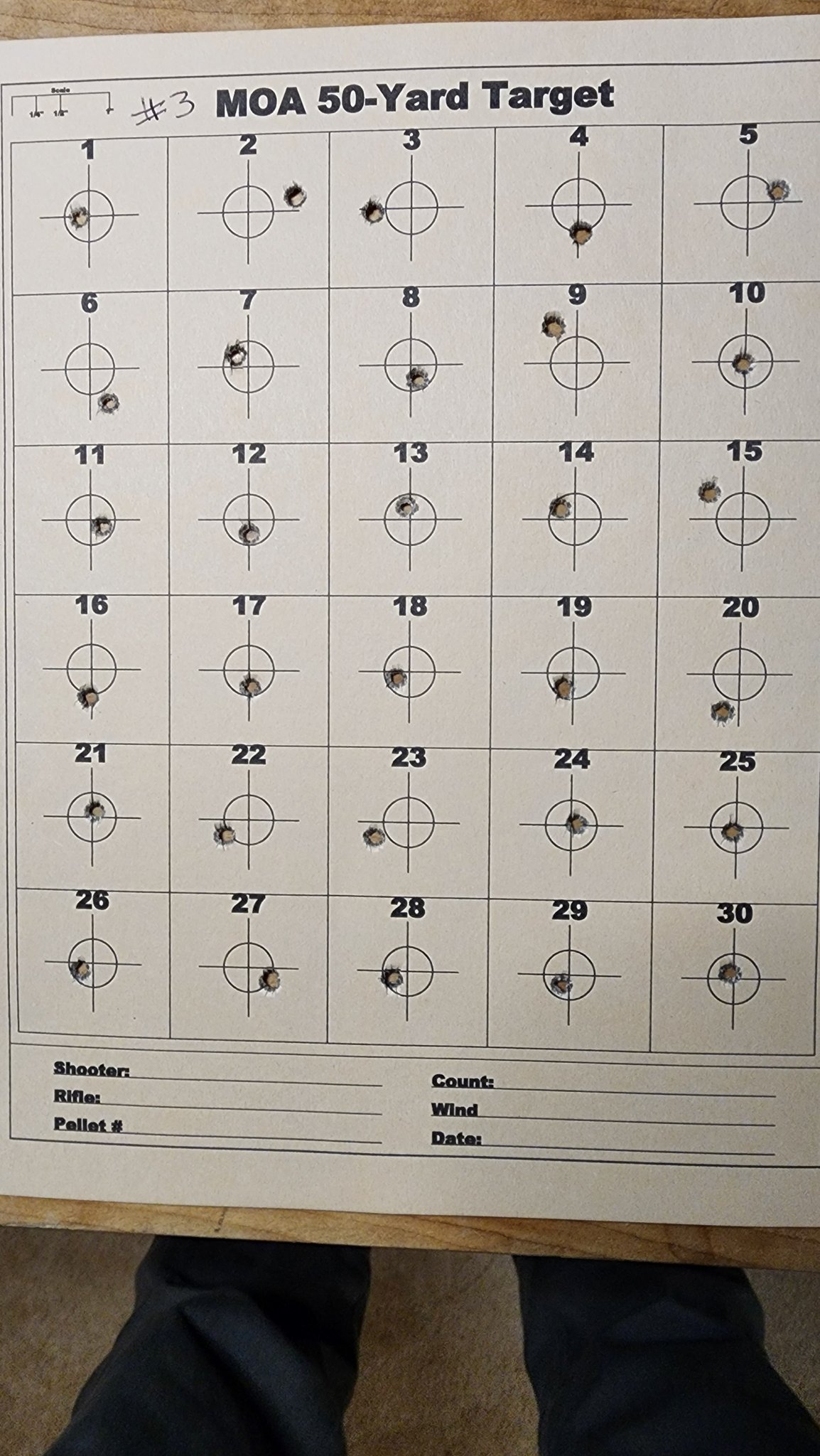

Yesterday at 50 yds with no wind...

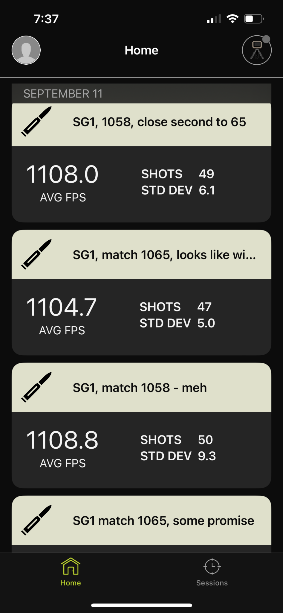

You just reminded me that I need to get my Labradar out and use it. I bought it for my centerfire loads, but never think about it when I'm testing rimfire ammo. Doh!!!
Right now, I'm limited to my 50yd range here at the house, but at least I could see SD and ES.
BUT, I should have been using the radar....
