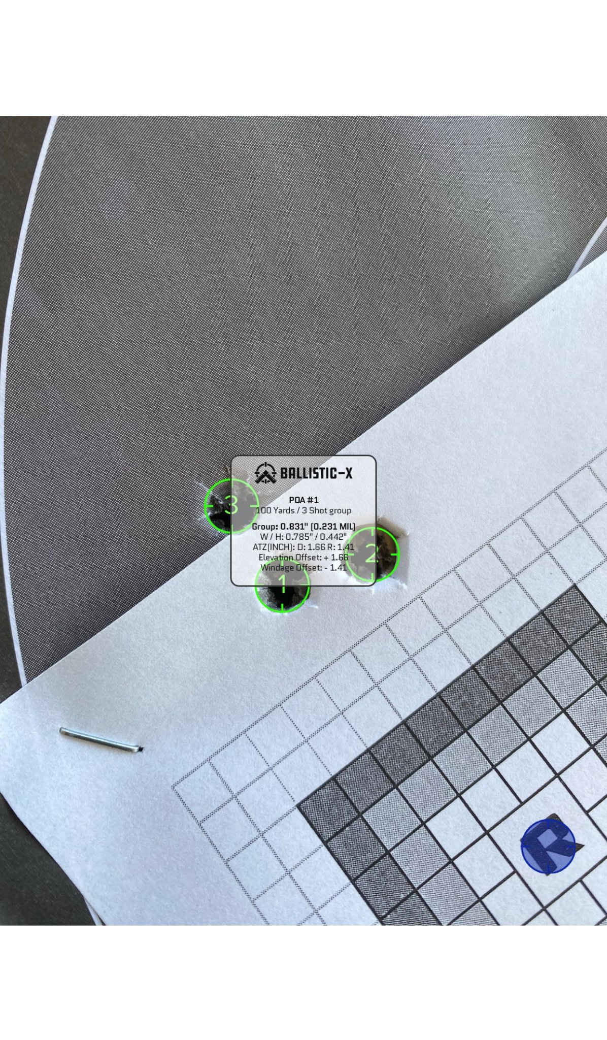

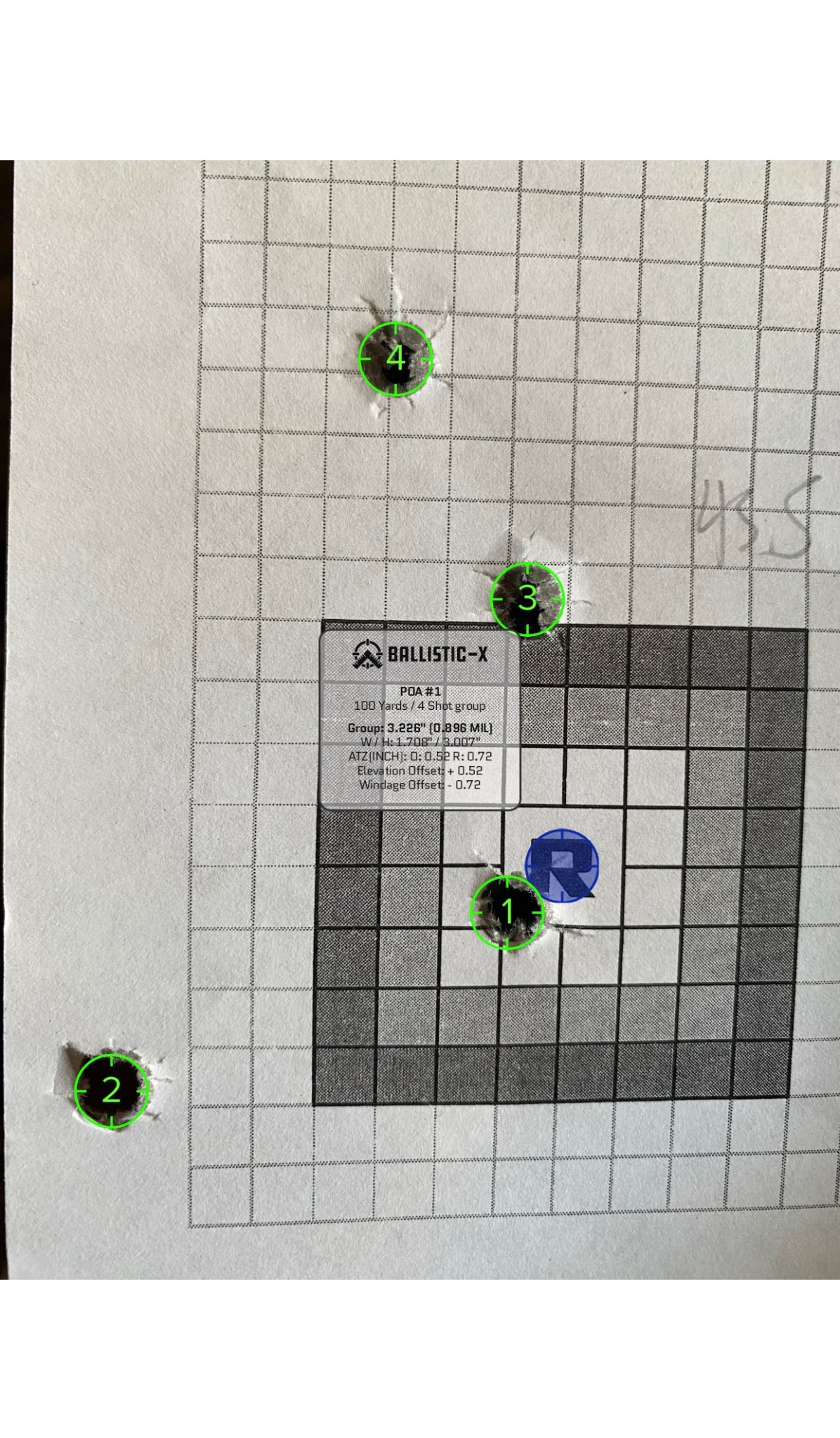

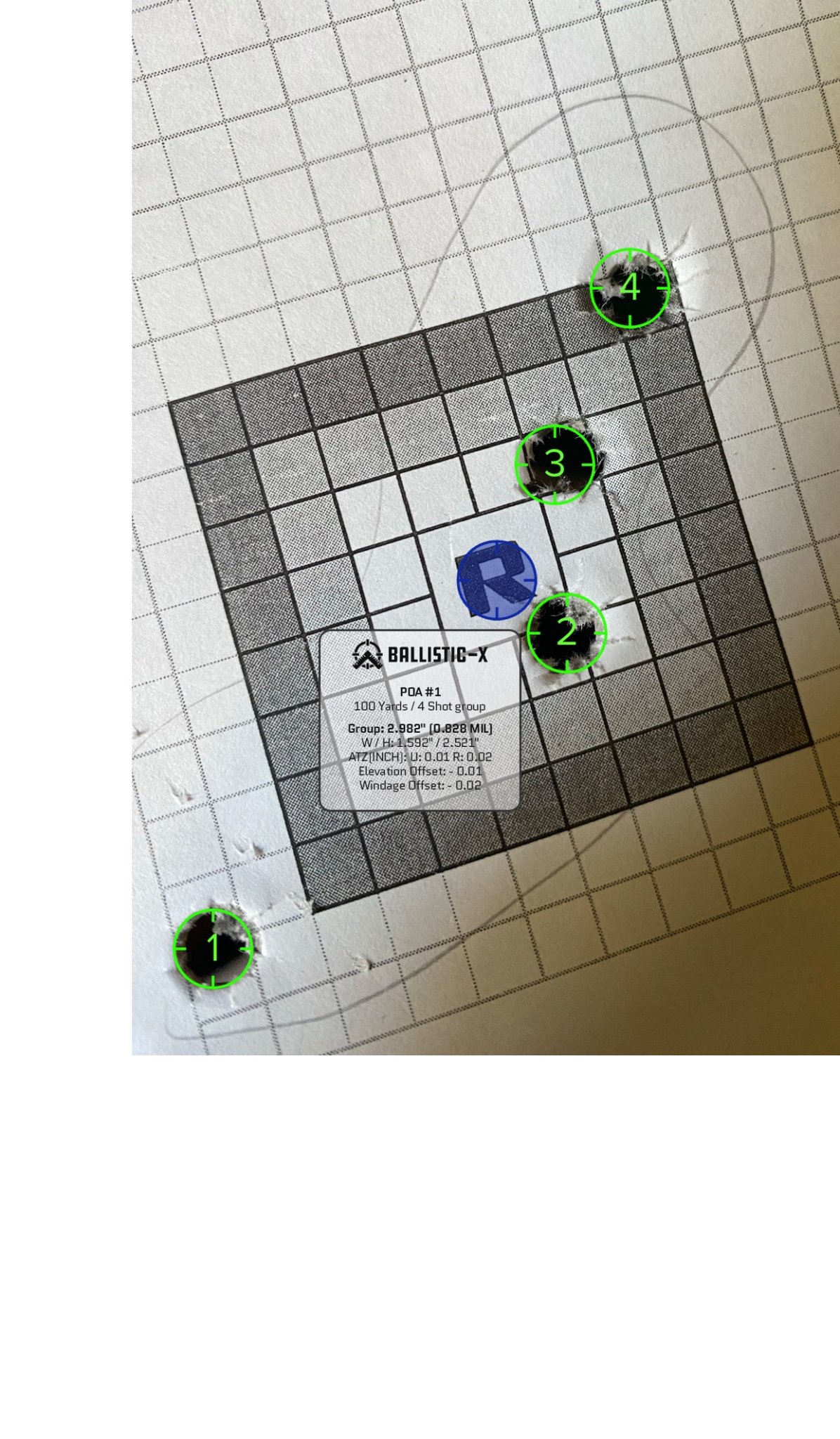

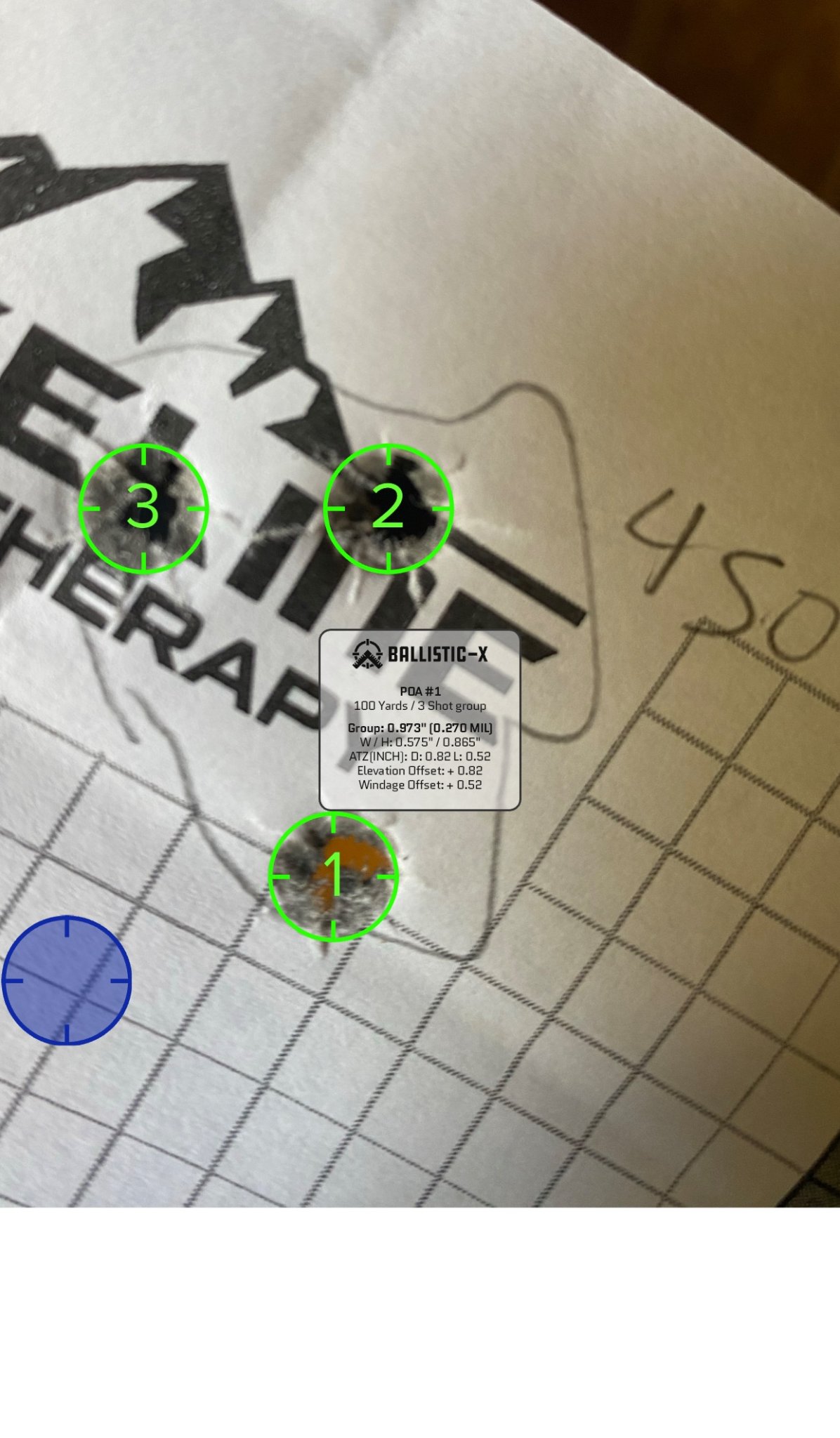

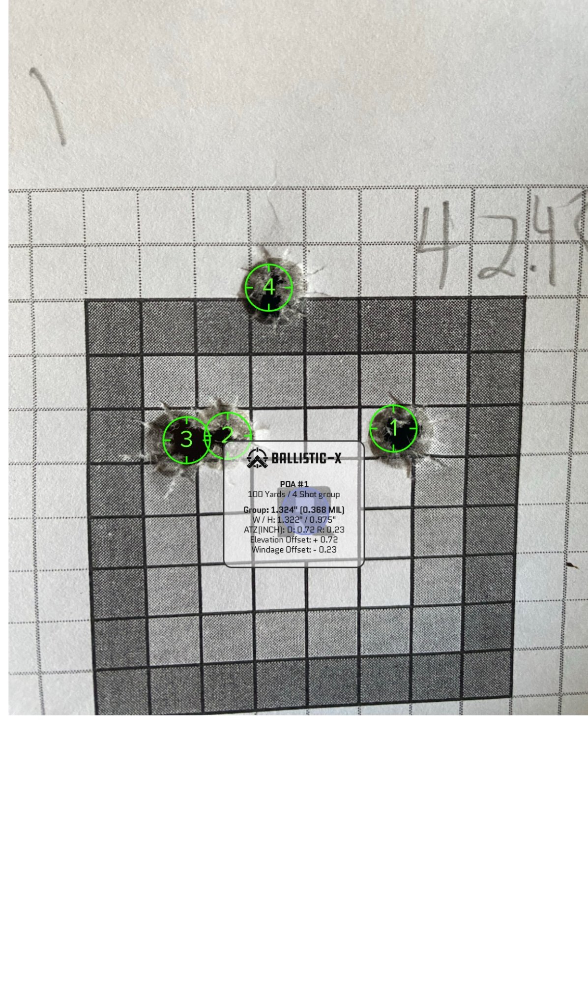

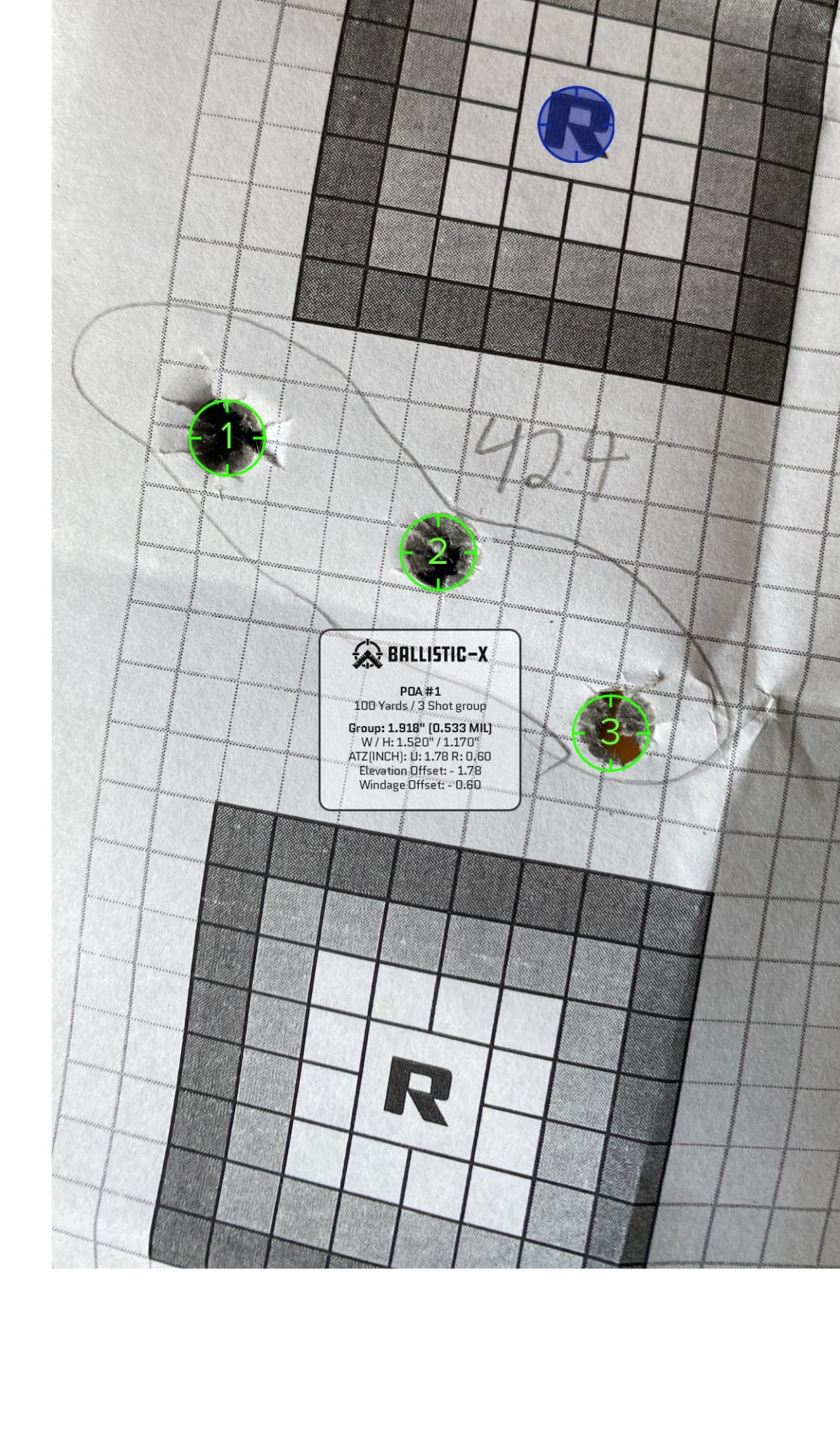

I'm new to reloading and this is my first workup for a load. 1st one foremost the goal is to build a load I can shoot that shoots well (under 1MOA) but will double as a load for hunting whitetails inside of 400 yards. The gun I'm using for this is a Remington 700 varmit that I've had for over 10 years and is somewhere in the 3500 round mark of factory loads, prior to starting reloading 2 weeks ago. Thus far I've reloaded approx 40 rounds and the groups are atrocious.
-Gun : Remington 700 varmit chopped down to 20in, with Silencerco Omega 30 call, KRG Chassis, Glass has been a mix of Leupold Mk5, Bushnell Elite, but currently has a Arken 4-16 on it. I see the gun as a constant, nothing is loose and I can shoot control groups with 168GMM, 175GMM, 178 Hornady A-MAX, Speer 168 Gold Dots, Sig 165 Elite Hunter, Federal Premium 180s with Nosler Partitions and really any other factory round that is considered high quality and the gun in it's current configuration will absolutely shoot 1MOA or better across all of those rounds at 100. I can shoot .25 groups consistently out of my AI and .75 out of DD5 work guns so as a shoot I'm also a constant. Obviously some days are better than other but I'm a more consistent shooter across the board than what I'm seeing in my hunting gun with my current reloads.
- Reloading setup : RCBS Single Stage RC starter kit with powder Trickler etc. Hornady G-3 scale for powder measuring.
- Current load workups are on a Hornady 178 ELD-X, Once fired Federal brass ( Most of which were shot out of work rifles not my personal Remington) this is also a constant as I have a large amount of once fired federal brass and don't ever plan on buying .308 brass, Using CCI primers, and Varget powder.
-Process
Step 1- Clean brass in media Tumbler- I don't do this per load , ie I have 1000+ tumbled clean once fired bass.
Step 2- Lube Cases with RCBS lube and pad
Step 3- Resize, de prime, re prime case
Step 4- Measure powder Started at 41gr then worked up to 45gr
Step 5- Add Powder
Step 6- Seat bullet. OAL of 2.8
Step 7- Shoot bullets for accuracy and velocity checks.
I'll post pictures of some of the groups I'm seeing in a few.
These groups are all over the place. And I’m not changing anything in my process other than powder charges. What would cause such a wide dispersion? Also regarding powder. Are some manufacturers or powders known to burn faster or slower based on brand etc?

The last two aren’t atrocious at first glance.
Consider trying a different powder or bullet. Sometimes a combo just doesn’t work in a particular barrel.
ETA: sifting through three round groups isn’t the most reliable IMHO, except for rejecting the really bad, slow, or over pressure stuff. I’d retry the two that don’t totally suck with 2x5 of each before swapping components.
