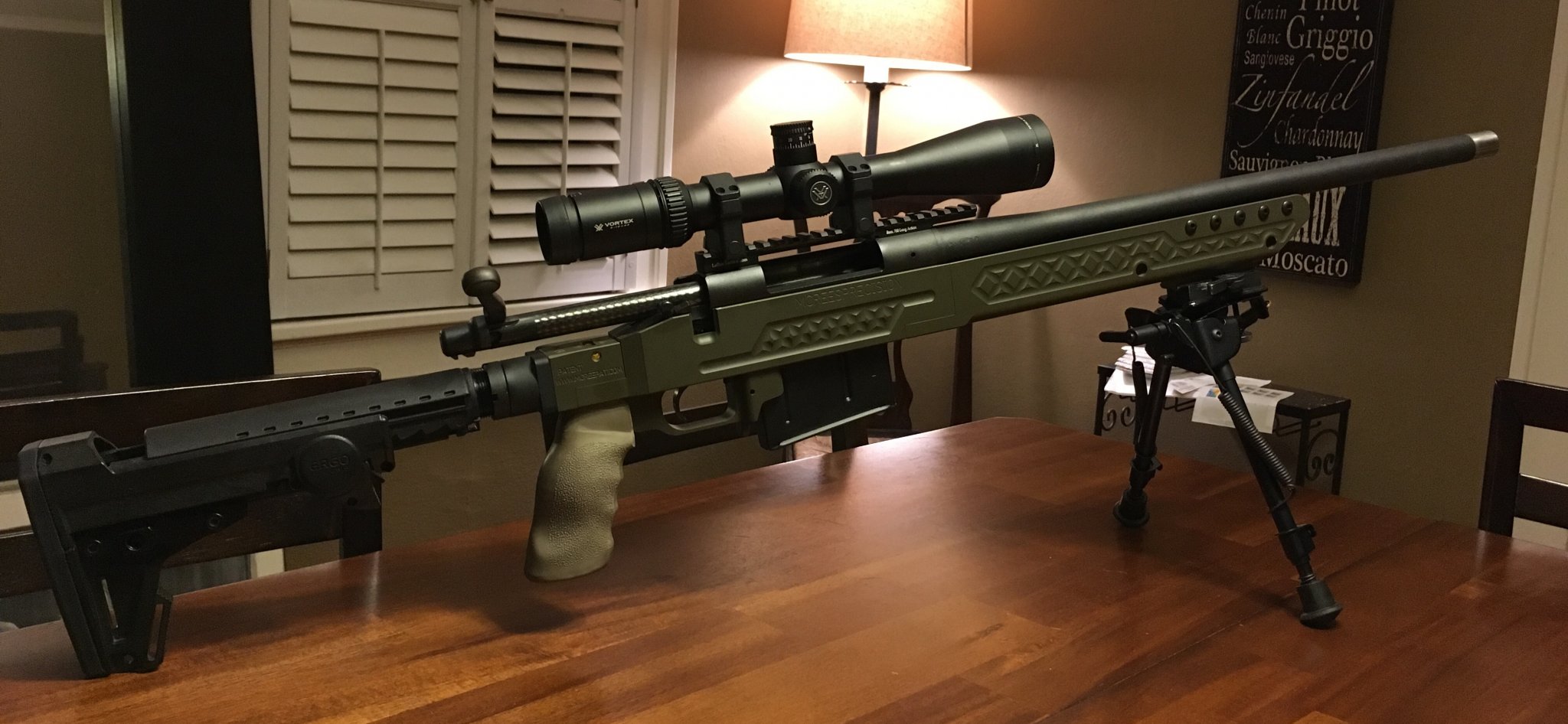

I’ve got a sendero chambered in .270 that I ended up taking into have rebarreled or something months ago... I ended up just having the barrel cut from 26, to 20 and put it in a McRees Precision chassis. I got the stock for ~370’ish, one section of picatinny rail for a bipod and a magazine, added the Calvin Elite trigger... and really didn’t have a goal after I decided to not rehamber it (long action...if I was in your shoes I’d get it rebarreled, maybe or maybe not...) you could try a couple of upgrades and if you still wanted to rebarrel it, can always do it and use the same chassis, and other add ons in a lot of cases.
These mods got this ol girl in the rotation for range trips again... after being my 2nd deer rifle nearly 20 years ago...
Shoots a substantial amount better after the chassis and trigger.
