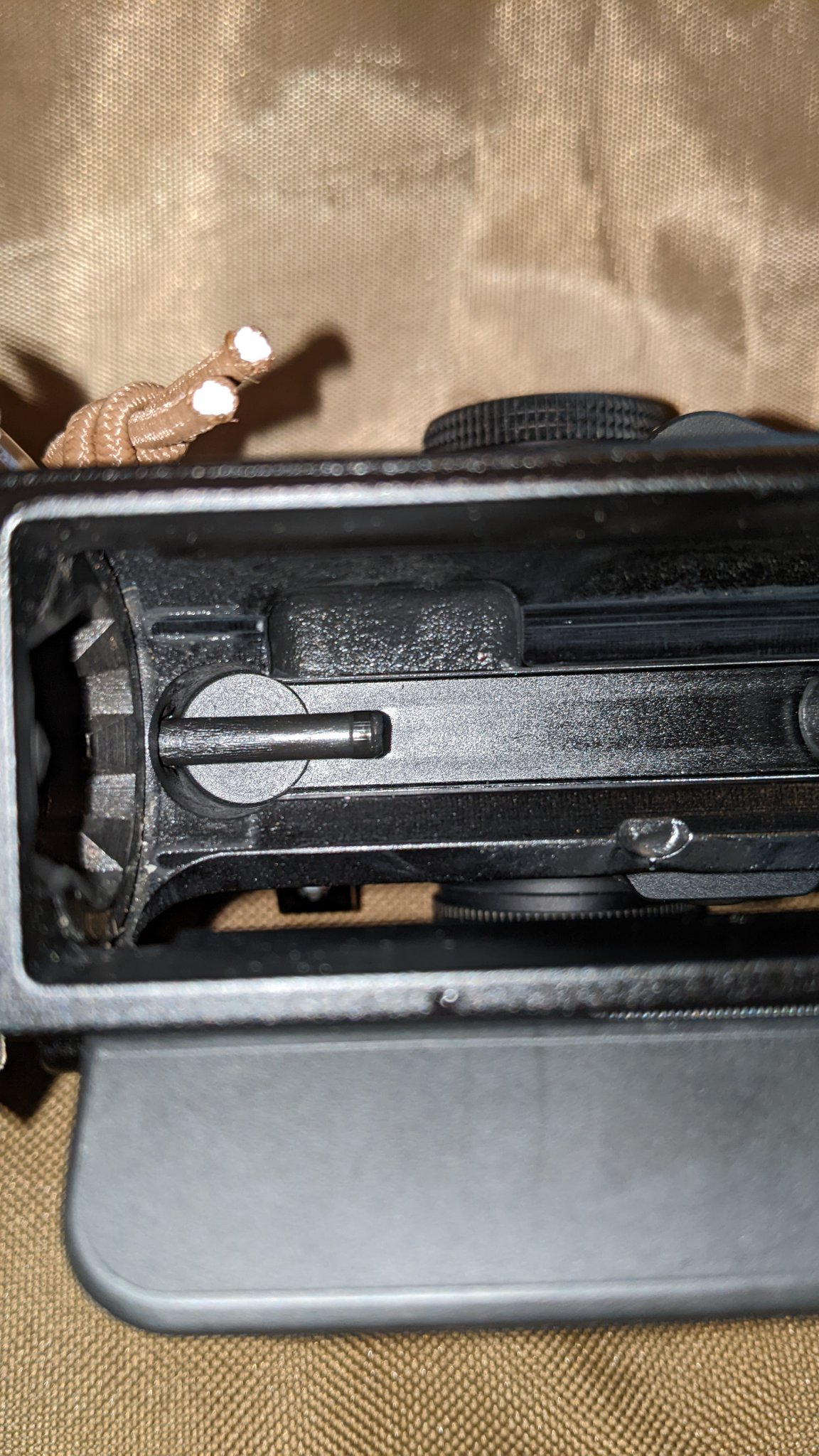

Per the response with gas tube termination relative to the cam pin cutout... I am using the 2A Xanthos upper. The cut out for the cam pin is squared off, not a semi circle. I assume it is located at the same point as other semi circular cam pin cut outs. An AR15 rifle gas tube looks longer than the first pic, but shorter than the second. Thus my concern over this barrel possibly being between the two standards.

Pic below of what an AR15 rifle length gas tube looks like in a 2A Xanthos.
[sorry, can't see the pic, insert Stevie Wonder "Ican't see shit" meme]

can't see the google pic.
My gas system from front of receiver to back of gas block is 12.925" best I can measure. With a new AR10 15.5" gas tube from Wilson Combat, my gas tube protrudes 1.1" to 1.125" into the receiver.
It certainly seems I have a gas system about 0.1" shorter than true AR10 length. This is causing my gas tube to extend 0.1" further into the upper than it should.
Currently, my AR15 rifle length tube short strokes, but the AR10 tube is bottoming out in my JP bolt carrier by just the tinniest amount.
Soooo is this a common issue with Wilson Combat? Is there anything I can do besides trying to get a new barrel?
