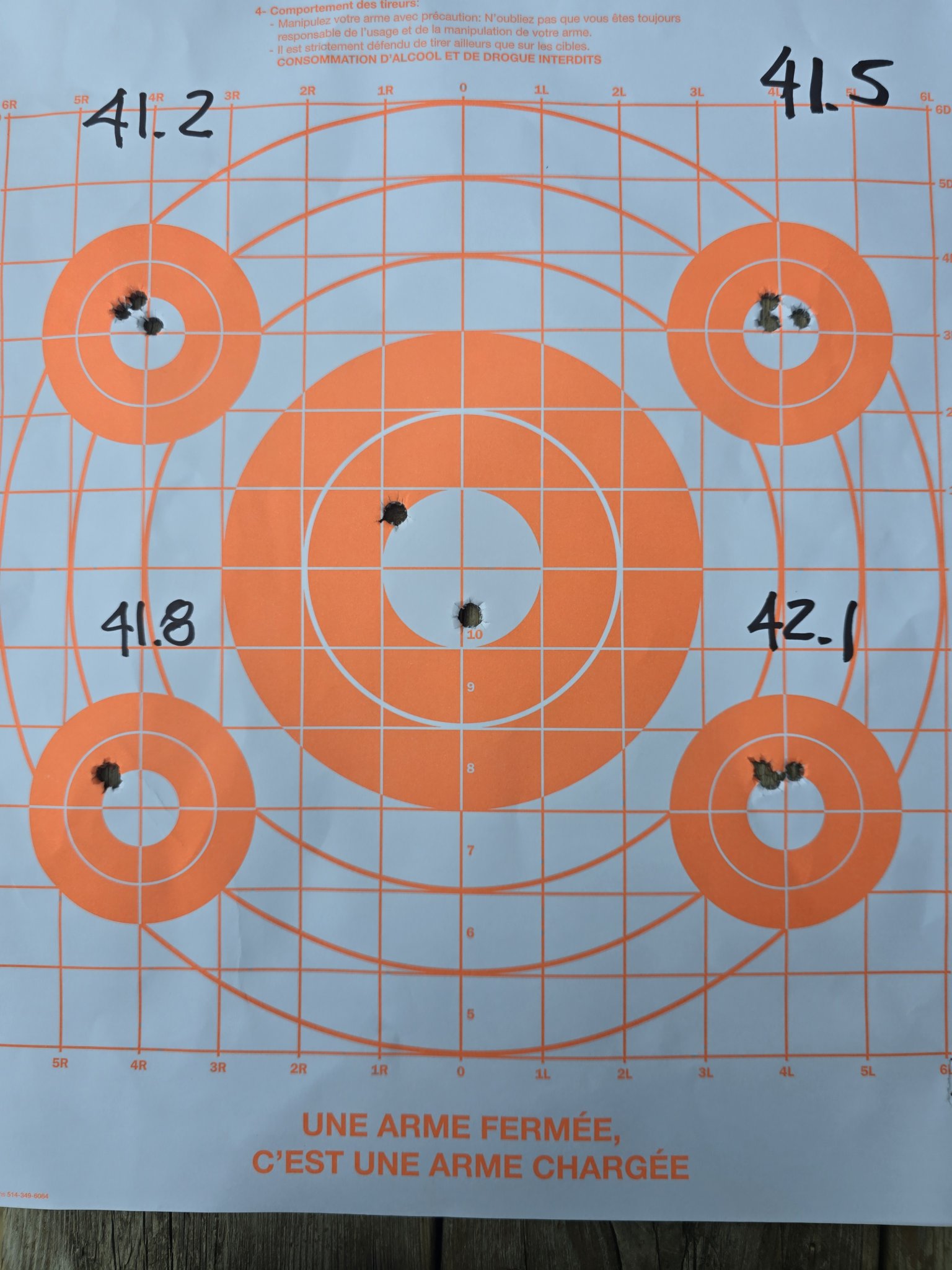

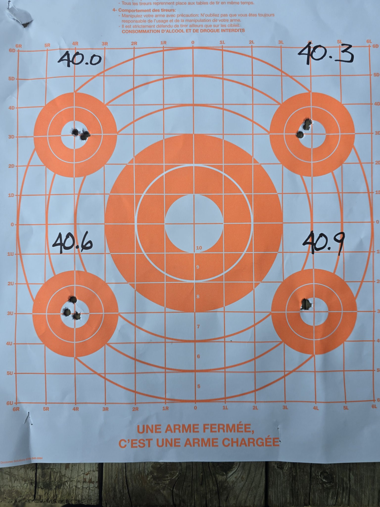

Hi guys....
For your experienced shooters. Where's the node on my 8 differents loads ?
6mm Creed
Berger 105 hybrid
H4350
.030 from lands
100 yards
Lapua brass
Thanks

It's much easier to see when the series of shots are all along a linier line. Given what we're looking at here, I'd test some loads between 41.6 and 42.0 to see.

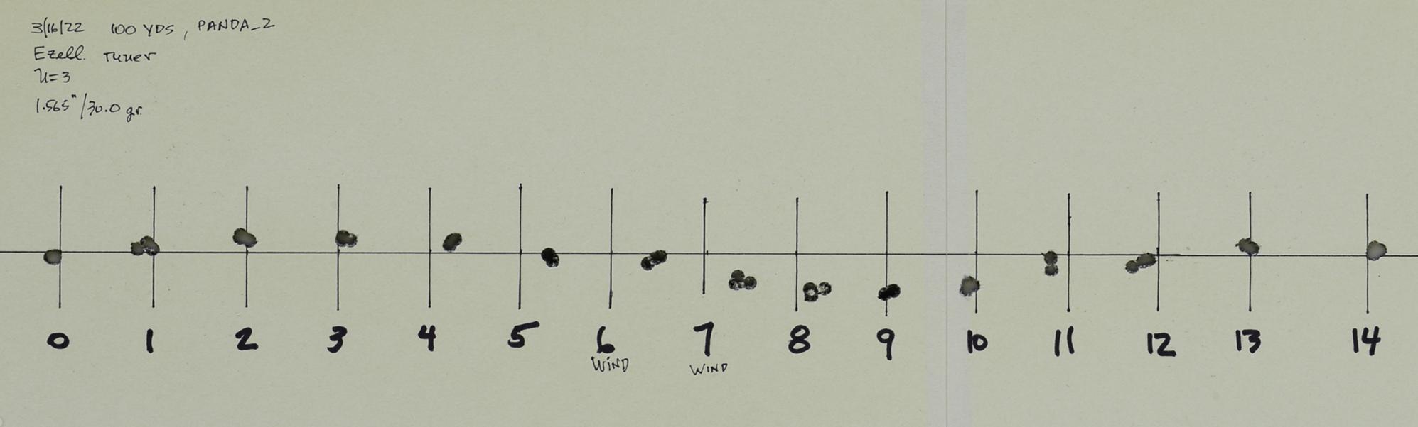

Then how do you explain this?
Same load and virtually identical velocities, only changes in tuner setting (and it's repeatable):
Here we go.
Don't waste band width. Explain it. So far we have.
Speed effects trajectory which effects POI. What effects you trajectory at 100y? Ummm... Where the barrel is pointing....🤣🤣🤣
Which is the reason some of us shoot OCW, to find a range of charges with the most similar trajectory. I.E. the barrel pointing in the same place when the bullet exits. I.E a node.
Look, the problem here is that whenever any kind of shit like this pops up around here, inevitably a handful of true believers come out with knives and torches and line up to yell some form of: you don't know shit/I've been doing this longer than you've been peeing standing up/that's the way I've always done it/look at my less than statistically useful number of pieces of cardboard with holes in it/etc..........
Except, those guys are the ones that don't know shit, because they believe they already have it figured out and can no longer learn. So who gives a shit that none of what they cite as proof is statistically relevant? It's a Rorschach test, and they will see what they wanna see, period. And, for some reason, they need other people to believe too... So they keep preaching their BS on forums like this over and over so the myth never dies and they can recruit more cult-members shooters to agree with them.
Well-thought-out brass prep and dropping every charge to the kernel is really all it takes. There's no magic load, if you can make every round come out the same as the next and it doesn't shoot, you're the problem.

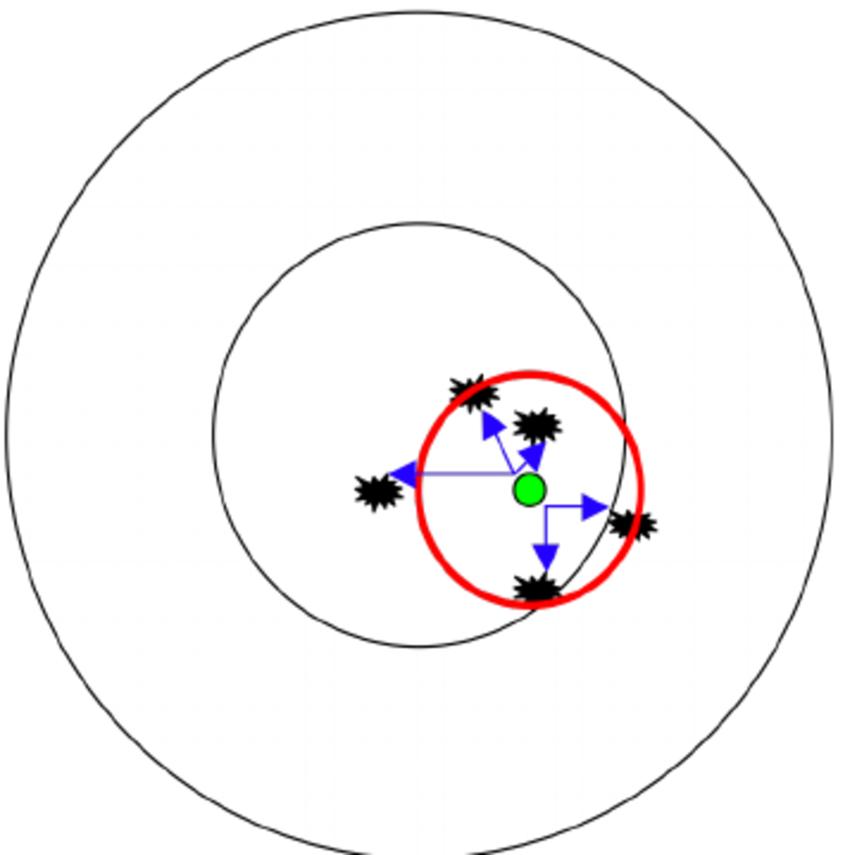

That would be nice if anyone want to shoot that many rounds out of a gun that shoots in the .1's. :eek: There are many different examples that have shown the same sine wave pattern (e.g. https://forum.accurateshooter.com/threads/tuner-test-results-confusing.4085273/page-4#post-38561382; https://forum.accurateshooter.com/threads/tuner-test-results-confusing.4085273/page-5#post-38562235). If one isn't able to shoot such small groups where the pattern is easy to see, it can be a little difficult to see it. . . unless one uses software like OnTarget to get the Mean Radius of the groups and see those centers and how they relate.

I understand this statistical issue you're talking about. It's particularly true when trying to determine how much or how little dispersion one can depend on.
I can tell you for sure, it doesn't take much to see how a tuner can move the POI. Just a few weeks ago I was shooting my favorite .308 loads that I usually get around .4" (some a little higher, some lower). This was a hot morning and my POI was not where it usually is. I decided to change my tuner setting by a couple increments. The first shot POI with that setting went way high and left. I looked over to my shooting buddy and shrugged my shoulders thinking I just somehow pulled a bad shot. Focusing on my best mechanics, the next two shot went right up where that first one went. I was so surprised that particular tuner adjustment moved the shot so far. So, I moved the tuner setting back to where it was, and voila, POI went right back to where it was.
Seeing my POI move with my tuner adjustments when I'm working up a load is easy to see. . . all the time. It's just like those pics I posted above.
Seeing my POI move when I'm working up a load is easy to see. . . all the time. It's just like those pics I posted above.

Any chance that test represents a little over 1 full revolution of the tuner? Like there are 10-12 settings per rev?
edited after a closer look.

Because the POI shifts at 100y are bigger than the velocity swings could cause. And because you never answered how that explanation could cause a POI shift at 100 yards. You just threw a fit and stapled yourself to a cross.
