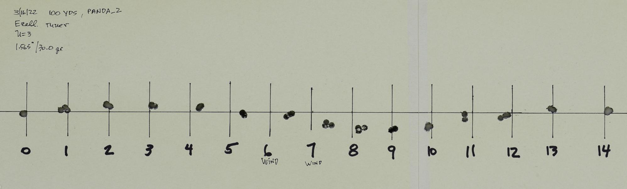

Because the POI shifts at 100y are bigger than the velocity swings could cause. And because you never answered how that explanation could cause a POI shift at 100 yards. You just threw a fit and stapled yourself to a cross.
If someone is experiencing noticeable POI shifts at 100 yards, then they’d be better off double checking that nothing on their rifle system is loose, making sure their parallax isn’t off, and/or maybe looking in the mirror (poor NPA).
40.9 is what I would verify with a larger sample size at distance
Im an idiot who wants to learn. Why did you choose 40.9? Is that based on the location of the center of groups not moving between the charges higher and lower than it? In other words, with OCW tests you look for consistent POI across a range of loads and settle near the middle of the range? And the point of this is to have maximum consistency in POI at long range., do I have that right?
What if, in this scenario, the group for 40.9 wasn't a ragged hole, but instead had the same POI but had opened up to 1.5". Now what do you do? Is the current thinking that charge weight has no bearing on precision? I think thats the part everybody struggles with because we've all seen a rifle that shoots meh groups until you hit a charge weight where things tighten up suddenly.
I would pretty much guarantee that if you loaded up a bunch of rounds of 40.9 and a bunch of rounds of any of the other charge weights (even the worse ones), and shot some 5x5's - that the groups would start to look very similar.
Yes, above and below hit the same relative locations (not a whole lot of drift even at the extremes shown) and it shot nice and did so at a lower pressure load than the higher charge weight that made a nice hole as well.
If it ballooned up to 1.5" next time out you would need to revaluate your loading technique or your shooting position/platform. Because based on all targets shot being a long ways off you would have something else going on to make that drastic of a difference.
So, why would anyone need to rezero at 100 yards for a diffrent load? Why do some loads shoot better than others at 100 yards? For that matter if that's the only thing at play. Why would two bullets need a diffrent zero? Why would a certain powder shoot better than another?

We know diffrent loads shoot to diffrent poi. We know diffrent charges of the same powder shoot to a diffrent poi. I asked why based your explantion of ballistics would they? You tell me it's the shooters fault if a diffrent charge weight produces a diffrent POI. Then tell me it's the laws of physics two loads shoot to a diffent poi because the amount of feul is diffrent. 🤡🤡🤡 then compare it all to rockets giving me further inclination to think you have no idea what you are talking about. Hell you might even be so confused you're not purposely dancing around the questions.
100 yards is not enough distance for several hundred fps to cause the diffrence. If it was just an airspeed thing, your 100y zero would only move up and down due to bullet drop. But if your barrel was pointing somewhere diffrent at bullet exit based on things. That would explain it. I tried to walk you into it but you were like deaf kid playing Marko Pollo.
But how much of that is the “truth” of the matter exposing itself vs being the end result of all the other variables like shooter hold, wind, barrel fouling, recoil management, etc etc adding up to bury real trends with noise?
You’d have to be shooting in the Houston Warehouse with a bench rifle in a machine rest to see the truth on load development. Aren’t the BR guys constantly tweaking charge weight to win? They load the rounds right at the match. If load development is as simple as pick a velocity and make quality ammo then why do they bother with that?

The facts are:
-2 different load recipes can have dramatically different POI, like 3+MOA different.
-2 different load recipes can have dramatically different grouping precision
-yet we’re now told that varying just the powder charge of a single powder/bullet combo can’t possibly effect our precision or POI and all our 0.5 moa groups are statistically insignificant because we didn’t include the effects of 7 fliers over the course of 75 additional rounds to see and recognize that we suck lol.
I absolutely could be wrong about all of this. I would have discounted this as bullshit from the beginning if it came from anyone but Hornady. But for them to say it gets my attention, because they BENEFIT from people doing load development!! By claiming there isn’t anything to it, they slit their own throat somewhat. But I’ve seen too many load development successes to sign off on it all being a statistical anomaly or confirmation bias. So now I’m completely lost in a wilderness of the unknown.

"They" also don't shoot with sample sizes large enough to draw the conclusions they are drawing.
It doesn't matter how good you or your gun shoots if you don't have a test that has a large enough sample size to draw the conclusions you want to draw.
And yes, POI changes with loads. However, just because a POI changes, that doesn't mean precision does or doesn't. There's a lot of variables at play, and determining how internal ballistics affects external ballistics is much more complicated and difficult to test than the majority of shooters give it credit for.
correlation is not causation.
The BR guys have guns that shoot amazing. IMO basically due to natural dispersion they get some groups that are bigger and some that are smaller.

I still say the OP loads up 25 rounds of two different loads here.
Load up 25 rounds of the "worst" looking group (40.6) and load up 25 rounds of the "best" group (41.8).
Shoot a couple of 5x5's, and see how the averages of each charge weight compares. Shoot one group of each back to back, until the 5x5's are completed.
I bet that the answer becomes a lot less clear, and any "nodes" suddenly vanish.

I'm still looking for someone here to explain why changes in a tuner on a barrel produces a sine wave like this, which tuners can reproduced:
Barrels vibrate in a sinusoidal fashion much like a tuning fork or more precisely like a cantilevered beam (for a free floated barrel). The tuner in theory changes the frequency of the vibration so the bullet leaves the barrel when it is pointed in a different direction as the weight of the tuner is moved either towards or away from a given point. A similar response is often seen when changing powder charge. The flatter portions of the graph are the points where the barrel is moving slower and changing directions. In this case the barrel time is being held essentially constant but the direction the barrel is pointed in is changing with the tuner setting.
The above explanation is one explanation of the pattern seen. Whether or not it is what is actually happening on this test is not obvious. The degree to which a tuner is going to affect the barrel harmonics is going to be a function of the barrel itself (weight & length) and also the stock/chassis it is mounted in.
I will make a comment based on the assumption that the response shown above is repeatable. If a shooter found and shot a load combination that based on group size corresponded to Point 5 then the tuner would allow him to adjust the rifle for changes in velocity due to temperature changes. On the other hand, if he chose Points 3 or 9 the tuner will not have much effect for a consistent load (basically an OCW load).
Hope this helps. I personally have no experience with tuners. My personal opinion is they may work, more so on lighter barrels then heavy barrels and that separating the actual effect from the background noise (variations in POI) is probably going to be difficult, especially for the heavier barrels used in most LR disciplines.
I don’t think anyone’s said changing a weight on the end won’t potentially change POI, at least no one with any clue.
The argument said is that changing that weight isn’t changing the group as much as small sample sizes indicates, if someone were to shoot larger samples
That if someone were to take that rifle and shoot setting 0, 7, 8, 10, 14 for larger samples, all the settings would look very similar on average over time…some 3 hole clovers and some ragged single holes, and a bunch in between
also, where most of my stance lies…all those groups are from what .3s to .1s?
There ain’t nothin in that whole set magically moving from 1 moa to 1/4 moa or 3/4 moa to single hole….it shifts the POI notably more than the group size. It was likely shot with a ridiculously accurate BR rifle setup, with a great shooter handling the rifle. Not someone off a bipod with a squeeze bag. That being repeatable is believable, in my opinion.
whats not believable is the typical tuner on a field rifle with a guy shooting a bunch of 1/4 to 1.5 moa 3-5 shot groups and claiming moving the tuner 3 ticks shrunk his groups to ragged hole BR accuracy territory, all day long.
Also to note… that test looks similar to what my testing of tuners looked like
Yes the POI moved, but the group sizes were so similar it was irrelevant.
I dont care if the POI moves up or down if the precision stays similar…once I zero the scope and start dialing it to hit things at various distances, that’s not particularly useful.
